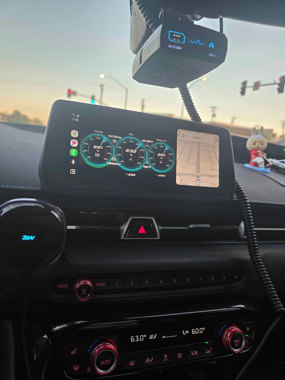

Some updates in regards to my experience with this box.(i did get the PRO version(more/better cooling fans), not sure if/how bad the cooling is on the reg one).i don't think i have any heating issues, it always just felt normal. no "hot to the touch".
-i've noticed some lags/hiccups/freeze whenever i get text/other app notifications. so i turned off some sound notifications from within the Ai box, its appears to run better/ smoother now.(also close any extra apps opened from the box android os,deleted apps that i have no use.)

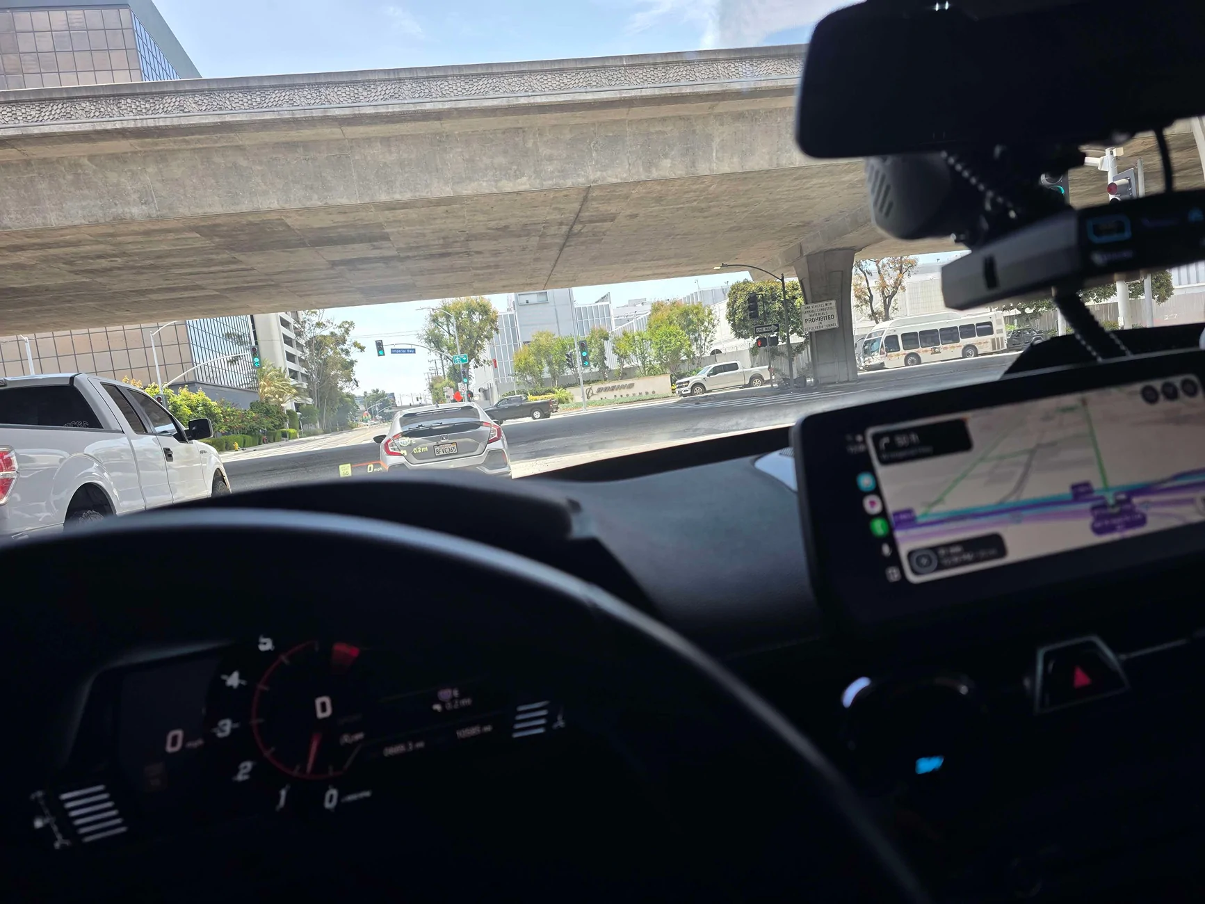

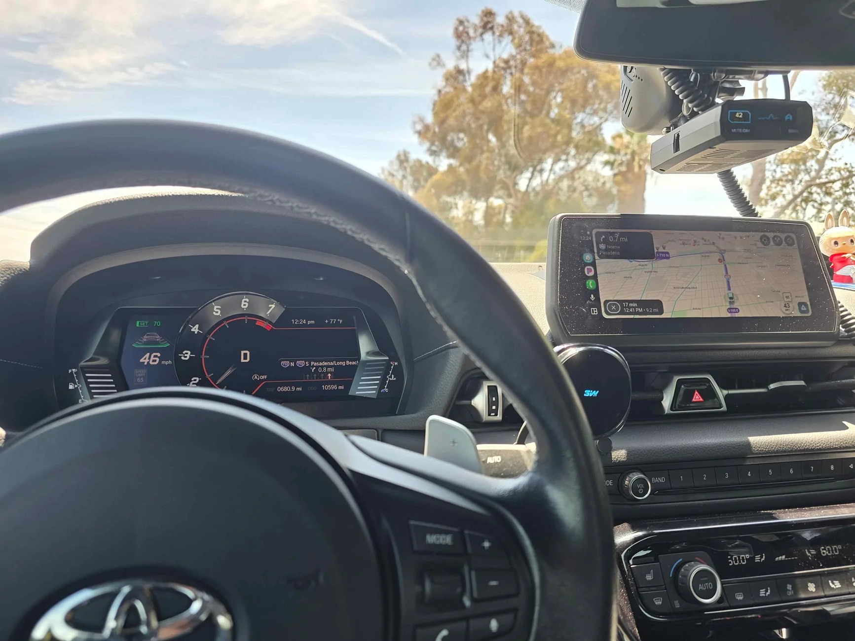

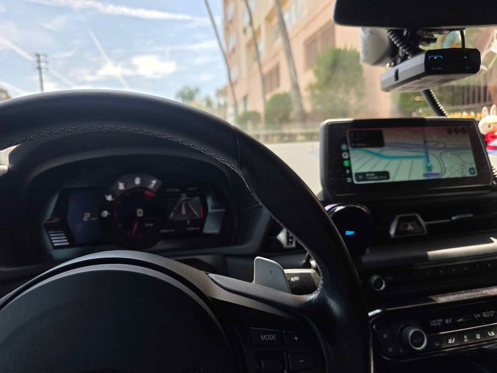

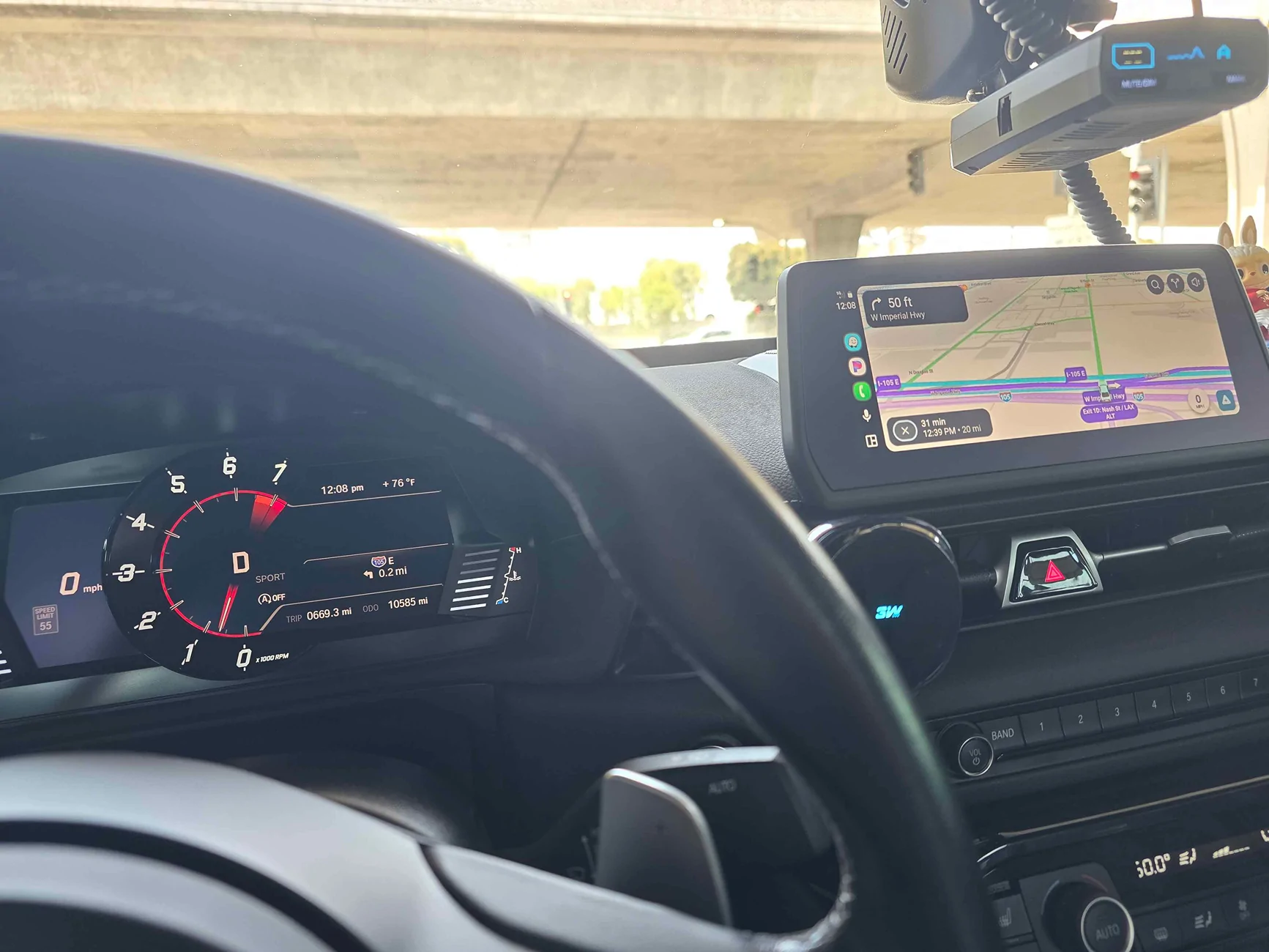

-HUD, i've seen a few people/reddit asking about this. guess this is a makeshift solution for those that want directions to appear on HUD(cluster included)+AA. I was able to run the in-car navigation along with AA( i was using Waze). However, obviously, the directions do not match up fully but they get you to the same destination so lol. you can mess with the route settings and what-not to your preference.[setup alternate routes/local vs highway?] In picture 4 if you zoom into the HUD display you can see the direction, sorry i wasnt able to snap a better pic to show that.

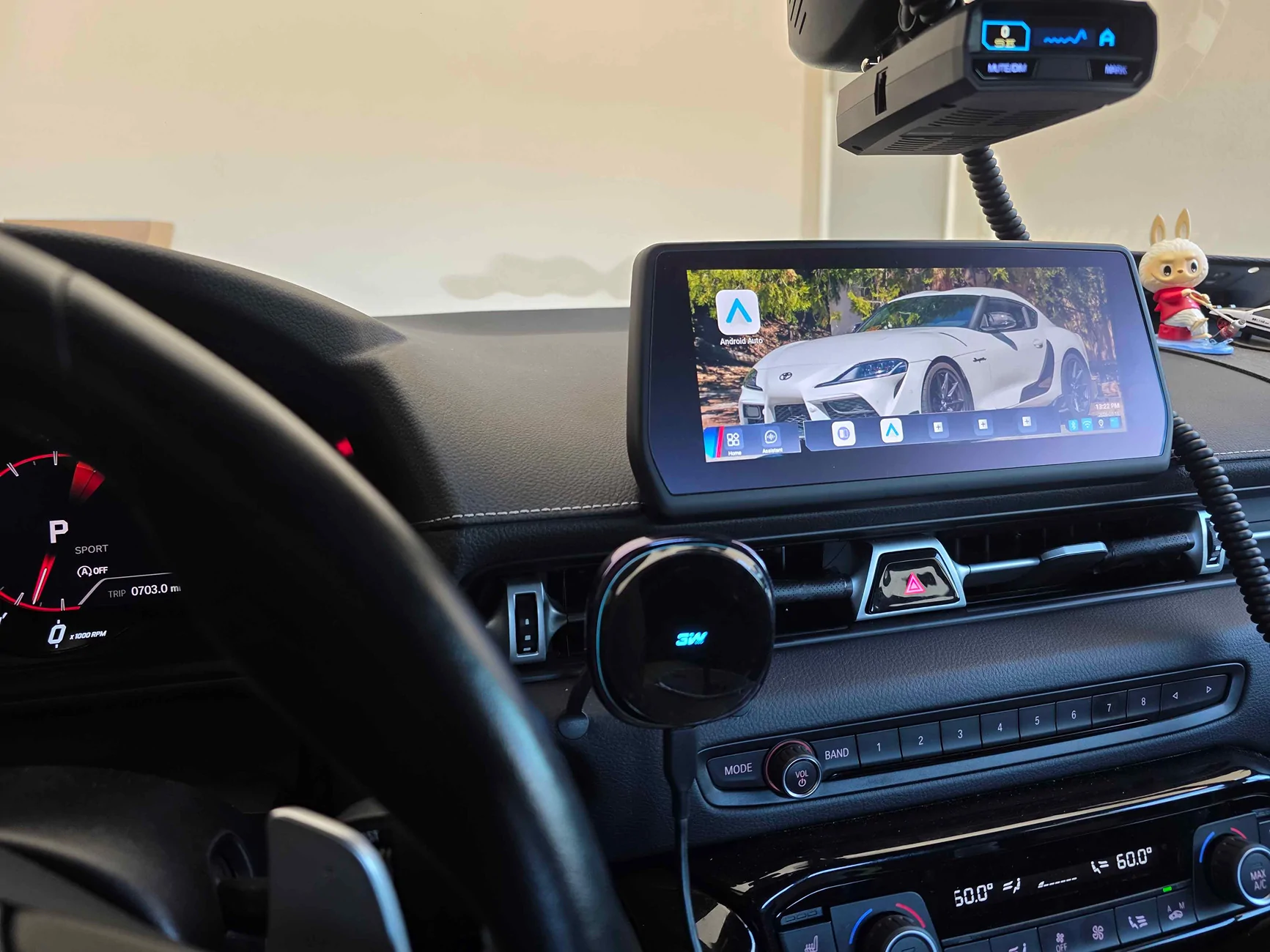

-Bonus, i was able to connect to the box bluetooth and use quickshare to transfer a pic of my car and set it as the "wallpaper" for shits n giggles.
