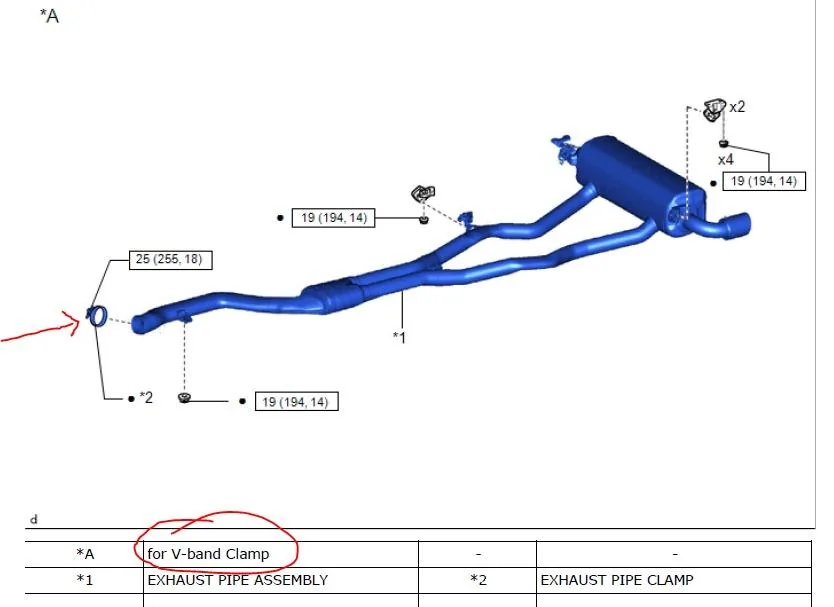

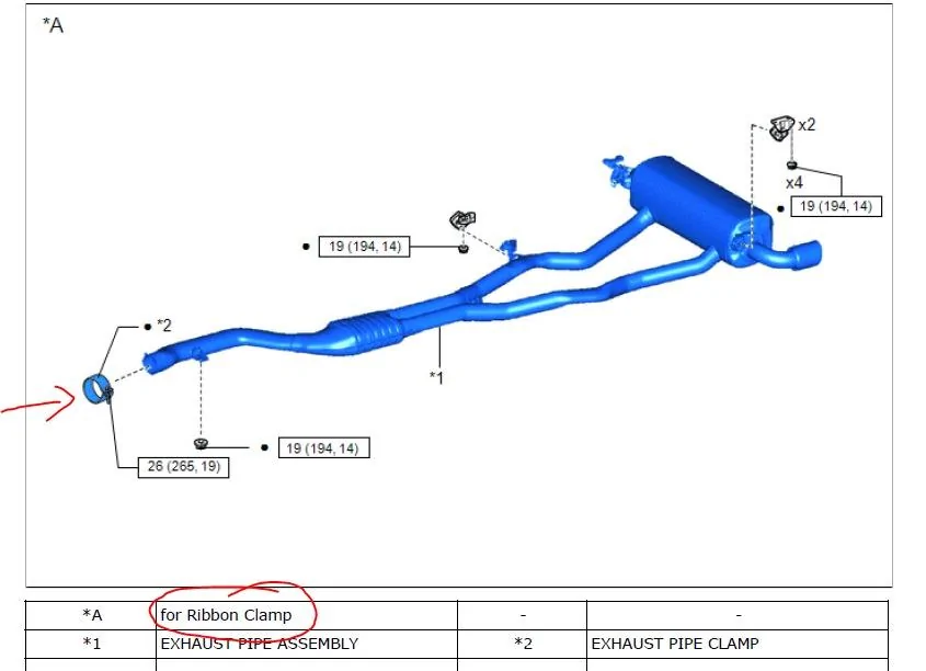

One thing to also consider is what style of connection your car has between the downpipe and the rest of the exhaust. For some reason some cars have just a regular bit of pipe with a ribbon clamp, and some have another V band at that end.
I think all EU cars that have the V band style (I'm in the UK and mine does) and all US cars have the ribbon clamp style, but I've no idea about other regions.
Ribbon clamp style:
V Band:

The AU version has the ribbon clamp.

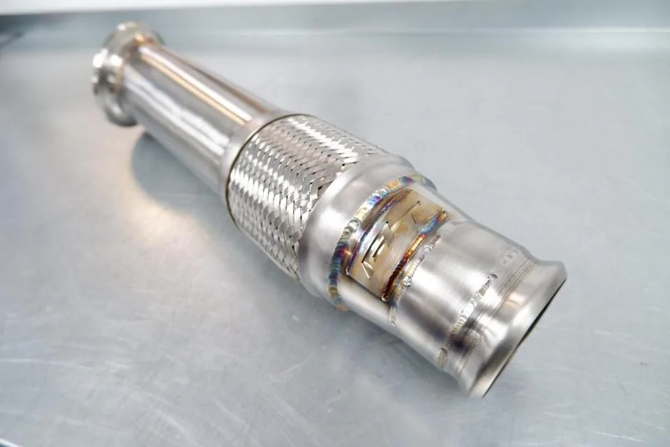

I envy you haha the V band on our EU ones isn't even just your average V band... its just some weird kind of bevel on the end of the pipe. Spoke to a shop here that has made a downpipe for this car and they said it was a pain to make. Not only could they not find an off the shelf part for the V band at the turbo end (had to get one custom made), they said the V band at the other end of the downpipe was also a pain and ended up doing it with a bead roller, until it broke the bead roller lol
