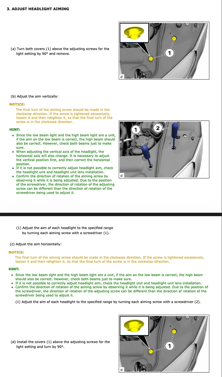

There are two white plastic screws on each of the headlights, IIRC vertical adjustment is exposed if you open the hood, and the horizontal adjustment is covered by a black plug which you need to open by using a coin.
Not sure about UK spec, but all US spec comes with the basic LED w/o corner light. You could adjust the center by using the white adjustment screws, but the pattern itself is not adjustable, looks like this for both sides:
