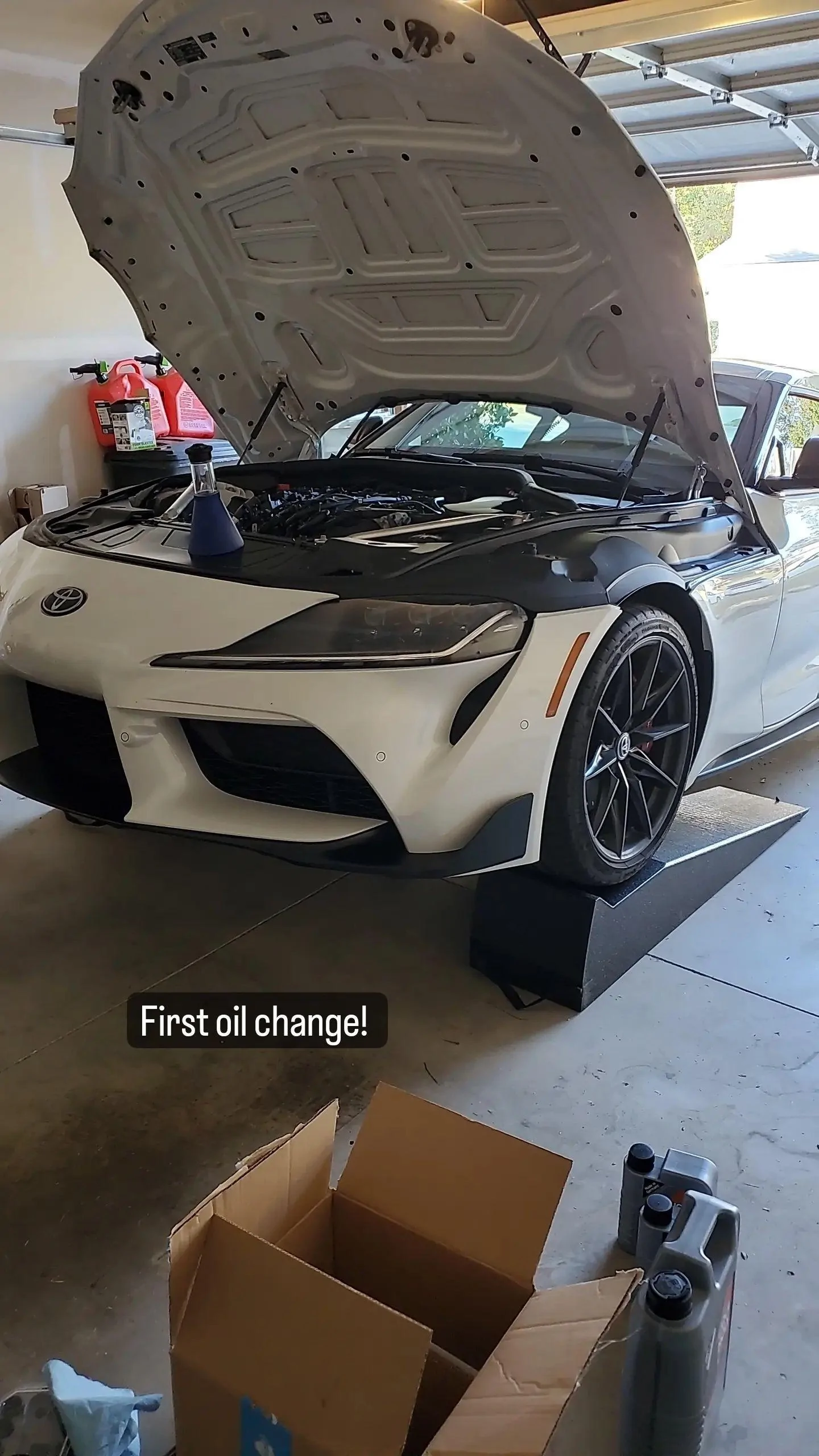

Hi all,
I don’t remember the exact post, but I seem to recall a member or two stating that rhino ramps were good to use at stock height for some diy maintenance work etc. I just picked up a pair from Walmart and there’s no way this car could get up that without removing the stock “splitter”, even at stock height. These were the smaller of the two options, at least I thought they were.
Anyone have any input or suggestions of other ramps that can still get the front up enough to do oil changes? I saw that Megan racing makes some low pro ones, but they only about raise the car about three inches or so. TIA.

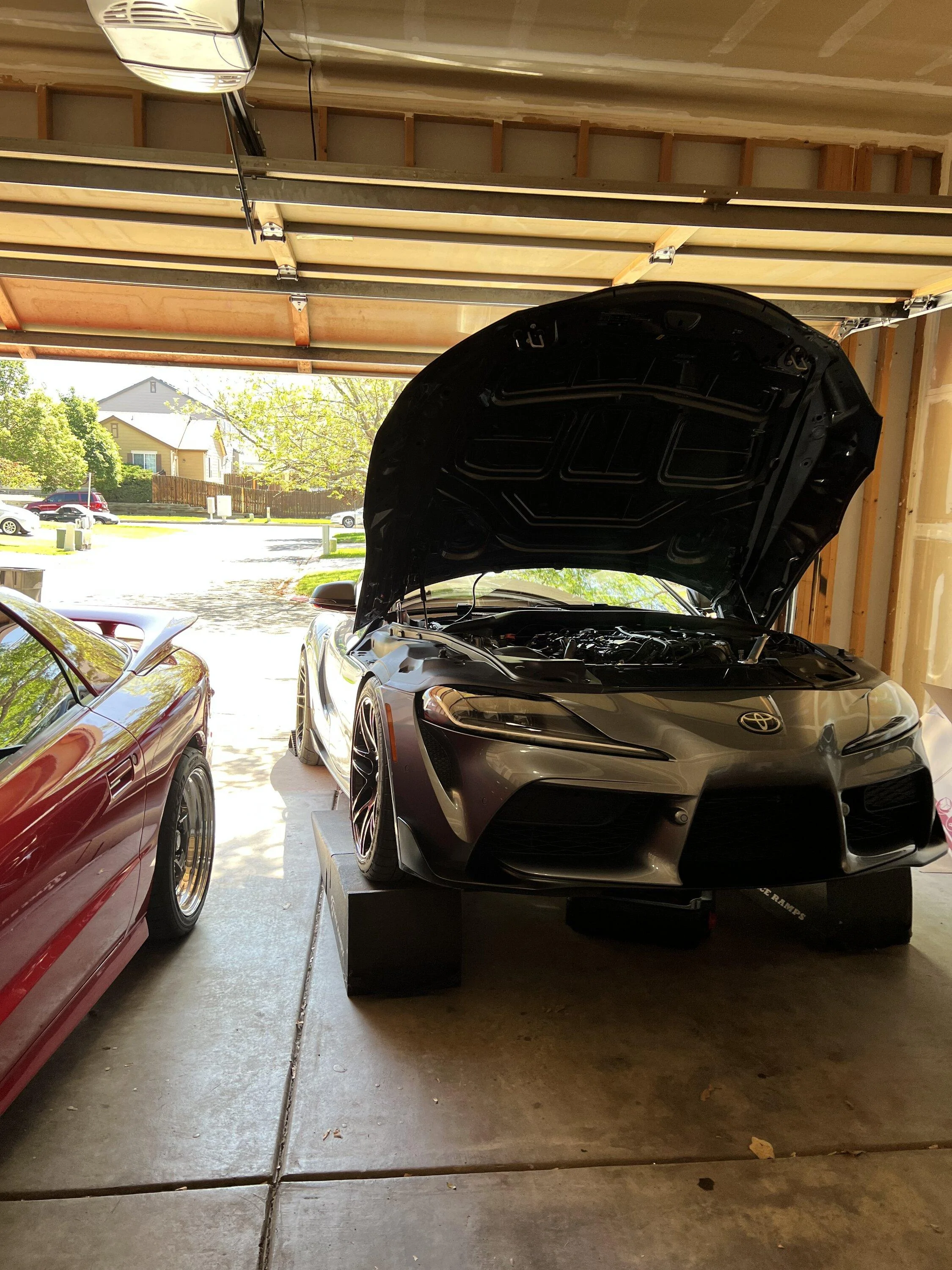

Lowered on H&R springs and i have no problem.
are you able to get under the car like you would with rhino ramps? How much you paid for these cuase i see these kind ramps for low profile cars selling for 500-600 dollars its outrageous to pay so much for ramps😭
Get under it just fine, do my oil changes with them. Not sure on price, bought these like 10 years ago. Might be some black friday deals out there still?

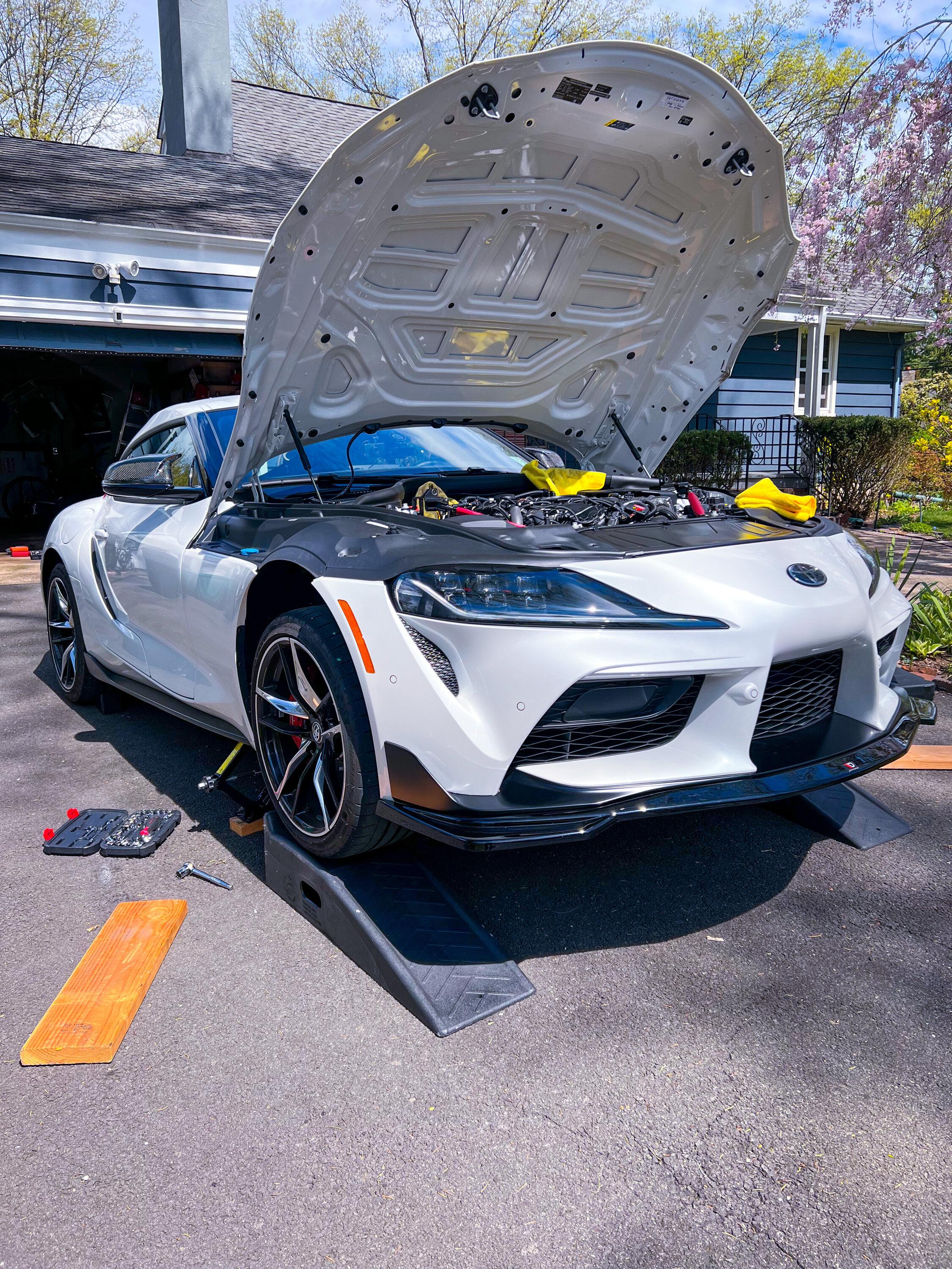

Used to have this issue on my lowered BMW. If you can't return them/need to get the work done, just drive the car on some 2x4s first and then onto the ramp

I just use wood and jacks and this is how I use my ramps. My car was not lowered at the time.

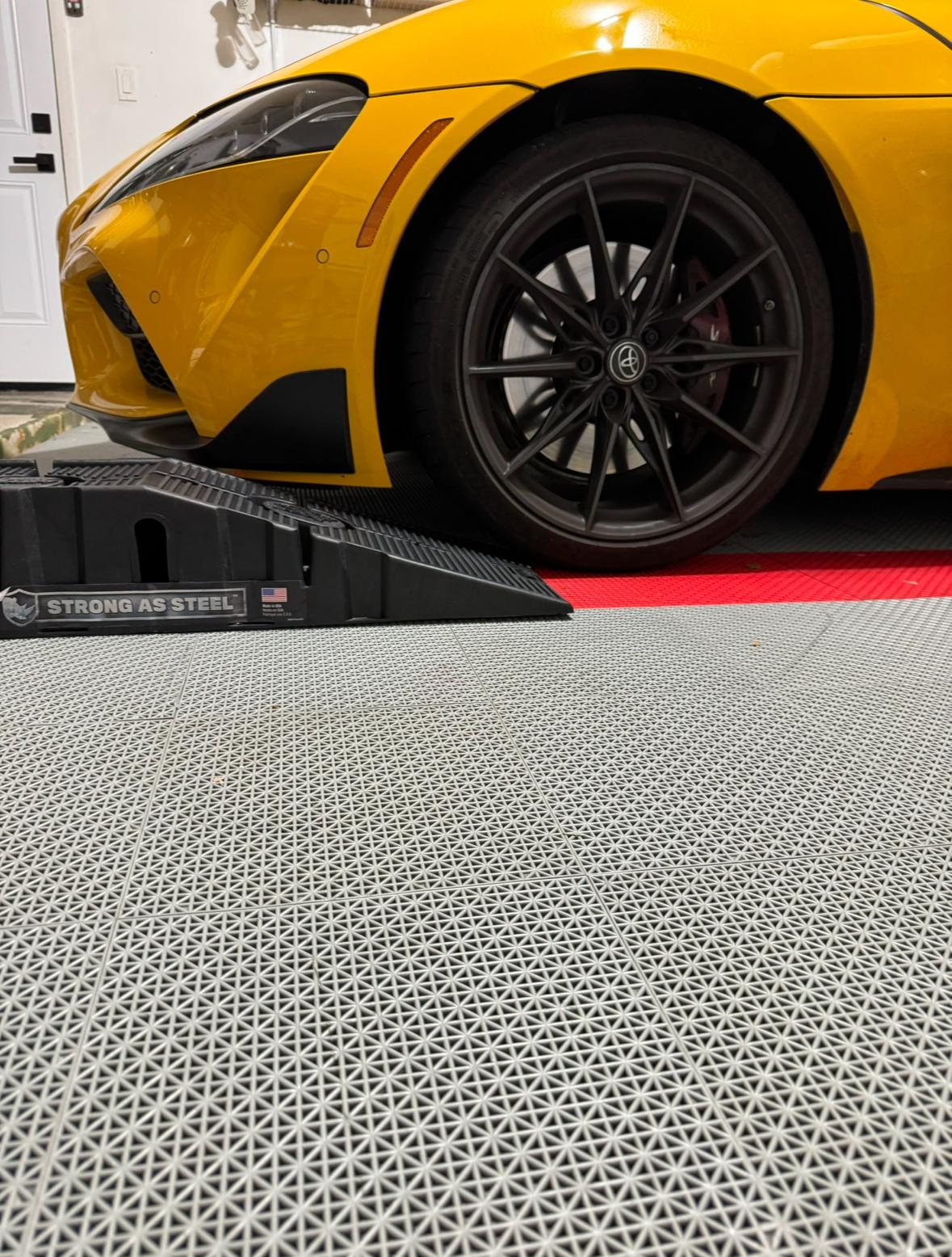

+1 for race ramps (56" model). BARELY enough clearance for stock height as you drive up (according to my wife) 😂
$340 shipped from Amazon - expensive, but the best you'll get. Look to be a little cheaper now too.

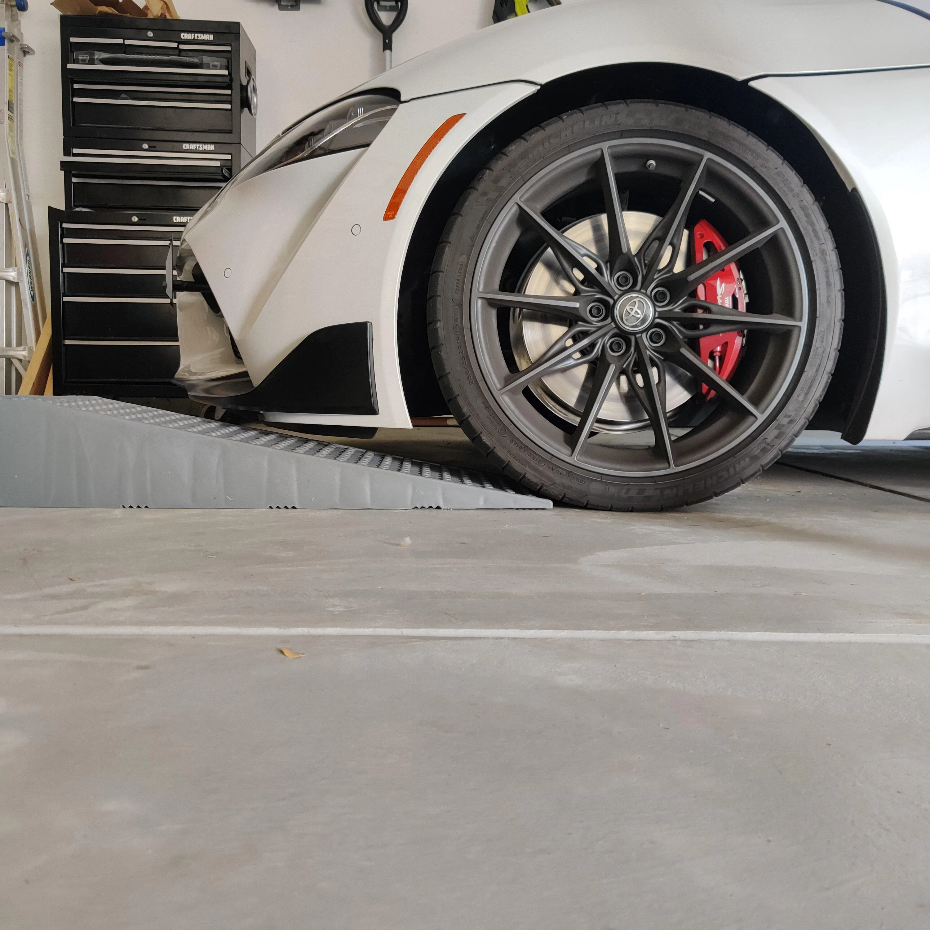

this one will barely clear (less than 1 finger width) with completely stock car. however, add a lip and/or coilovers and you are stuck. 6.6 inch lift, 47 inch total length.
https://www.amazon.com/gp/aw/d/B07NLJVZ2D?psc=1&ref=ppx_pop_mob_b_asin_title
BISupply Vehicle Service Ramp Set – 6.6in Car Lift, 5 Ton Heavy Duty Truck Ramps for Vehicle Maintenance, 2 Pack
Thank you. Yours seem to be gray whereas they’re black on the link, is it still the exact same specifications as the one you pictured?
That's the same exact listing I used, ordered about 2 months ago.
