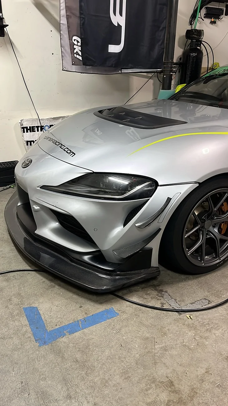

Hi everyone, longtime lurker at the forums here. Figured I'd crosspost this video here. For those of you curious about the new Ridgeline Motorsport A90 splitter, I put together a quick video. In short, the install is quite similar to the Racebred kit, but with a few slight differences.
I found the thread by starteri3igpete very helpful with the whole process. Make sure to remove those fender liners!

Since this kit doesnt have front tension rods (or cables, but we know those are useless), the angle is being held by bolt friction. I am almost certain it will slip after your first track day or highway driving.
I HIGHLY recommend just preemptively buying the ProAwe rod kit today. Unless you dont mind pulling the bumper and re-adjusting every few weeks.

I had a basic Verus splitter before this. I changed partially for aesthetics and also wanting something with splitter diffusers.

The kit does come with tension cables, however I’m not 100% satisfied with them. One was shorter than the other even when maxed out.
The kit does come with tension cables that mount underneath the headlight brackets, however I know those aren’t foolproof. I’d say it is very easy to achieve and hold 0 AOA with the kit. The chassis mount brackets are machined so the bolts can’t slip. In addition to this, the front of the splitter is connected to the lip via bolts. It’s kinda a double edged sword however, making it harder to get other than 0 AOA out of it.
Every kit has its compromises but it’s one I’m willing to live with for my application.
