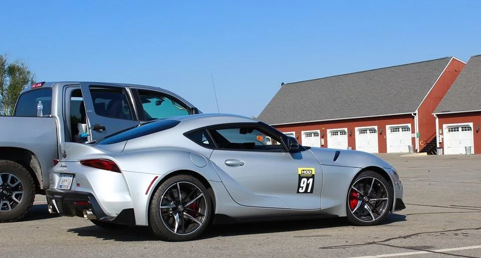

My car is a premium package bought new (for MSRP!) at the beginning of August from a local dealer. I have put 1200 miles first on street, and only changes are decent engine oil and high temp brake fluid.
I have done many track days over the years, but not so much recently with only 1 or 2 track days per year for a while now. This car just really begs to be driven on the track, so I decided to sign up for a “Hooked on Driving” event at Virginia International Raceway (VIR) last weekend running in group C (solo advanced).
I struggled to find much info about the car (thanks Jackie Ding for the single most comprehensive place for Supra track info!) so just decided to try the car nearly dead stock and see what works and what doesn’t.
First off, the car is an absolute joy to drive on the track
very well balanced and just fun to drive. Short gearing and great torque makes it easy to find a gear (or two) that suits every turn, and the car is easy to rotate in the slow turns, but surprisingly stable in the higher speed stuff.

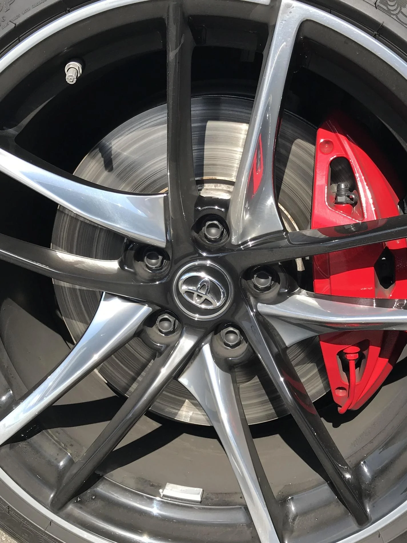

-brakes
.this is the only part of the car that wasn’t spectacular all weekend. For dead stock and street pads I really can’t complain, but the pedal is immediately long and mushy even before brakes are hot. They would stay pretty consistent with concerted efforts to baby them (letting off 2/3 way down each straight and floating speed into NASCAR (turn 3), South bend (turn 10) and use the hill as much as possible in turn 11 coming into Oak tree. Doing all of this I could run a whole 20-25 min session without overheating the brakes, but the pedal just felt really mushy all weekend. Doing a full lap on Jackie Ding kill mode would immediately put the pads to a temp they started smearing pad material on the rotor, and the pedal would drop to what felt like the floor in the hard braking zones. Not confidence inspiring. Fluid (Motul 600) never boiled so that was good. The good news is that with just a few street miles this week, the pads and rotors are back to feeling and looking about like they did when I bought the car
.rotors are still grooved a bit, but smeared pad material is gone and brakes pedal feel is normal. Doesn’t seem to have suffered any massive pad taper like some of my previous cars.
I was kicking myself all weekend for not buying the only track ready brake pads I could find for this platform and installing them before the event https://www.counterspacegarage.com/blog/brakes/brake-pads-for-2020-toyota-supra-gr/, as I am sure that would have gone a long way to allowing me to do some full laps with “normal” breaking.
