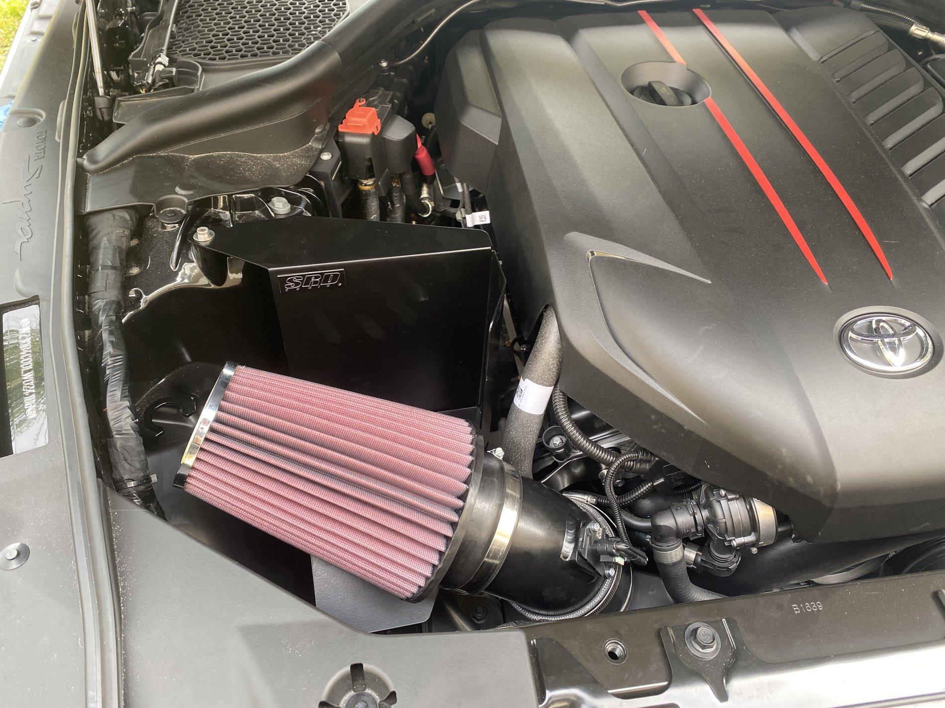

Here is link to SRD Intake.

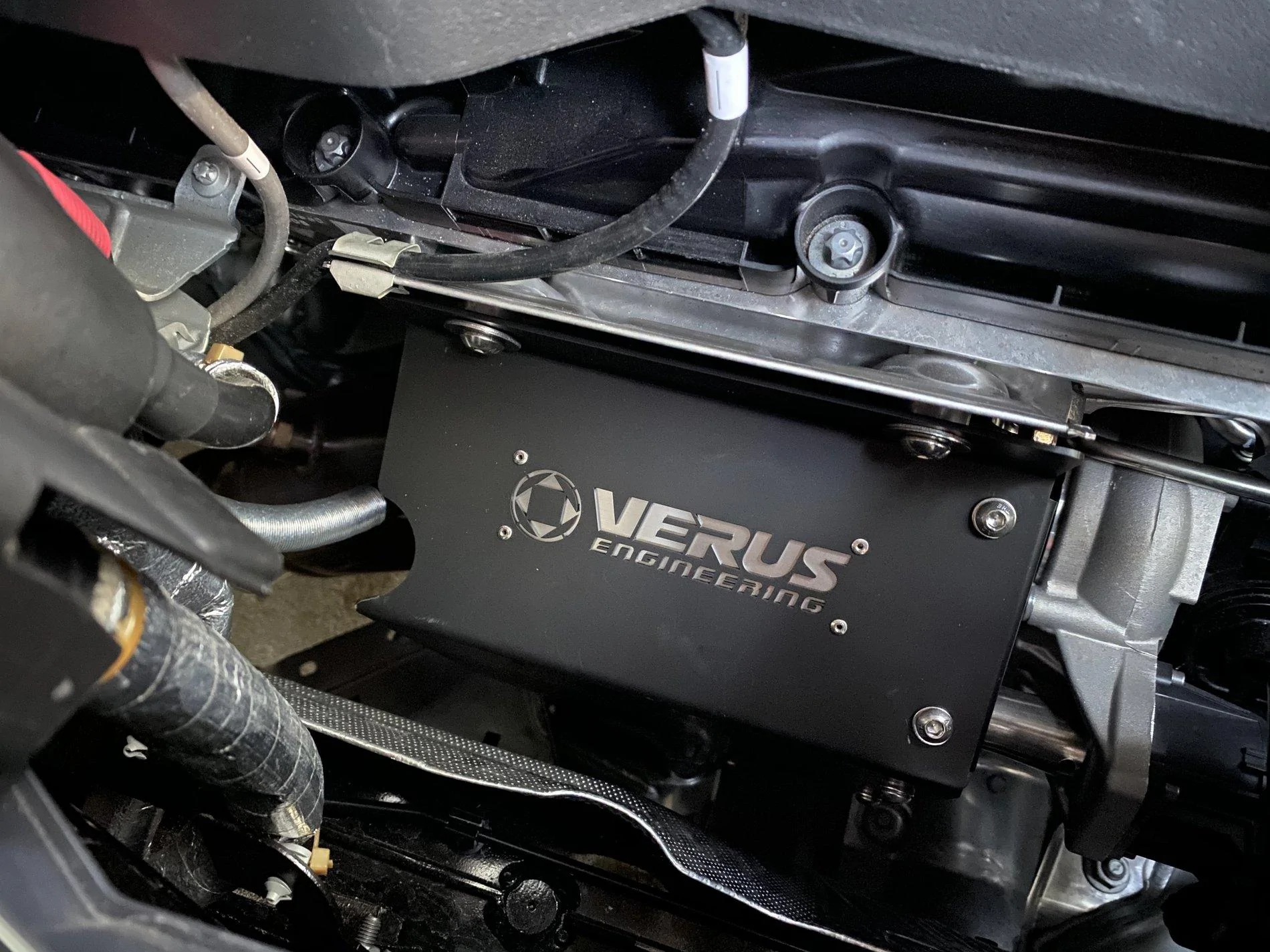

Here is link to Verus Heatshield, I sent this data to them as well.
Here is SRD Intake installed:
Here is the Verus Heatshield installed:

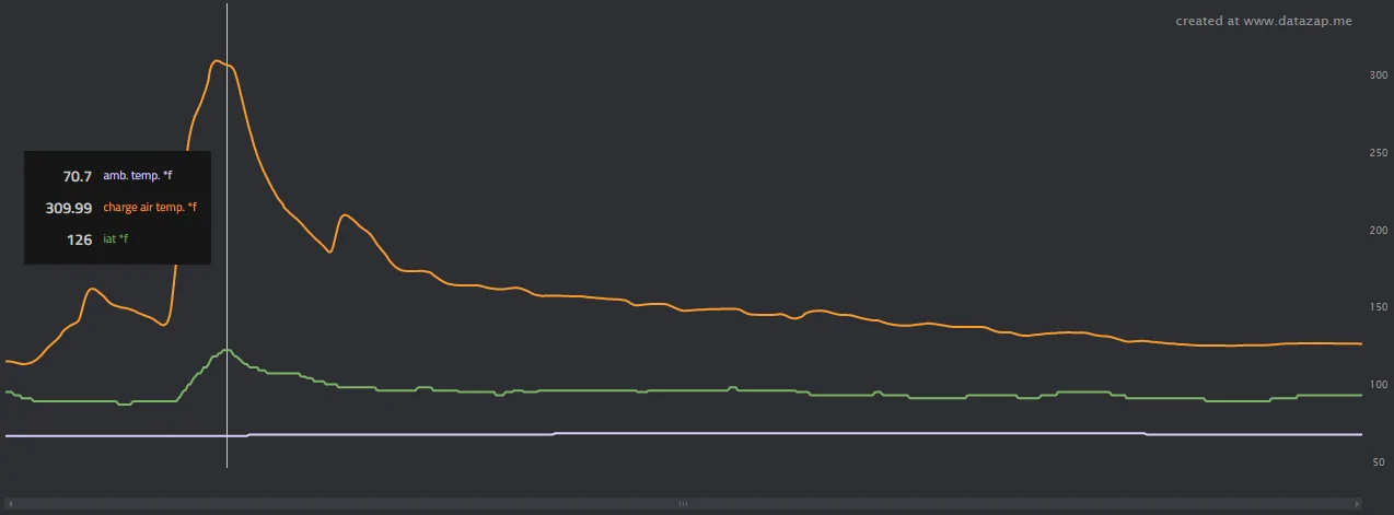

First I logged with stock airbox. Here is link to whole log, go to third/last log - this was taken on the highway. I attached ambient temps as well. Peak charge temps-312*. Peak IAT 126*.
See below:

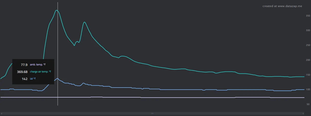

Then I installed the SRD Intake and did a pull as well. Of course ambient temps rose a bit but still huge difference/rise. Here is a link to the log, go to third/last log - also taken on highway. Peak charge temp-370*. Peak IAT-142*.
See below:

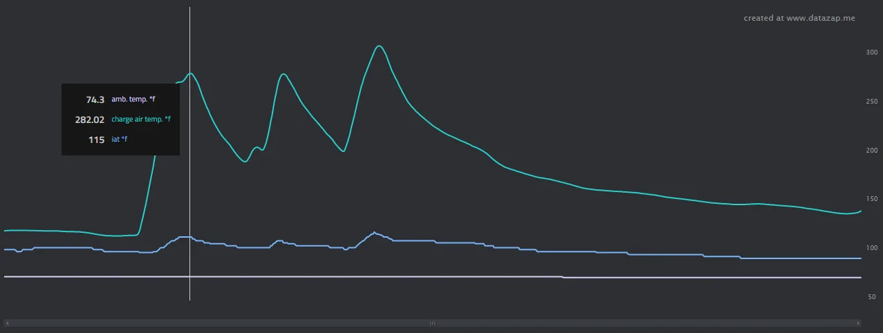

Lastly, a few days later I installed the Verus Heatshield on turbo. Install was very easy. Here is a link to the log, only made one so the one it loads is correct. Peak charge temp-282*. Peak IAT-115*.
See below:

This is great info. I just ordered a Verus shield. I hadn't really paid attention till now but with the Injen intake installed the turbo is completely visible and naked looking. There appears to be ample room for the Verus.
