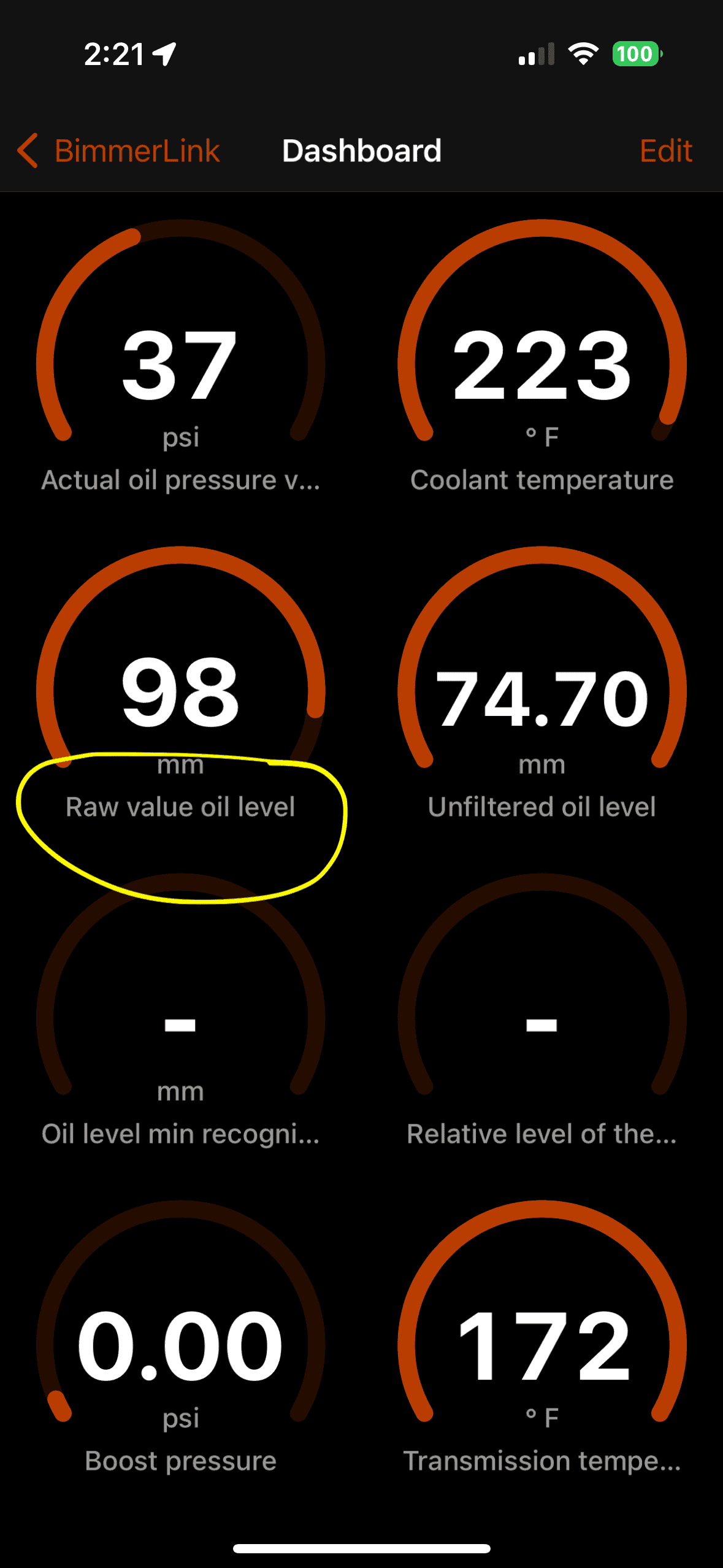

If you are checking via iDrive, then how do you know?
If you check via Bimmerlink then you will know the exact measurement down to the MM.
Handy guide:
- 100% (6.6 liters) = 97mm
- 100% (iDrive max) = 97-85mm
- 75% = 84mm
- 50% = 82mm
- 25% = 81mm
- 0% (iDrive min) = 78mm (add 1 quart)
Notice there is a HUGE resolution nerf between 97-85mm. iDrive will say max but your oil level is down almost 12mm.
