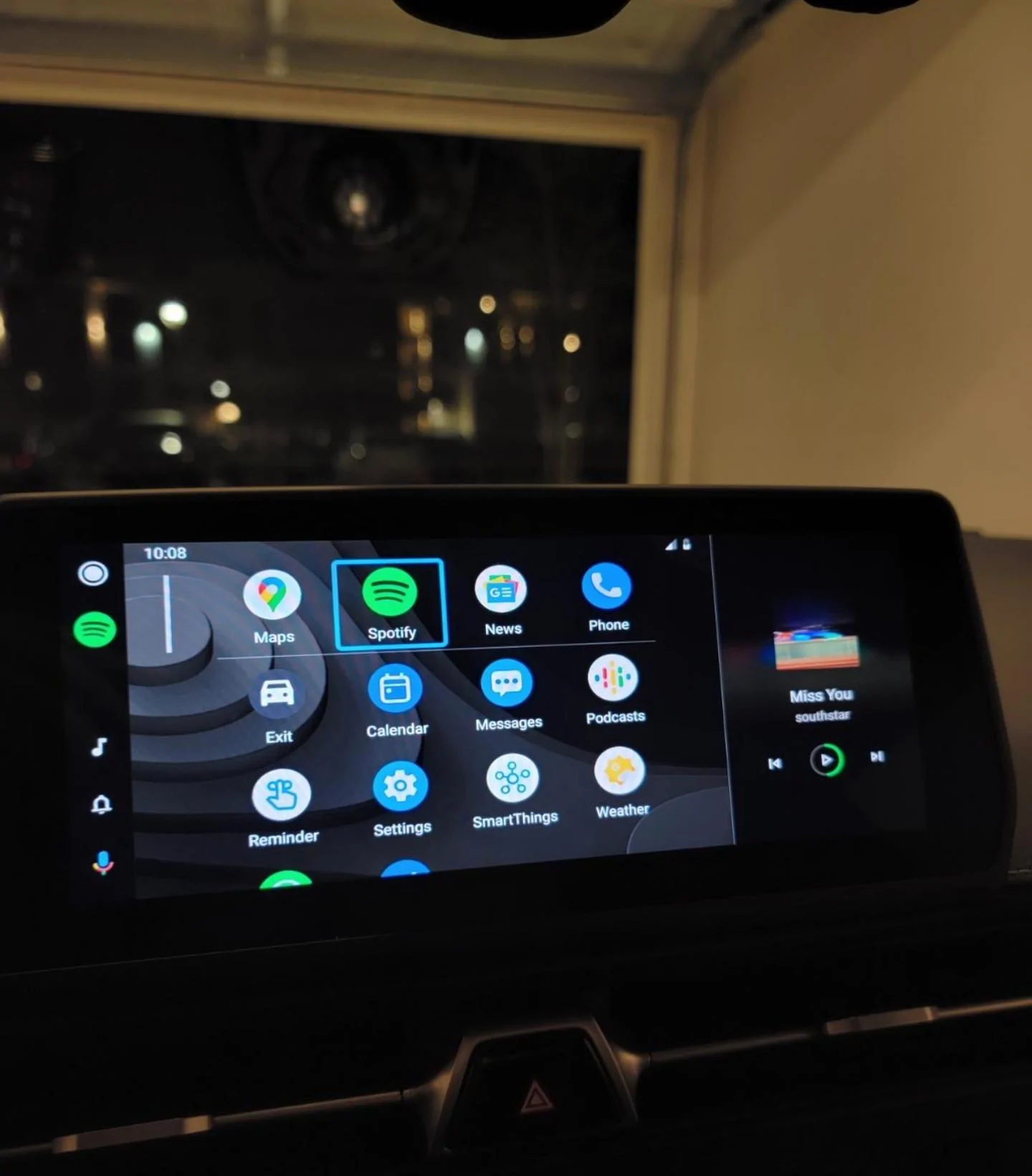

@YellowJackit Just installed and have the same issue
It looks a bit weird, but I honestly miss android auto so much that I'll probably get over it quick.
Did the manufacturer change last minute for blackfriday?
This his how the home screen looks like for reference:

Good to know. I'll let it ride until it's time to behind the dash again. My screen is exactly the same. Looks really bad with YouTube playing!
I bought mine back in September, so I'm not sure about a potential change. I can chill on the troubleshooting now that I know I'm not alone.

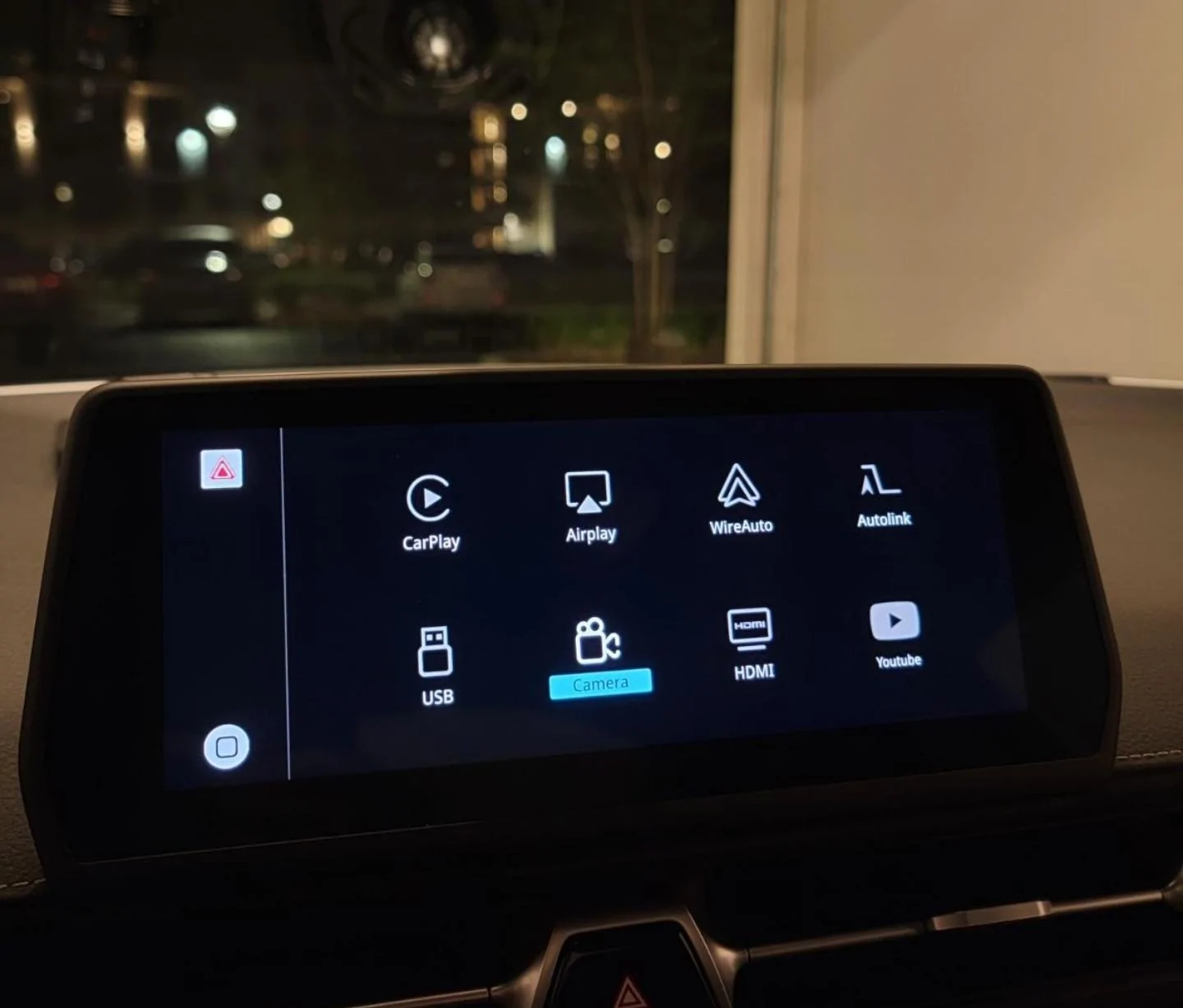

So unfortunately my happiness didn't last long. I was parked using AA when suddenly it crapped out and doesn't work anymore. Gonna have to remove everything again and check it out...
It connects to my phone, but when I activate the MMI, the screen goes black
That looks good and the split screen is what you should expect on that size screen. The only thing off is the screen elements are slightly too small which is why the fourth row of icons is cutoff.

@muniz_ri So for some reason, the screen blacks out if I use wired android auto only. I have no idea why that happens. I have to either disconnect the battery, or wait the 15 for the car to fully power off, for it to reset and let me use the MMI

My guess is bad firmware or mcu. I would contact the seller and see if they can provide updated firmware.

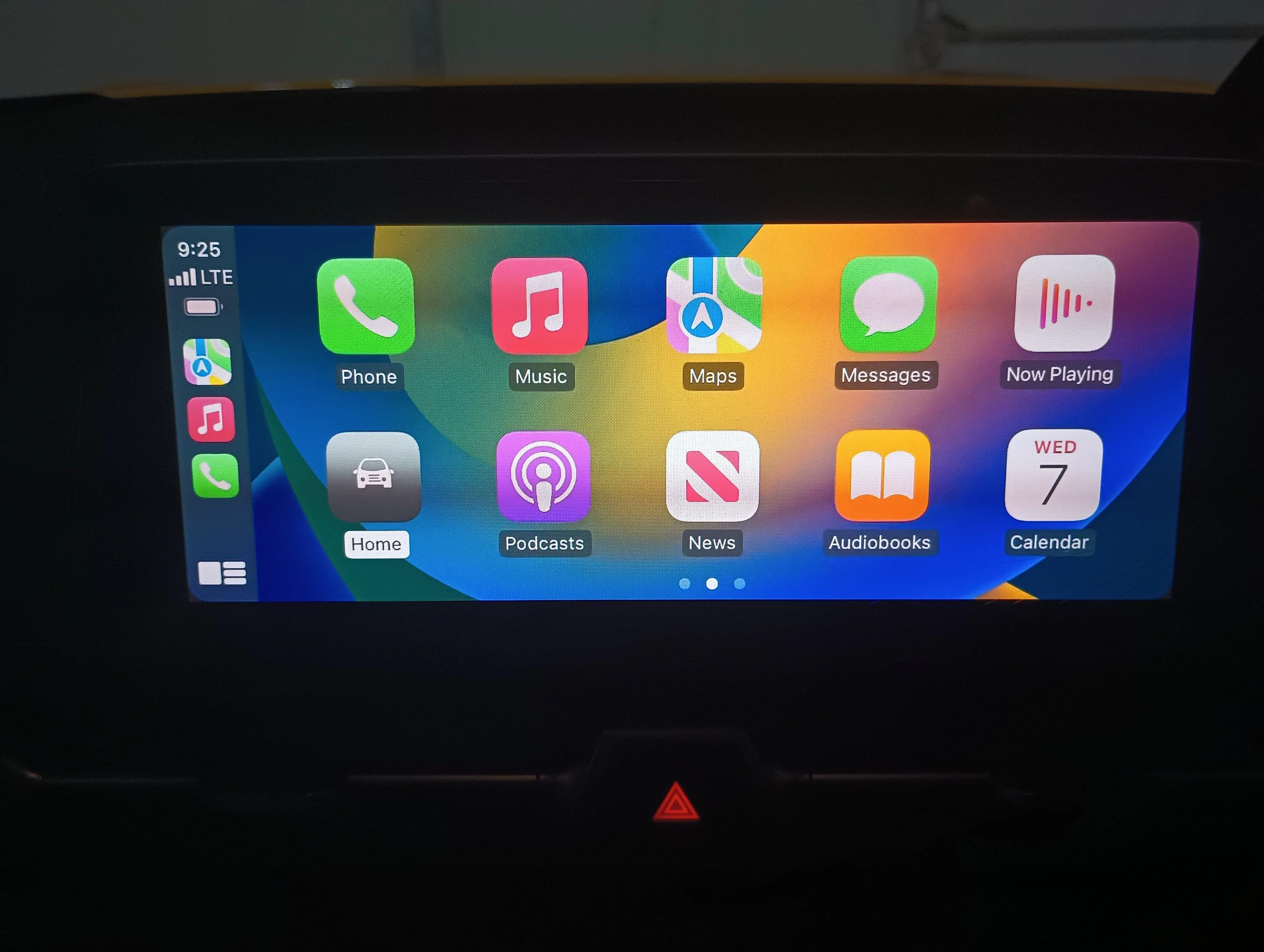

I just got mine, anyone here using this unit with CarPlay instead of Android Auto? I'll give the install a crack but want to know if I'll need to code or anything, following this thread it's not entirely clear about coding, is it really just plug n play?

@calmeda1 I have the base, doesnā€™t have CarPlayā€¦Iā€™ll give it a go tomorrow. I guess Iā€™ll update for any other Apple guys out thereā€¦

Should be good to go. I just looked at the wireless CP in my car (22 Premium). Works great and looks like the OEM display. No coding was required. Took a while for the initial connection. This confirms my suspicion that something is off with my AA settings or the firmware. Had my old iPhone laying around.
