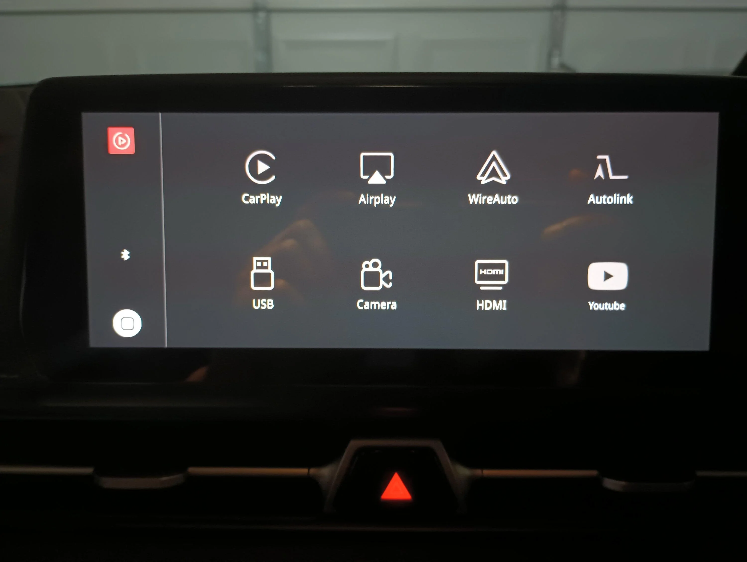

What android do you have? I have the Galaxy S21 Ultra and I read there's some unsolved issues with the AA on this phone
Any phone I connect displays out of whack. I have tried galaxy S10....Google Pixel 6 and 7. They all work fine in the other vehicles.

No sound, nothing happens when I touch the screen??

Garbage, cheap product I’m sending it back and pouting in the corner 😡
I have no issues with the sound quality when it works. My issue is the display...and more recently, it takes over iDrive and won't let go. Mine will be coming out the next time I need to get behind the dash.

Hold the menu key on the center console.

Familiar with that process. Mine won't give control back without a shift to reverse.
Thinking of ripping mine out and returning it too.
Discovered to exit if the long press menu isnt working, you need exit to the black/white interface (disconnect AA) then scroll to exit and press down on right button on the steering wheel to select.
Being unable to switch back and forth between idrive quickly, breaks it for me.
If it didnt lockout, I'd probably keep it.
