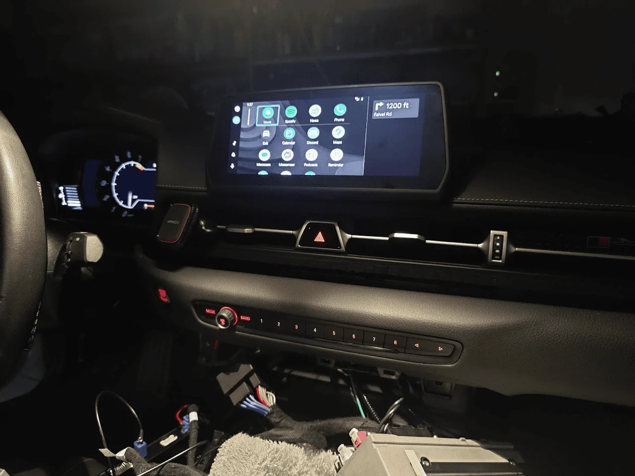

Welp, I'm middle of installing mine.
Got to the stage of testing.
The normal infotainment works.
When I switch to the box with long pressing the menu button, it is completely blank but the screen is on.
Can anyone help? Maybe the box I got is broken.
Android auto launches and connects to my phone.

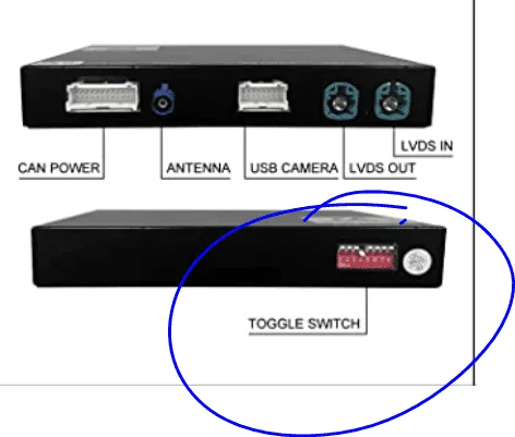

Tested with the dipswitches:
1-3: blank; 1-4: blank;
Nevermind got it work, needed a power cycle after picking 1-3.
Still have to code in AUX to get the audio working.

Yes, it's the dip switches. They need to be set appropriately:
1 ON, 2 ON, rest OFF = 6.5" screen
1 ON, 2 ON, 3 ON, rest OFF = 8.8"/10.25" screen

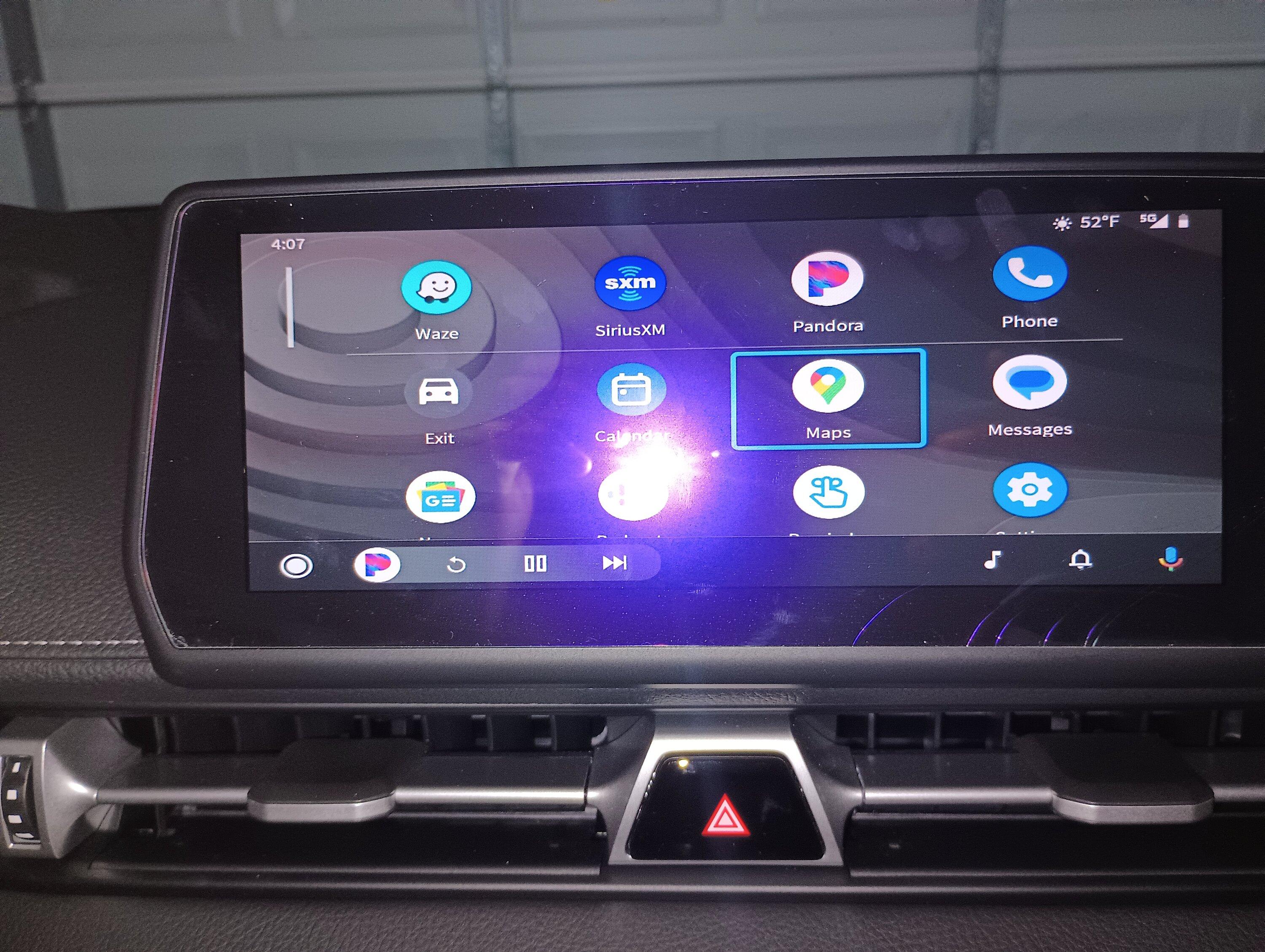

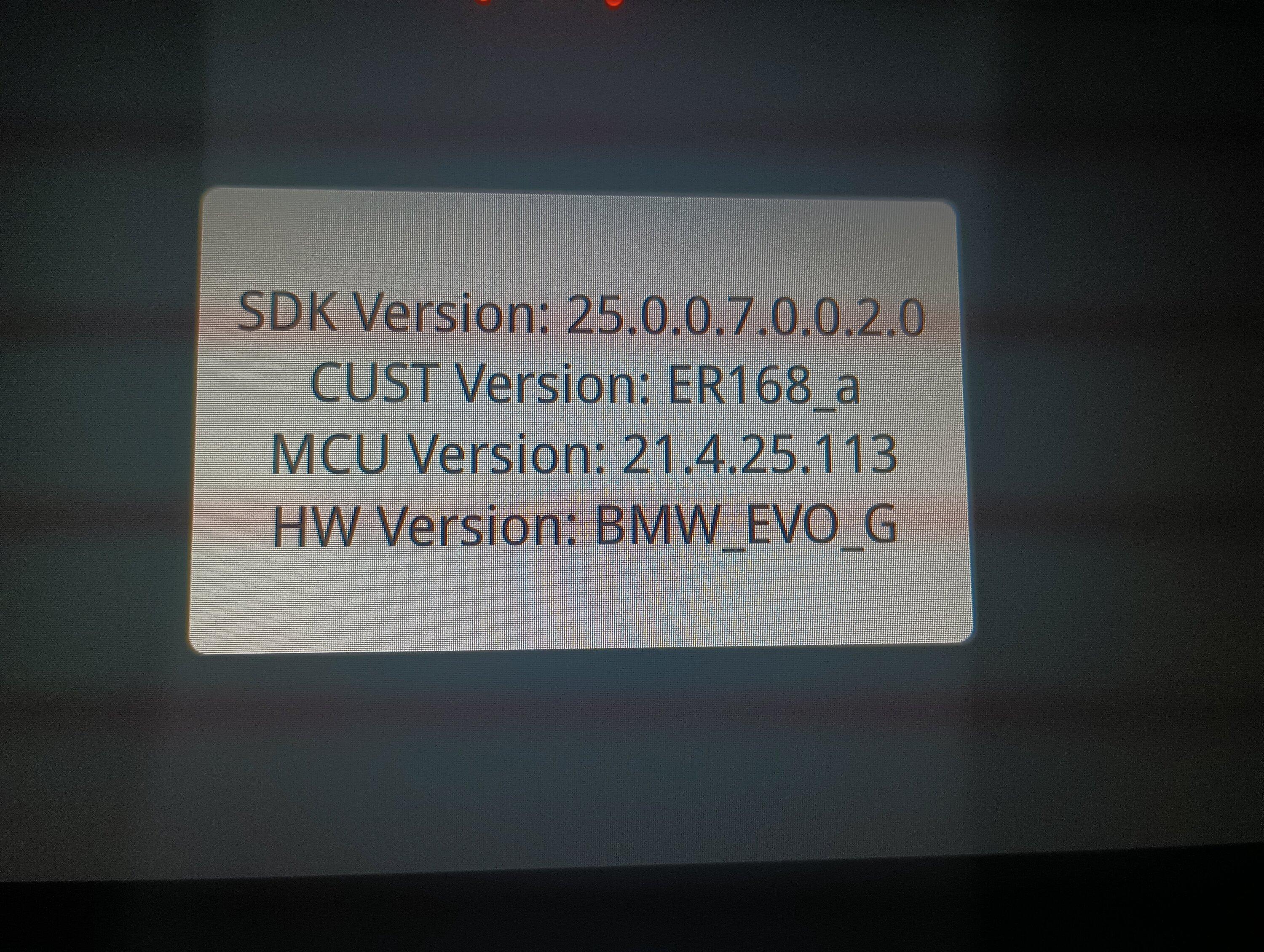

Interesting that it appears stretched. It sounds like the mmi's software may be outdated. Can you post a picture? Also, which software version came with your unit?

Here's my current firmware. I'll try to get a screenshot tomorrow.
FYI, this is RoadTop....the "MMI alternative".
The only RoadTop fw version that I was able to find online was version ER162. But I examined it and the settings would result in very small Android Auto icons and screen elements which may be what you are referring to as "stretched." But curious to see your screen pic when you get a chance to post one.

I think I may simply be wanting more than I should. My nephew looked at it and didn't have any complaints. It's definitely not as smooth as the CarPlay display.
That does look off. The icons are the correct size but with the 8" screen you should have a split view like this:
