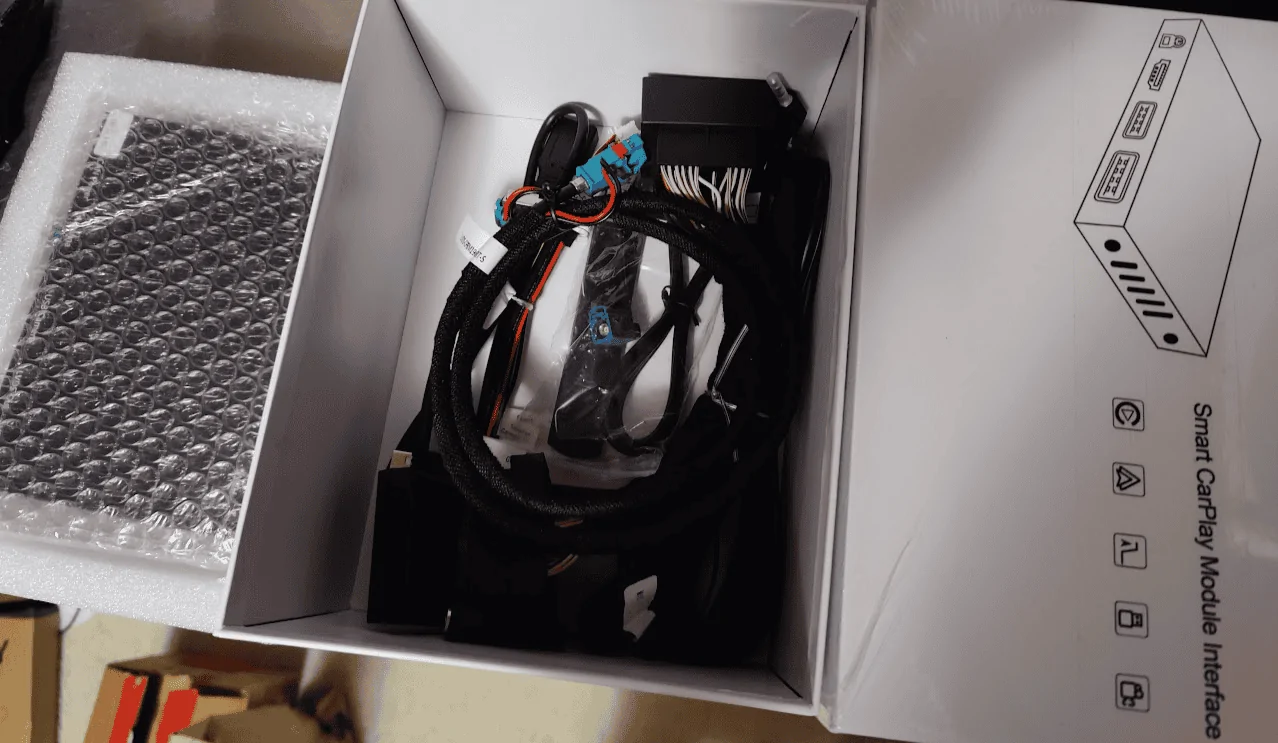

So I installed android auto & apple car play on my 2.0 ltr 2021 supra

Is there a step by step instruction on how to install it in a Supra? I don't really wanna break stuff trying to figure it out myself lol
Probably real similar to the Bimmertech one

Get mine installed. It works, but I need to find out how to tweak the resolution. It appears stretched a bit too much for my taste

This is just a wild guess, but at least with the Bimmertech box, there are some DIP switches on the back of the MMI box that are supposed to be set depending on what size your infotainment screen is. Maybe they are set for the smaller screen instead of the larger screen that is on the 3.0 Premium? You would have to remove everything to get back to the MMI box though.
Will give this a shot. I can take it apart pretty quickly now.

Yes, it's the dip switches. They need to be set appropriately:
1 ON, 2 ON, rest OFF = 6.5" screen
1 ON, 2 ON, 3 ON, rest OFF = 8.8"/10.25" screen
