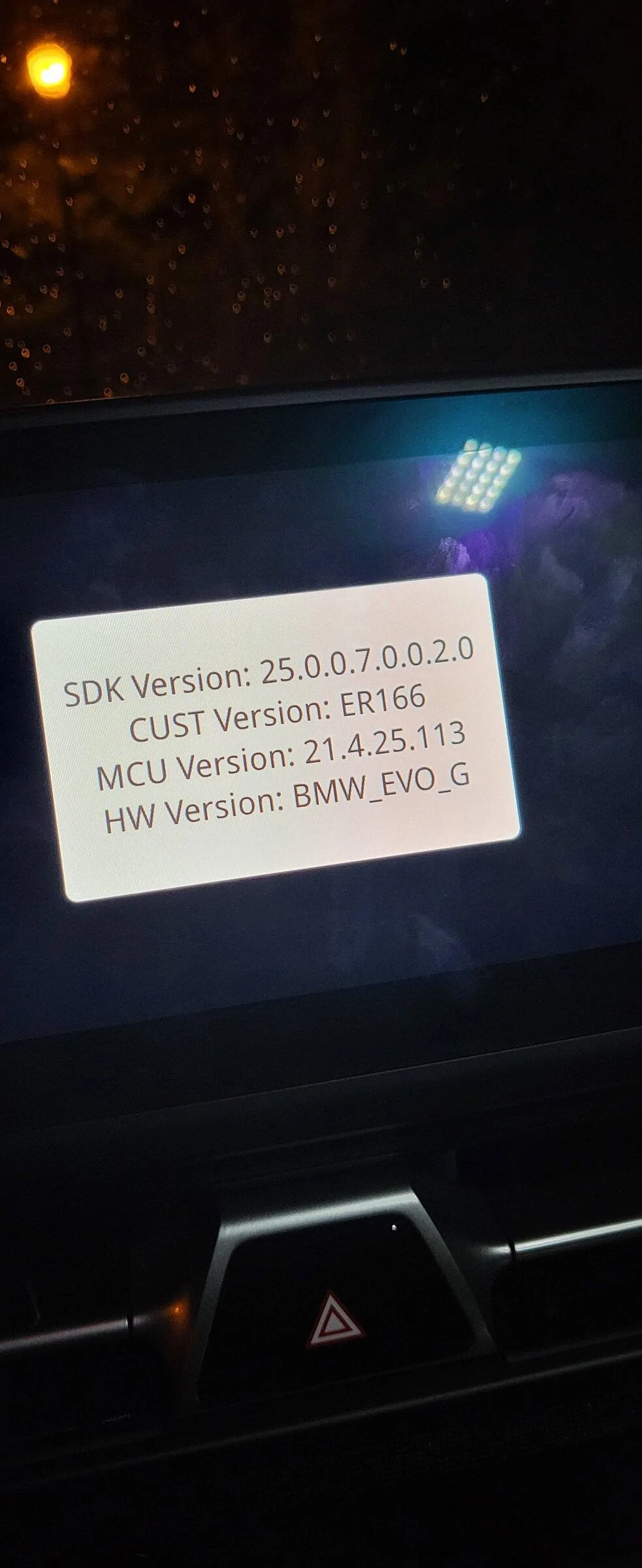

Hey I have the same unit, what software/firmware version are you on?
Faceliss
Joseph
Jul 29, 2021
Ohio > DMV
2019 Honda Insight Touring, 2011 Honda CRZ EX
hey there, no I didn't update mine at all. It's working just fine and I've learned from the past not to fck with something that works.

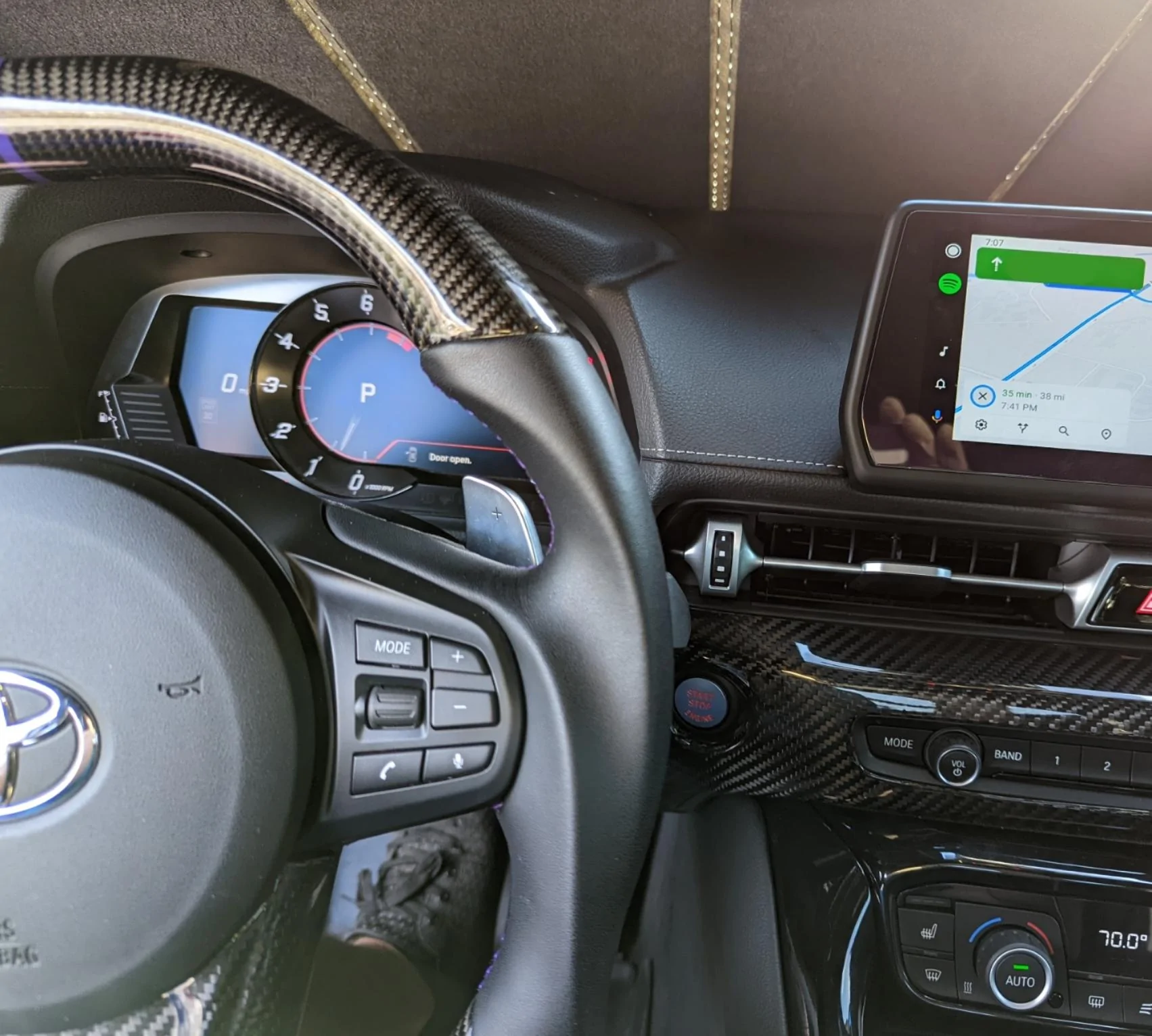

To anyone who comes by this thread in the future:
I just finished installing the ROAD TOP brand MMI unit for EVO SYSTEM cars.
You can use the Bimmerlink MMI Prime installation video to install this unit. It's exactly the same process. Shit, it feels like they're the same unit with a different paint job lol. This is TOTALLY PLUG AND PLAY.
No soldering. Not one single wire that doesn't go to the head unit or screen. Everything fits in the center console.
Yeah, plug and play Android Auto for 300 bucks plus trim tools and a T20 Torx.
Took about 2 hours. Hold MENU key for 3 seconds to enable Android Auto. Must code AUX support into the head unit with Bimmercode.
