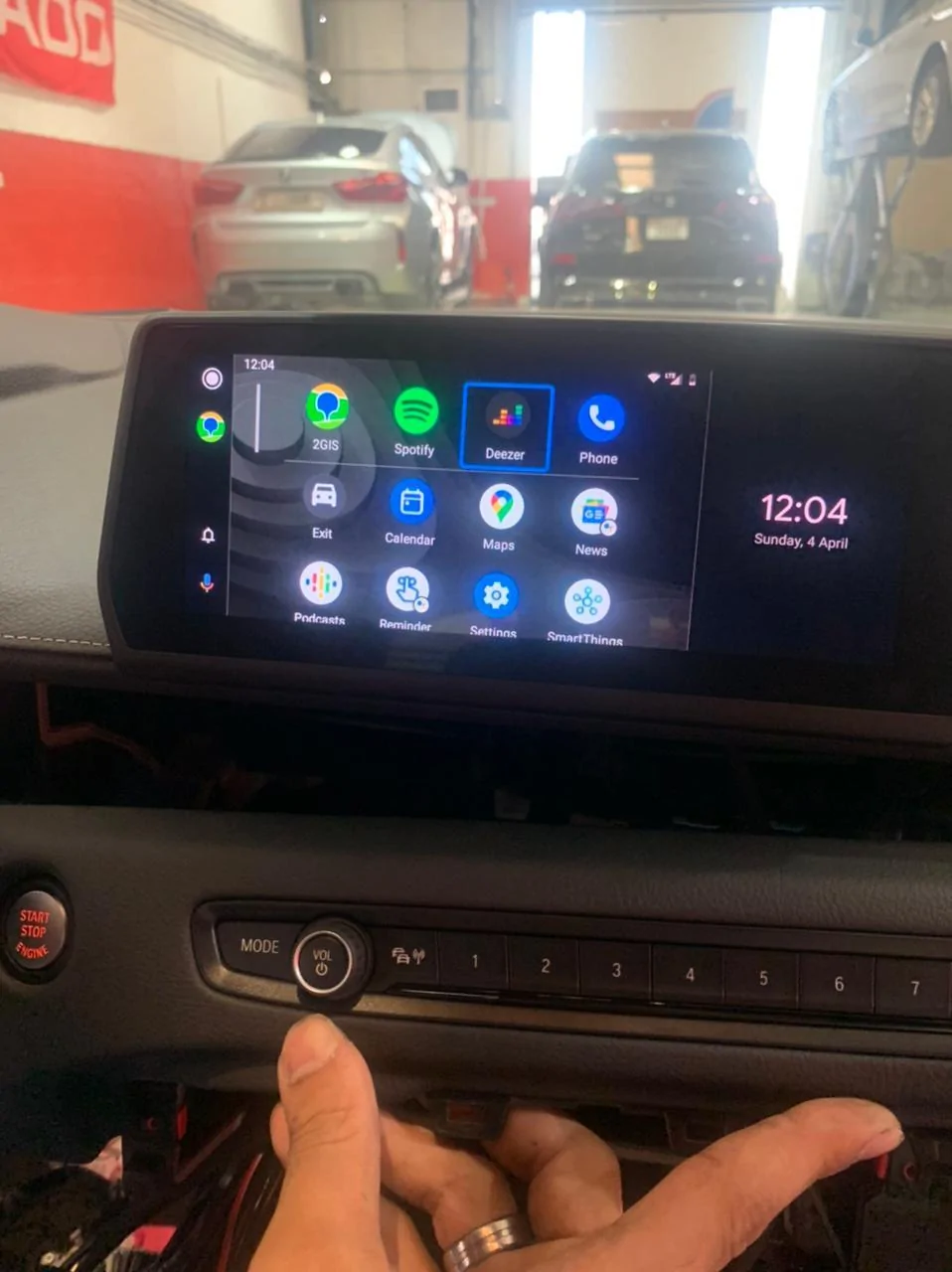

as you all know, supra does not have apple car play or android auto in some models and isnt planning to bring in android auto anytime soon, so i found a company called bimmertech and they usually have suppliers in most regions and they offer these devices that are usually installed behind the infotainment panel and it cost me a total of 800$ and now i have screen mirroring, apple carplay, and android auto both wired and wireless, they added a usb port in the glovebox for wired usage and they added an antenna for the wireless android auto/car play. now i feel my car is complete. im in Dubai so i went to a place called Car Code Performance which was listed on https://www.bimmer-tech.net/page-installers which basically shows you their agents or garages that heavily work with bimmer-tech. i hope everyone gets this stuff coz toyota aint gonna bother if its not gonna make them (enough) money, they have just released this like a week ago btw

Awesome man, my question is can you go widescreen? I'd love to take up the full screen instead of leaving that little part on the side. Might be an android auto thing though.
for android auto it does not go full screen, however mirroring your phone is in full screen

Hey do you have more pictures on how they installed it? Or pictures that you took during installation? Thanks.
The software can likely be modified to display in widescreen by adjusting the dpi setting.
