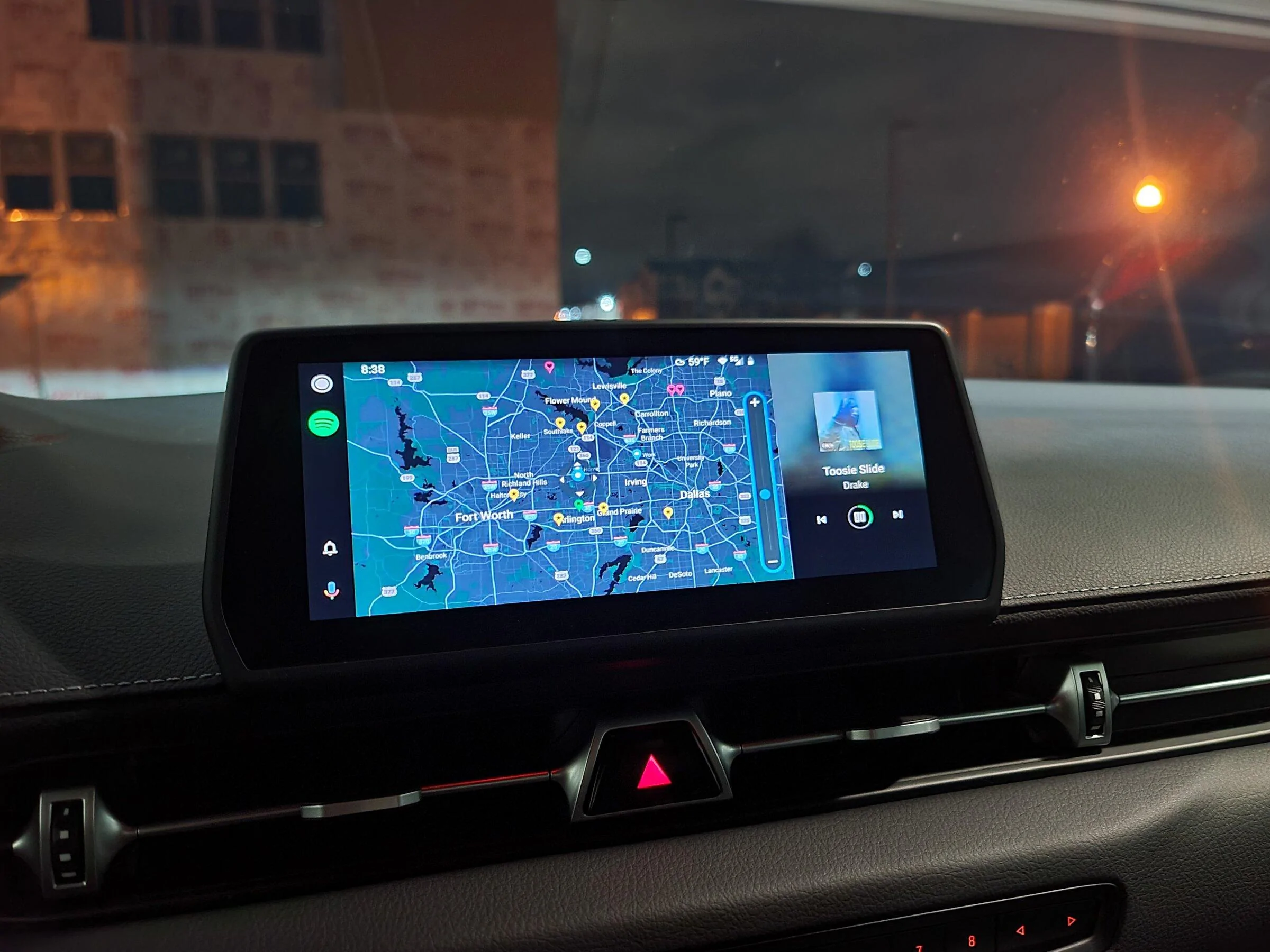

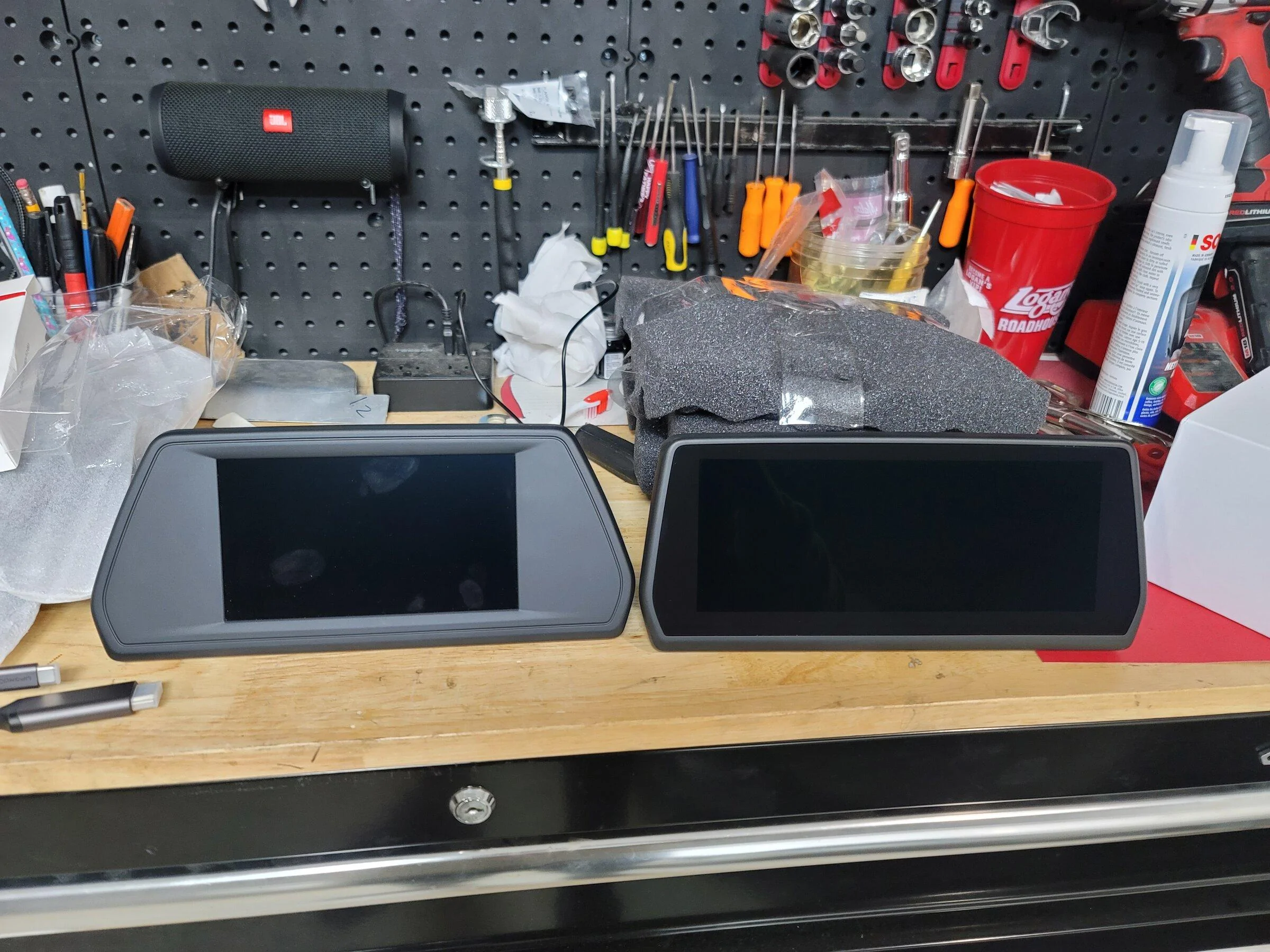

Been a few weeks but I got everything put together even upgraded the screen size. Also added a HDMI cord just in case I want to mirror my phone. Everything looks great so far just wished Android auto had more apps.

Thanks for all the help man! This is why I always enjoy position forums. Where the knowledge is shared without making anyone feel dumb.
Nice, definitely looks like it was a worthwhile endeavor for you. As for more apps. There is an unofficial app called AAstore you can not find it on Google Play you need to sideload the .apk after direct downloading. It offers a few additional ways to add unofficial things to android auto. It is a bit wonky, do your homework. Here is a place to start. https://lusogamer.com/aastore-apk/

Seeing as the head unit controls a multitude of functions for various vehicles I believe you could open up a can of worm installing a different head unit.
Several people have swapped the Smaller 2020 unit with the larger 2021 unit. I think it's basically a non-issue.
