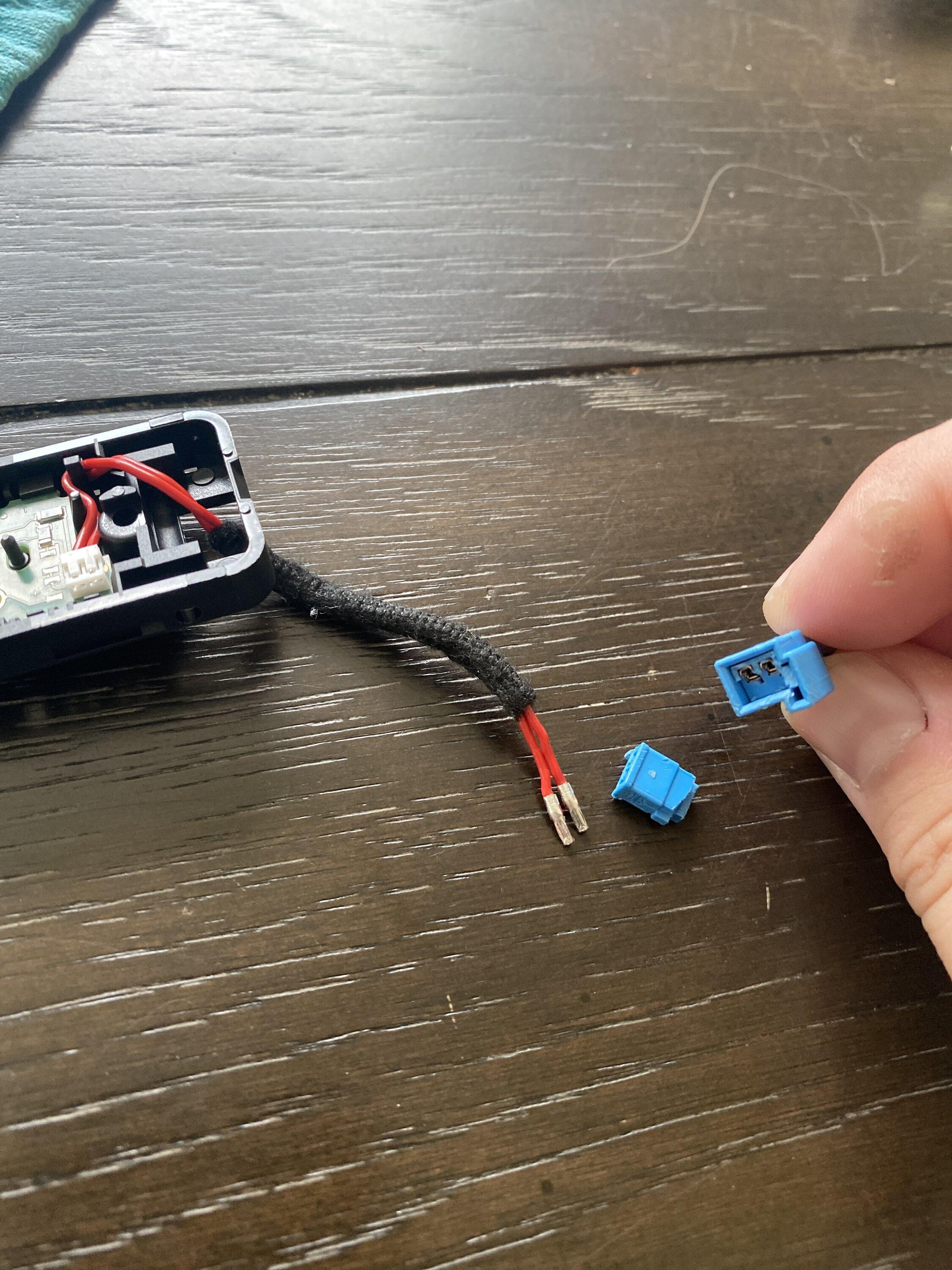

Got a Rexspeed Carbon steering wheel. Super excited! Decided to follow a video to easily remove and replace. I’ve got some experience with the process as I switched my paddle shifters a few months ago.
While remove those very paddle shifters THIS time, I managed to screw up a bit…
So now I’m searching all over the internet to no avail trying to either find a replacement to this piece, or the entire wiring harness and not having much luck.
Can anyone help? Can’t seem to locate part numbers and anything I think I DO find, there’s no picture to confirm it’s what I really need.
Please help!

Super glue it back? That’s what I would do. Or just crimp together using a coupler.
Blackmkv
Ryan
Mar 31, 2022
Pennsylvania
2021 Toyota Supra GR
I can likely glue the blue pieces together but the actual silver called red wires won’t fit back into the blue I’m holding in the picture. They bend with any applied pressure.

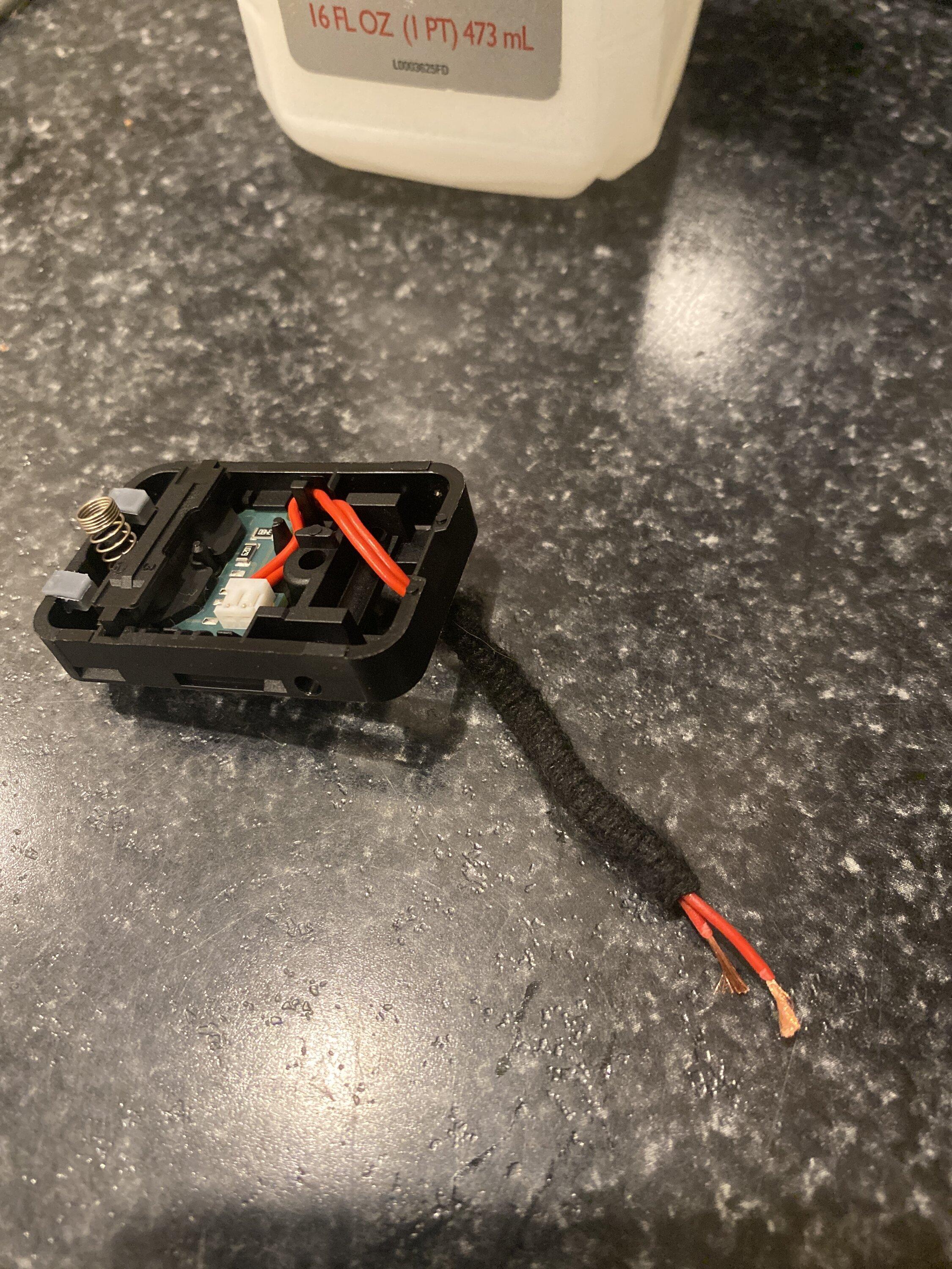

If I can figure out how to get the silver capped wires to stay in place or back into the holes, I’d be fine but if not, I’ll need to purchase a new piece.

Looks like the crimped piece on the red wires broke as well. You will probably have to replace the wiring at a minimum, unless you are really handy with wiring and can re-crimp new connectors and get a new plug (blue piece). You might want to check with the member doing the magnetic paddle shift mod as he is making new harnesses like what you need for that project, he might be able to help you find the parts you need or sell you a replacement harness.

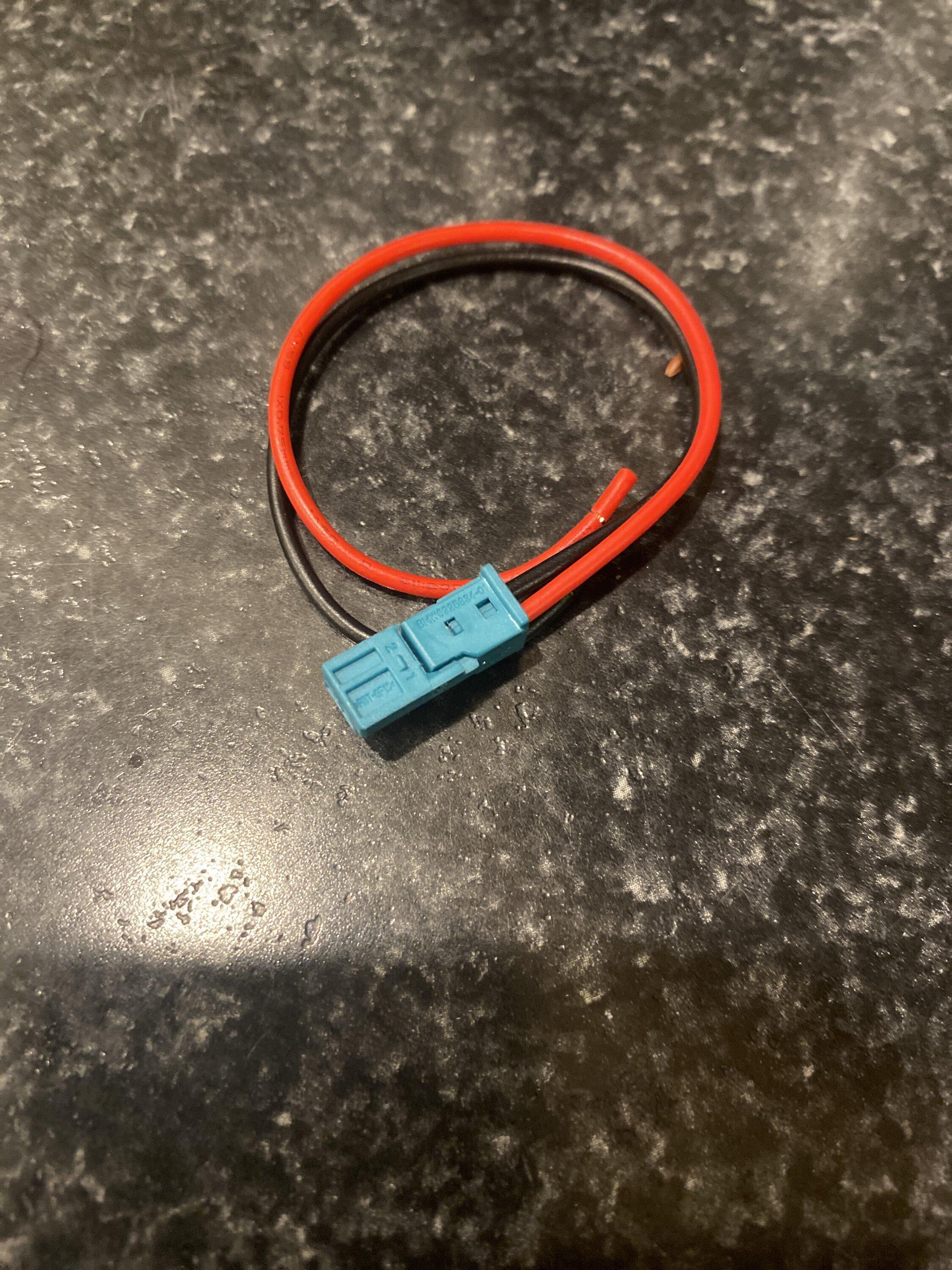

You just need to depin the broken connectors, de pin the new plugs, and replace. Should be a 4 mins affair with a sewing needle

I'm being one hundred percent serious when I say this, even though it sounds like I'm being a dick, I promise I am not. But, my 12 year old daughter almost always crimps the wiring for me. My car has several custom harnesses for things in the engine area. There's really nothing to it. Cut those ends off, buy a new connector end deal linked above, slap both sides of the wires into butt connectors, squeeze with pliers, done. This is a 2 minute job, and fun!

As long as there's enough free space in the steering wheel for extra wires and butt connectors, the actual connector pins may have to be replaced, which is a bit more finicky than a standard butt connector.

Pin tools are $1. Still easy as pie. I'd repin, with a butt connector for this job. No solder needed. There is plenty of room in the wheel for extra goodies.

How do I determine which of these wires is “positive/negative” or does that not matter for this? The new make/female pieces that were linked above came in and anxious to get this fixed! Have the wires stripped but need to ensure I do this correctly.
thanks!
