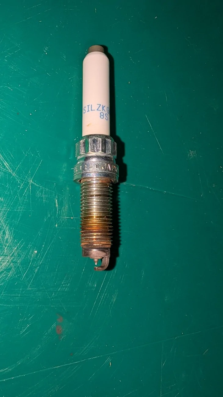

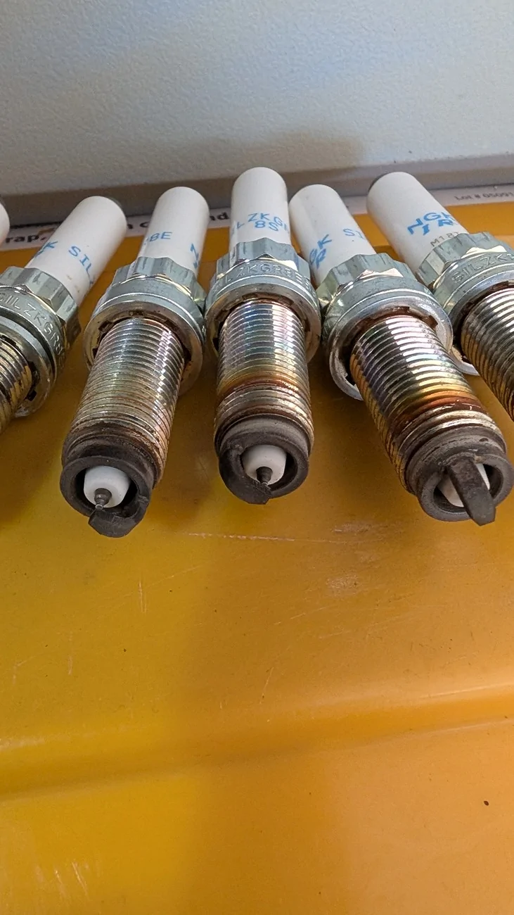

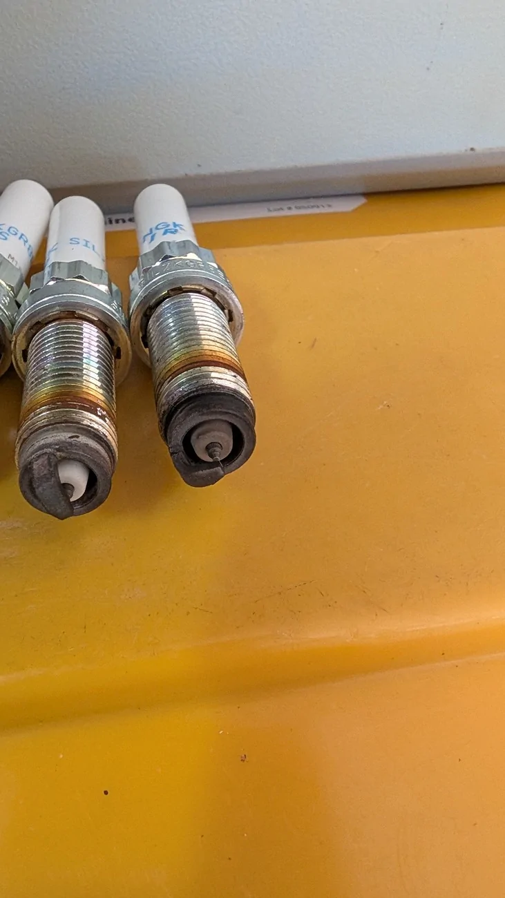

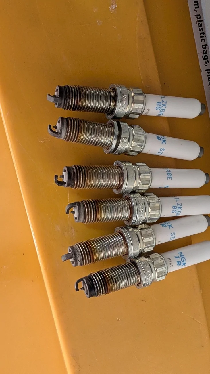

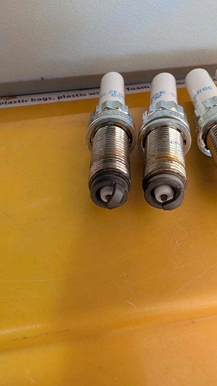

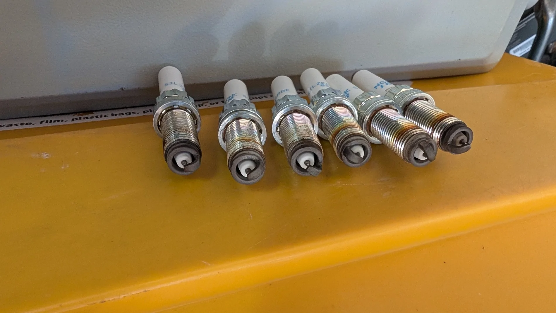

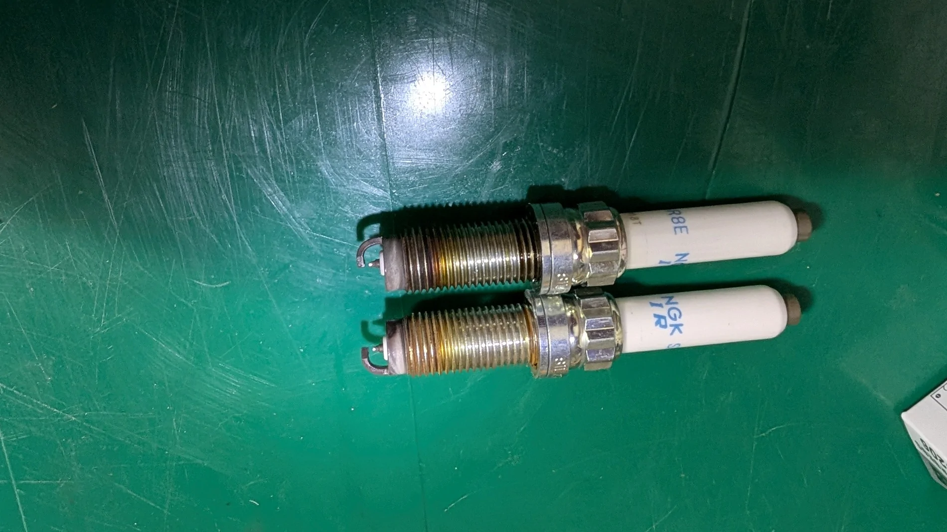

Just wanted to get thoughts on my plugs. 2nd change on them. First change was at 10k and figured I would do 5k intervals since it's tuned and driven hard.
A little oil on the top of the threads and water on #6. No oil anywhere else. Peeked at the top of the piston and it's try. Not sure what this is from. No valve cover leaks detected. Insulator tip on 1 appears to be a little darker (assume richer) than the others. Order is from right to left (1-6). Ecutek (insert tuner) ots stg 2 tune.
I plan to do a compression test (after a 14mm to 12mm adapter arrives)
8,823
17,304

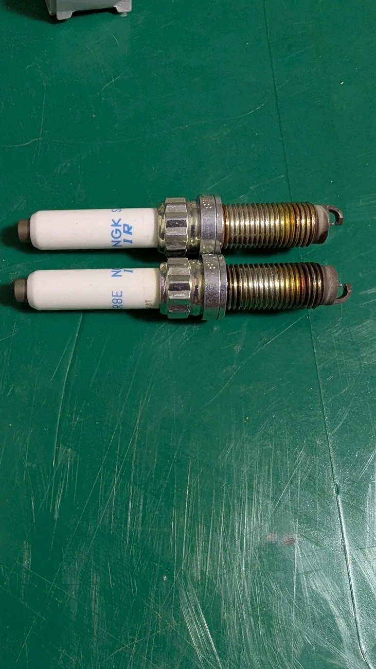

Ecutek doesn’t offer OTS tunes. Who tuned it? Also, is #6 (or whatever the darker porcelain one is) a different plug? The porcelain doesn’t look like it protrudes as much as the others. Might be the angle of the photos though.

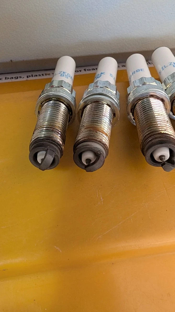

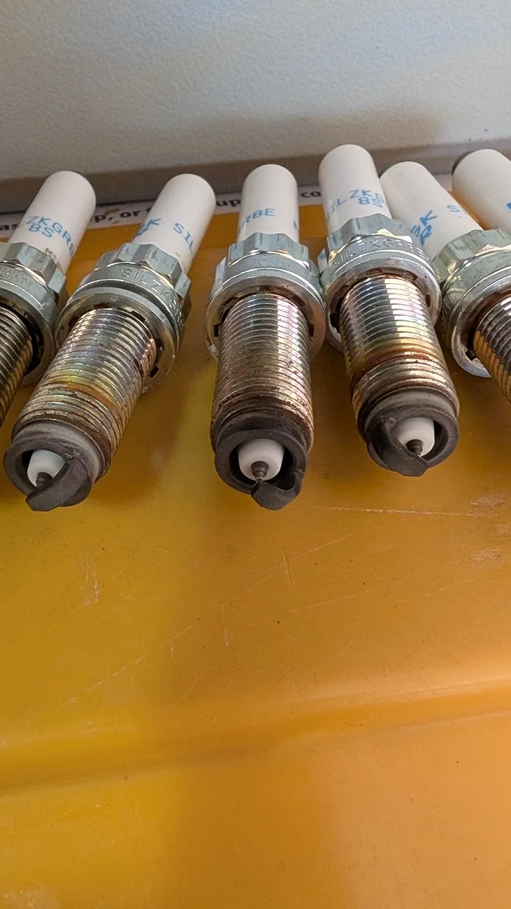

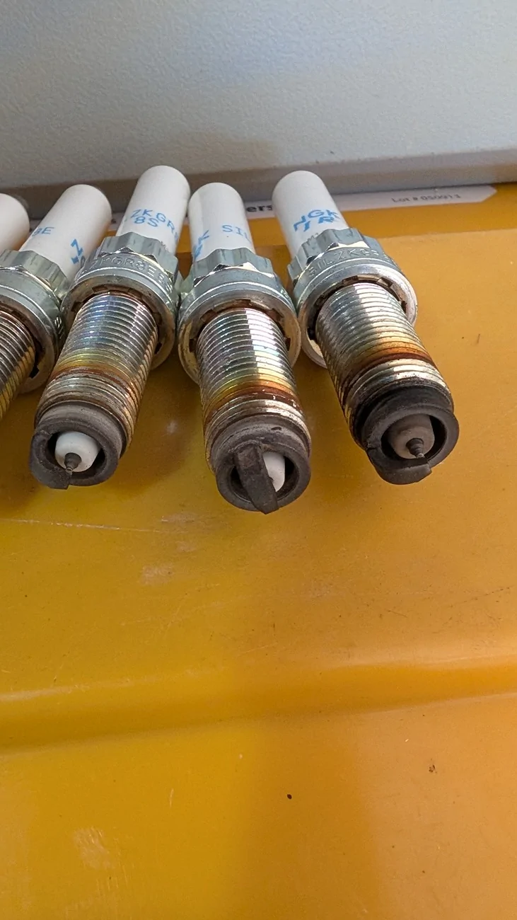

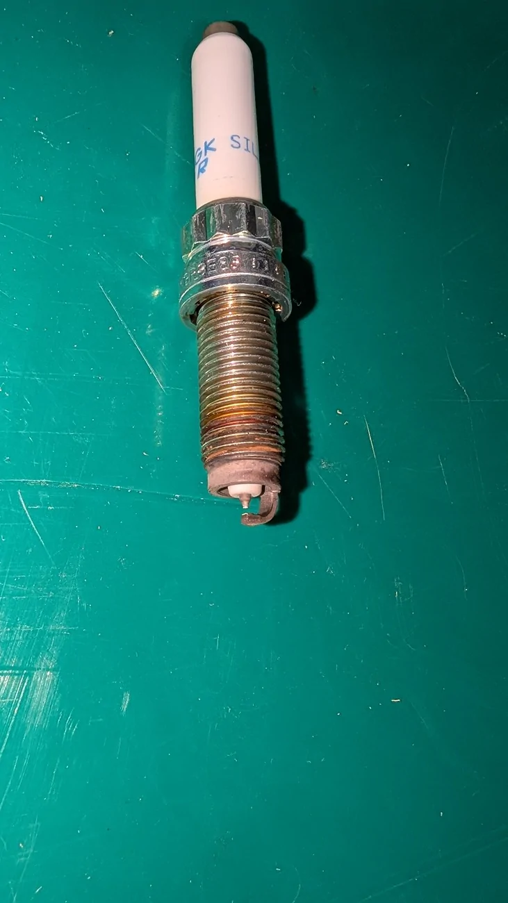

Ecutek doesn’t offer OTS tunes. Who tuned it? Also, is #6 a different plug? The porcelain doesn’t look like it protrudes as much as the others. Might be the angle of the photos though.

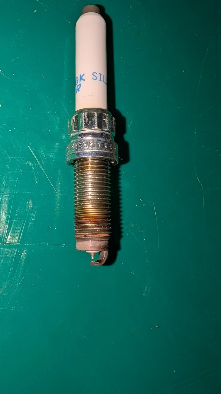

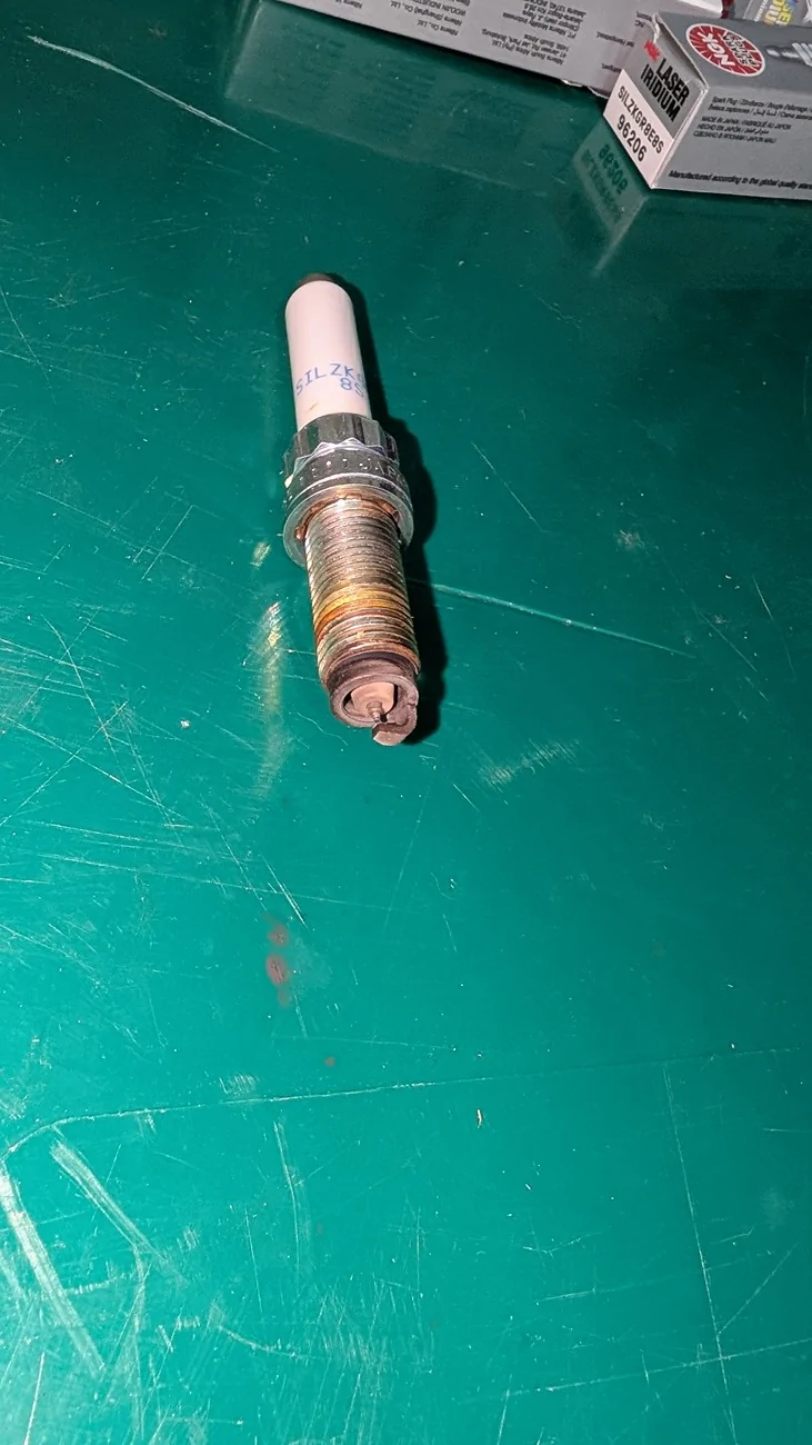

Visconti OTS tune (I should have worded it differently). They are all the same PN. More photos comparing 6 to 5. 6 on top in the 1st photo. 6 on the bottom 2nd photo.
Edit: #1 is the darkest. See post below.

Looks like issue with #1 not #6 then. #6 looks clean
itzTang
May 17, 2023
853
846
Socal
2024 Supra 3.0
It's hard to see from the photos but #6 has oil at the top of the threads by the captive washer.
if theres oil there thats usually coming from the valve cover gasket/lube seals leaking in 😬
the porcelain for #1 looks like it has more black soot than the rest. usually from running richer than the other cylinders
