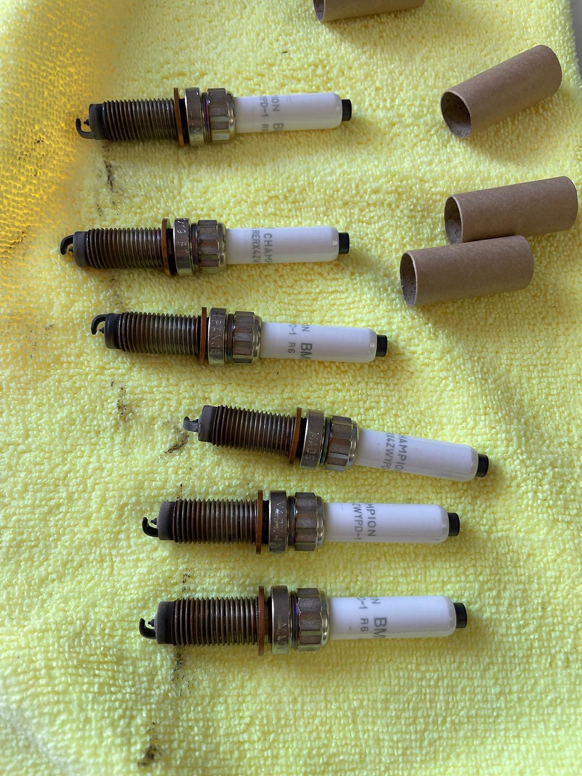

Going back to this old thread, I just got my plugs changed with my 4th Toyotacare Plus service. I was quite surprised that plugs were on the list to change. I only had 6500 miles on my old plugs but since the service called for them, I said go ahead and change them.
The part number is 90118WA461 and they are made by Champion.......so that's probably why it needs to be changed out at the 4 year mark.

They do it at 4 years because the owners manual states it's required to maintain emissions control warranty

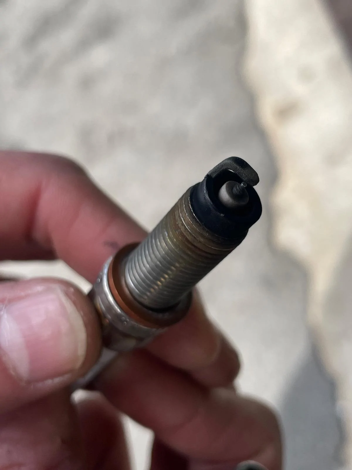

Just replaced mine at 39k(6k of them tuned) with ngk 96206
I don’t know enough to make a comment about their condition but they look pretty bad to me.
Does anyone know if the interval for the ignition coils the same?
After looking into some info about reading them. I think this looks like standard wear and tear but correct me if I’m wrong.

Here's a tip. Modern fine wire electrode precious metal plugs in general have a very long lifespan and 60,000klms is often the quoted manufacturers replacement interval which for the average person is around 4 years. Some even go 80,000klms. The issue is that although the plug electrodes can still deliver good running at those sort of intervals I'm not that convinced the plugs from a mechanical perspective should be left in the head for that period of time. I've replaced quite a few plugs that have been fitted for 5 years or more and the removal process is often a worrying procedure. It's clear that the threads in the head don't much like the experience of a 5 year old 60,000klm plug being removed. I've never had a thread strip out or show obvious signs of damage but I can tell from how they unthread it's not a happy place for them. Some Ford engines are renowned for stripping out their plug threads on plug removal due to the extended change interval. Personally on a daily driver 2 years 30,000klm is about all I let them stay in for no matter what the manufacturer will allow.
Phil
lucky phil
Phil
Jan 23, 2023
1,563
1,813
Reading plugs on a road engine is fraught with danger . If the car spends a lot of time in urban crawl and or does a lot of cold starts for short trips to work etc then it's pretty pointless and won't tell you much unless there is a massive issue going on.
