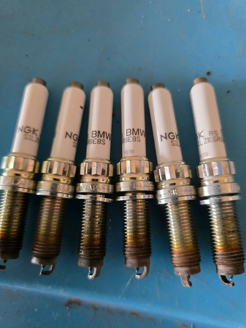

NGK: SILZKGR8E8S / 96206 / Laser Iridium.
Has any Ruthenium plugs been released or used on these B58s yet?

I think it varies on what bmw used at the assembly factory either ngk or champion. But I would go ngk if I were to pick. They’re proven to be reliable and work for a long time.

Depends on the year
Mine were NGK from the factory so the NGK replacement made sense. By the way you do need a special socket (thin) to remove the plugs.
