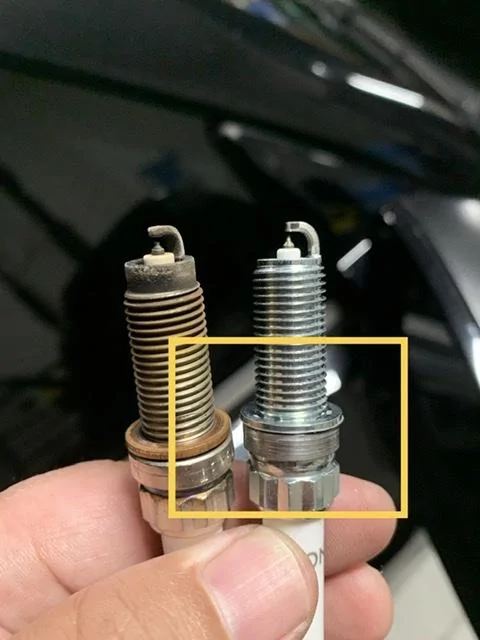

Looks like stock plugs are good for most tuned applications, but would the recommended interval change? US manual looks like 30k intervals. Any recommendations for spark plug interval for tuned applications?

it’s time for me to switch my spark plugs in my opinion on my mk5 Supra. i’m on jb4 e30 with catless downpipe and intake map 3. should i stick with the oem plugs or switch to NGK 97506 (SILZKBR8D8S, but one heat range colder and regapped)?

97506 plug are NOT for B58. Do not use them. Just stick to the stock plugs andntock gap

Stock plugs, stock gap. It's not 1994 anymore.
I have been running OEM Champions 600whp+, no issues.
Only small thing I had was some break up past 30psi. I just increased the coil charge table a smidge and it cleaned it right up.

Stick with Oem Champion plugs or if you want NGK it's the 96206
