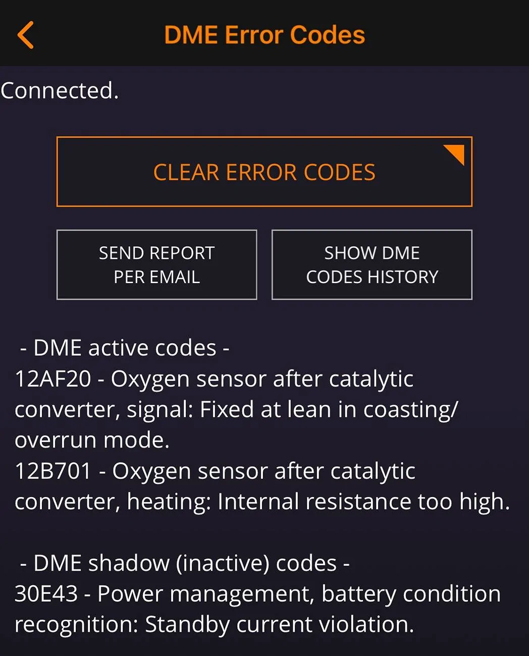

Can someone please tell me if this is a regular "sports cat" code or is this more serious? I ask because my MHD Stage 2 tune doesn't suppress the CEL and I thought it was supposed to filter out innocuous DP codes.
Am I missing something?

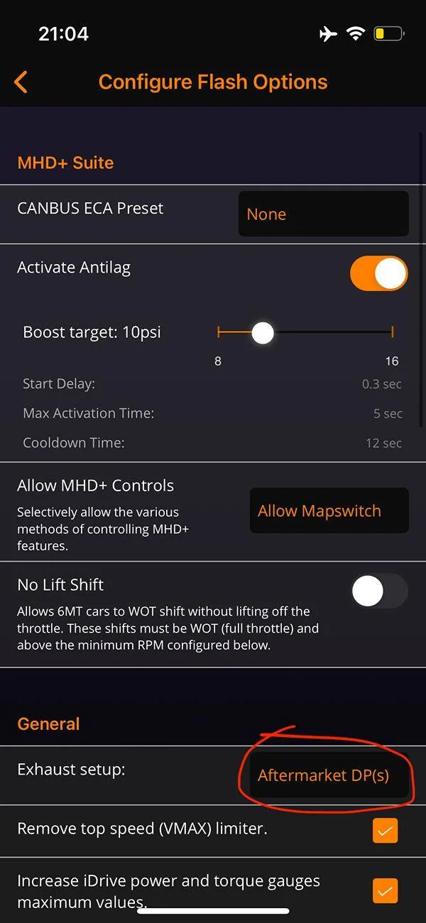

Did you switch the “DP Configuration” option in the flash settings to aftermarket? That’s what should disable the CELs. If you did and you’re still getting them, shoot MHD support an email.
I thought I did. As it's a stage 2 tune I'd assume it has to be, no? And try as I might, looking through the MHD app I can't find where I would manually select this option any more.
It wouldn’t be set unless you explicitly set it yourself. It’s in the flash options on the same screen as the big orange “Map Write” button right before you flash. Scroll through and look for “DP Configuration”.
I'll double check but I'm pretty confident I ticked that box.

A90 Supra; FN2 CTR
I have the after market DP setting checked. See below.
The errors I get are:
12AF2O - Oxygen sensor after catalytic converter, signal: Fixed at lean in coasting/ overrun mode.
12B701 - Oxygen sensor after catalytic converter, heating: Internal resistance too high.
12AB04 - Oxygen sensor after catalytic converter, signal: Open circuit.
