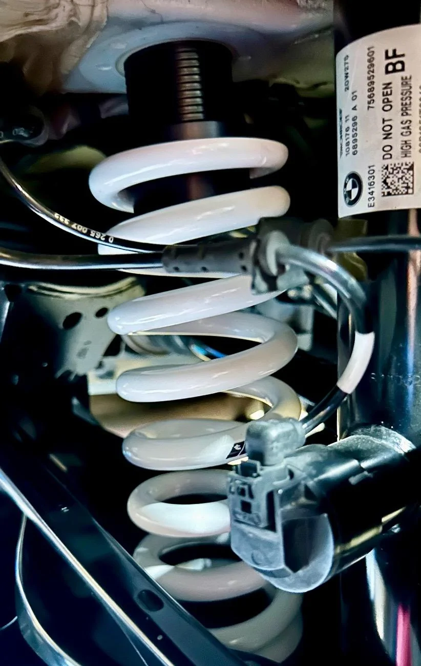

I found this (Motortrend):
"Spring rate is the amount of force required to compress a spring 1 inch, while spring load is the force required to compress a spring to a certain height. For example, a 350-lb/in spring requires 350 pounds of force to compress 1 inch. A spring that compresses 2 inches under 200 pounds of load will compress 4 inches under 400 pounds of load."
The question is, how many inches does each spring compress?
