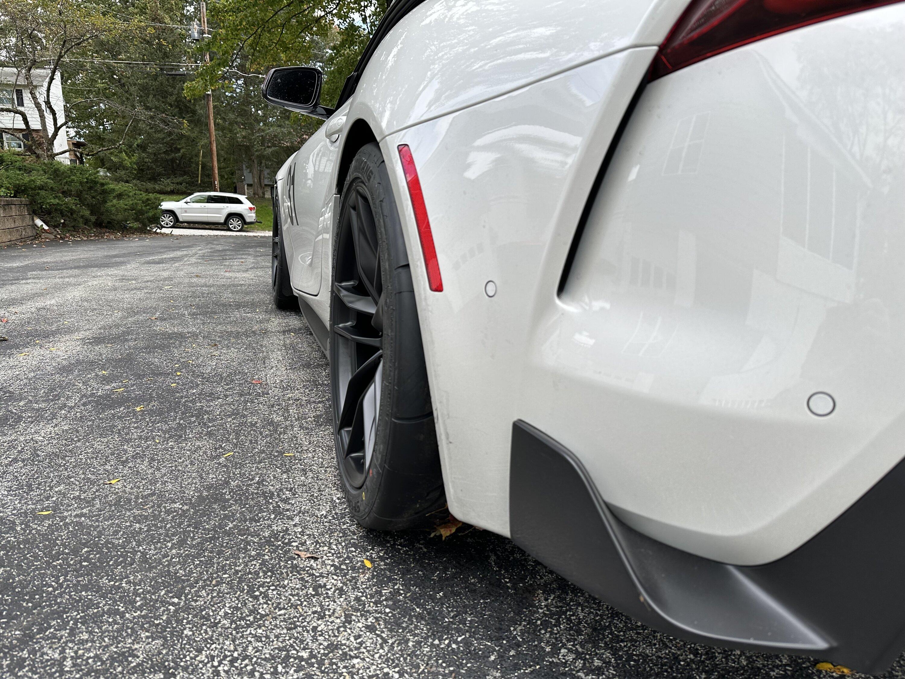

275/35/19 Nankang AR1
Keep in mind I’m on coilovers. I’m not certain what size front spacer you need for oem struts.
Really appreciate it! The good news is with all the wheels/tires I’ve managed to collect I’ll be able to do some testing before pulling the trigger on my next new tire purchase.
Love my 275/35-18s. It’s a nice size for tire availability. Which keeps cost down, in addition being able to rotate.
Modern cars come with inherent understeer for obvious reasons (such as hard brake induced tank slapping). Like already mentioned, it will put some more play back into the car as well.

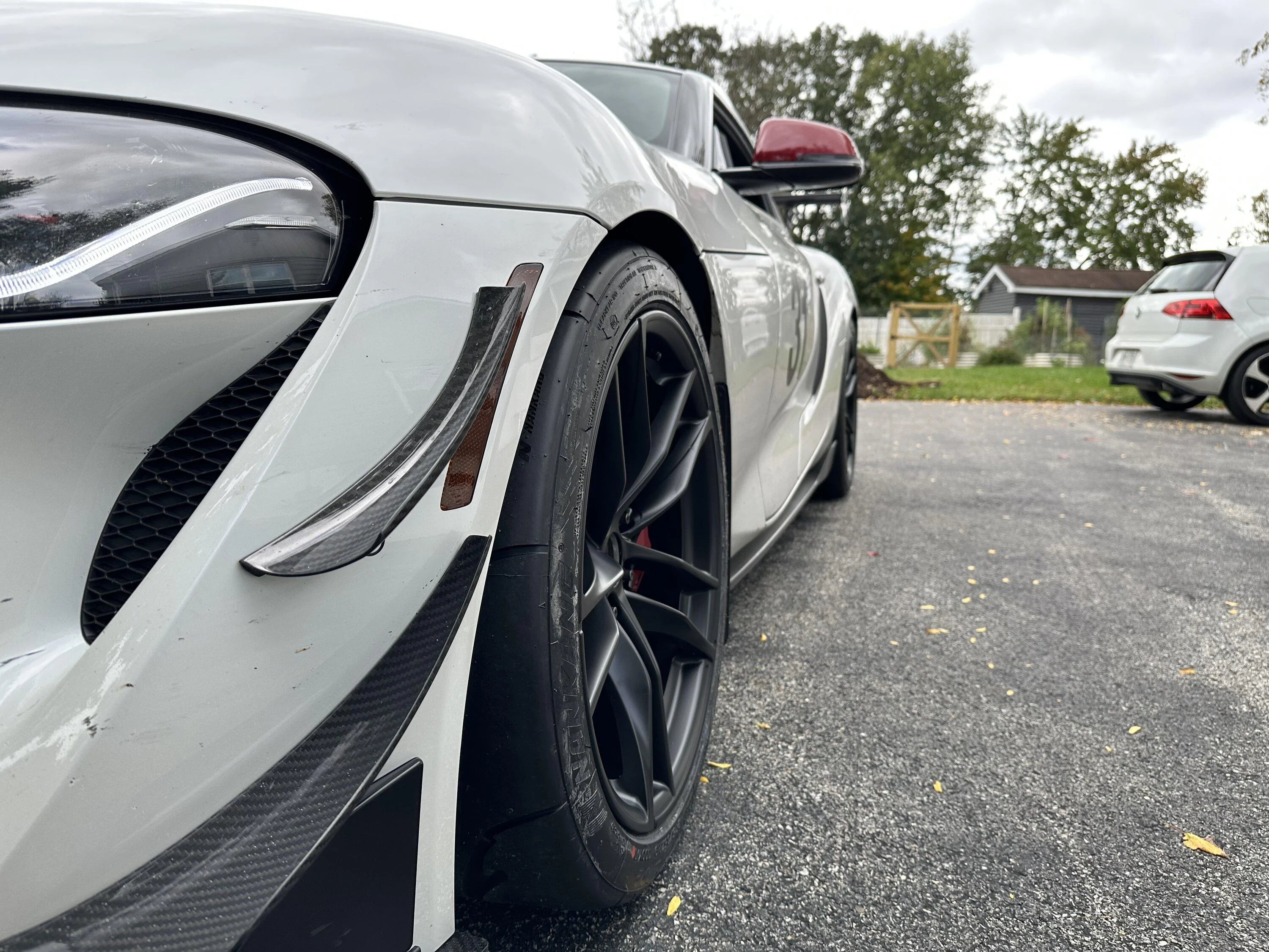

Looks good, how much camber are you running on this setup? Do you have any rubbing on the liners?

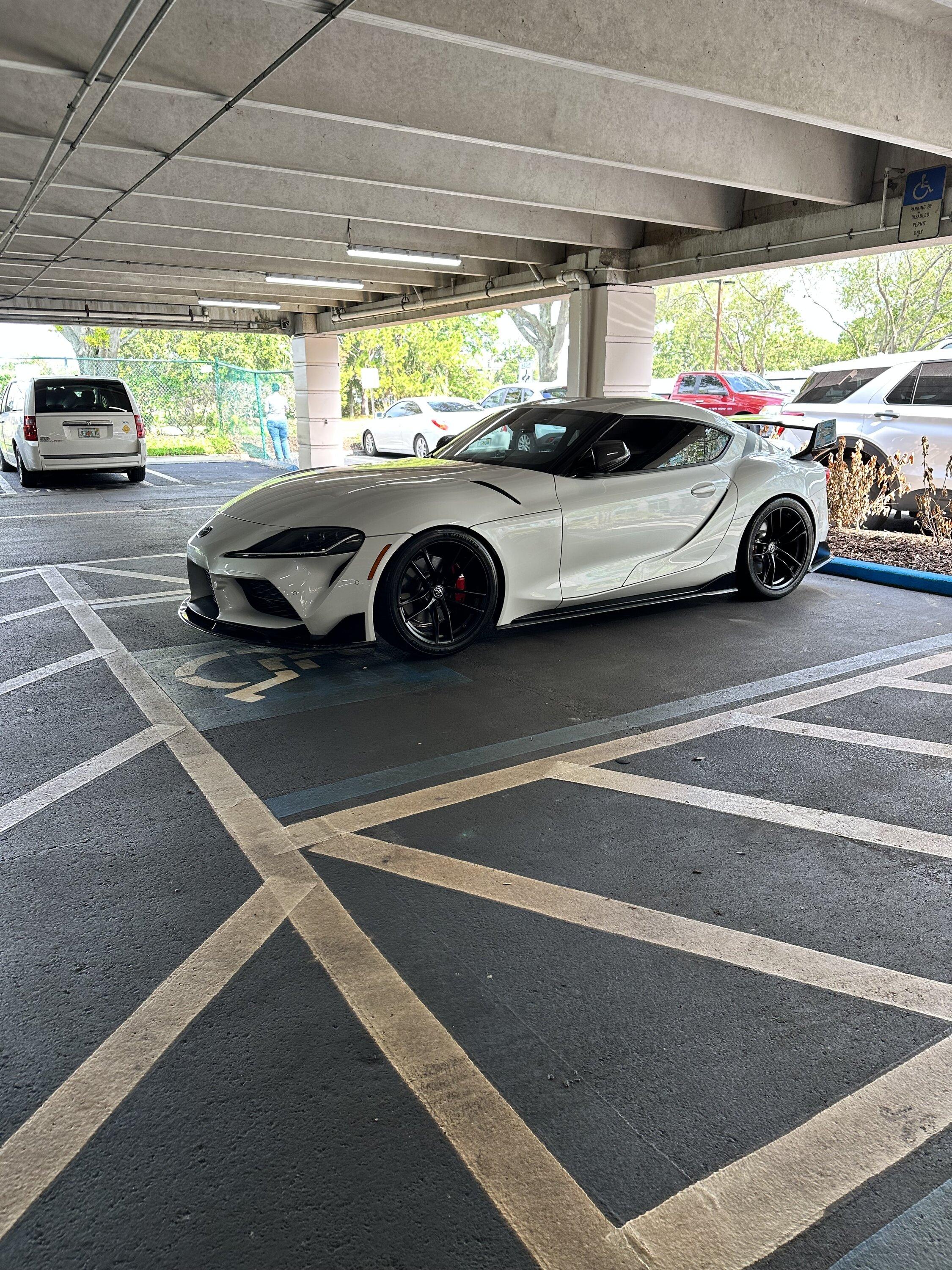

I’m running the stock rims front/rear and with 275 Michelin PS4S and 13mm front spacers with 10mm rear spacers on the rear with a 305/30 and no rubbing issues, this should give you room for more track oriented alignment as well without rubbing the front strut. Also lowered on whiteline springs.

Completely forget about updating this thread until I got a notification today. Anyway, I ran this season on a squared set up using OEM rear wheels on the front, 275/35/19 RE-71RS tires, and 10mm spacers. Zero rub.

Great to know! Did you run any additional camber? And any chance you know how close the wheel/tire is to the spring isolator?

3 degrees camber with verus plates. It looks very close, like a few mm but that’s a rubber piece so even if there was slight contact it wouldn’t cause any issues. Would just wear a tiny bit of the rubber off and then no more rub.
