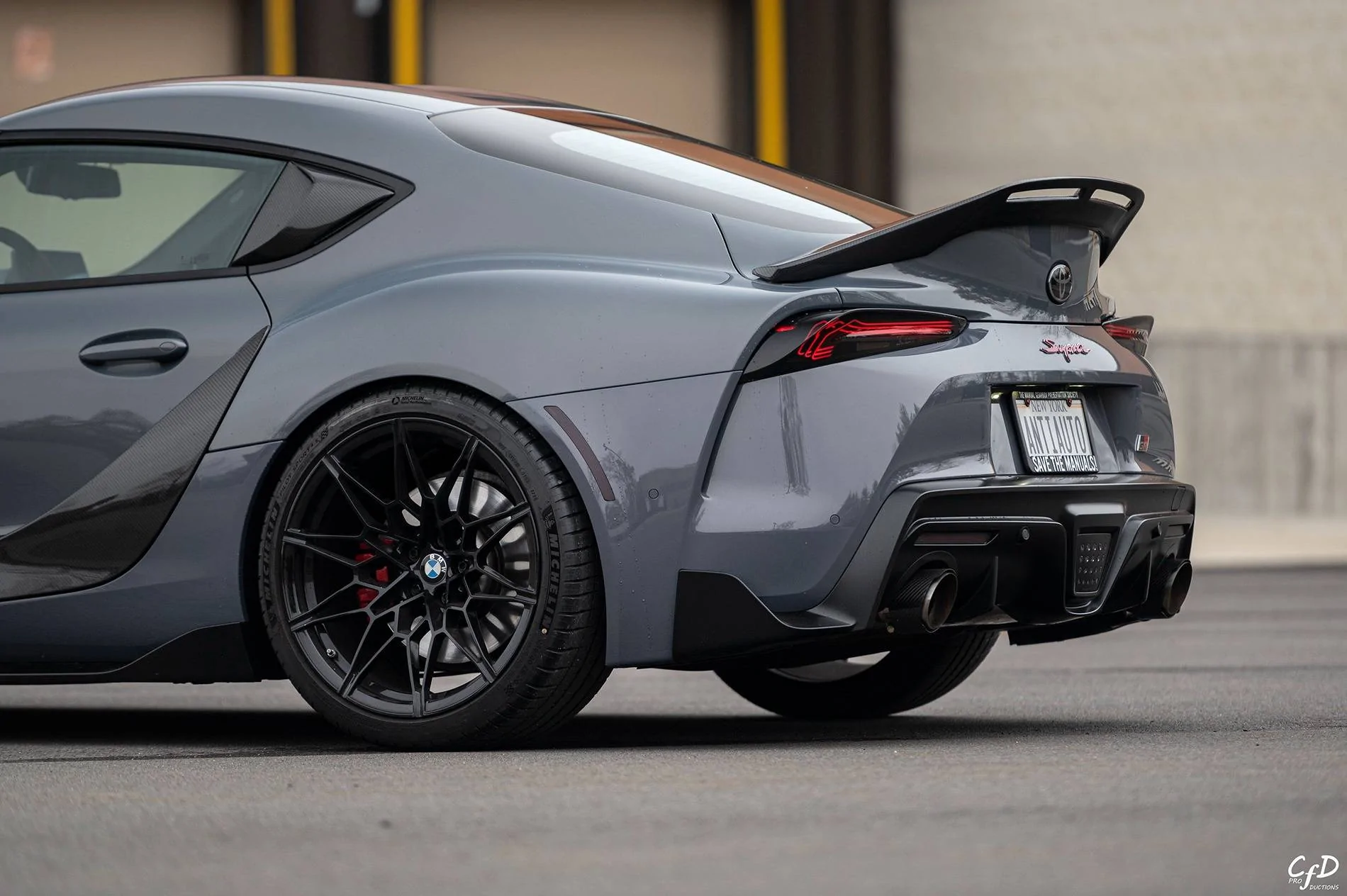

Looks awesome but that slight rubbing part. If taken on track for a fun HPDE event I wonder if the rubbing will be more apparent. Otherwise street car would be great maybe on stock springs or HAS option. Or maybe more rear camber.
I think 19 squared would fix it or just a smaller tire … these are too tall

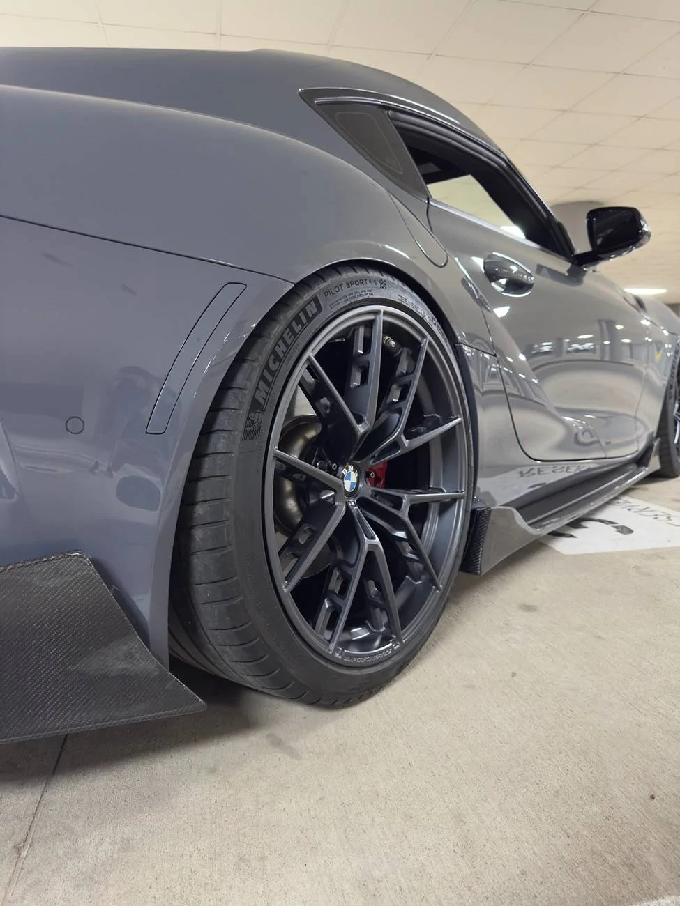

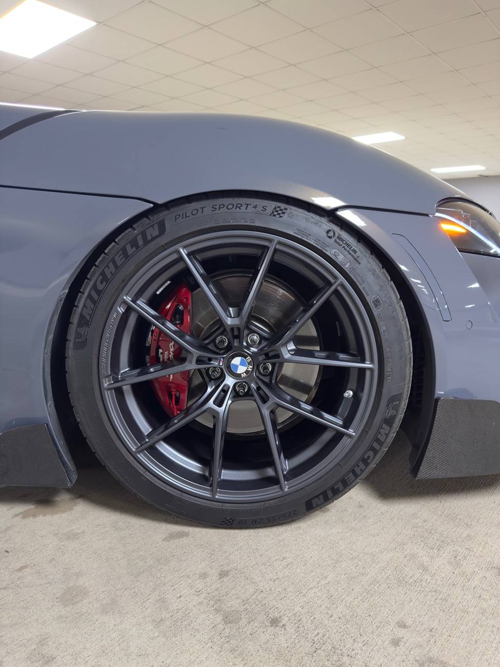

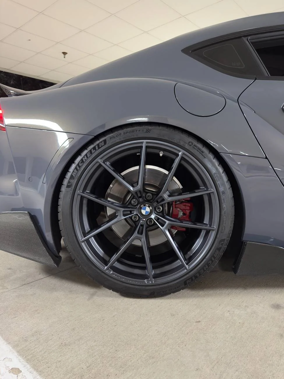

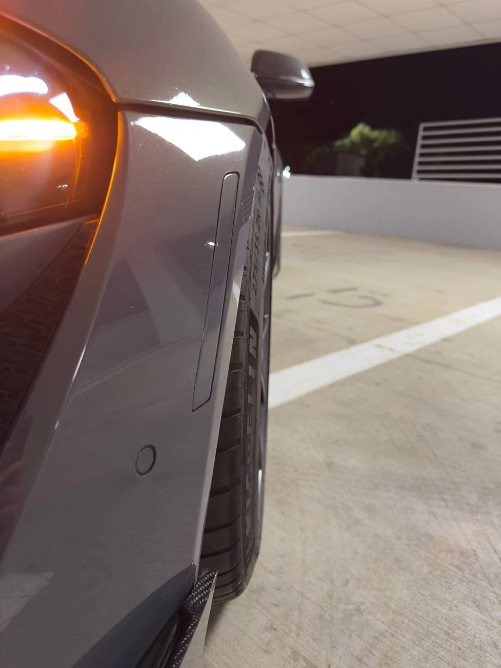

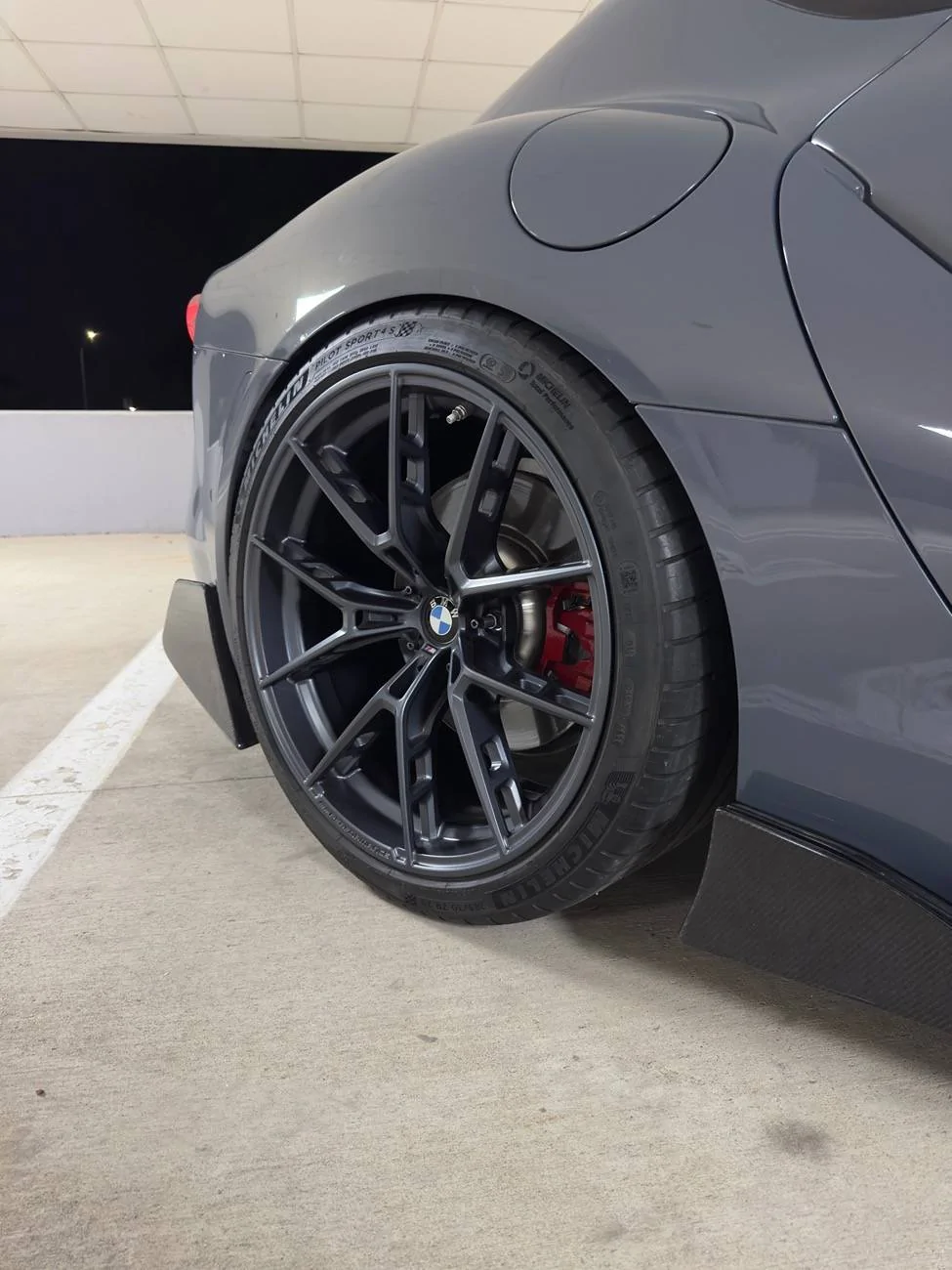

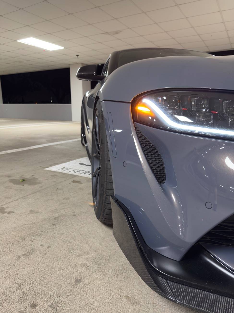

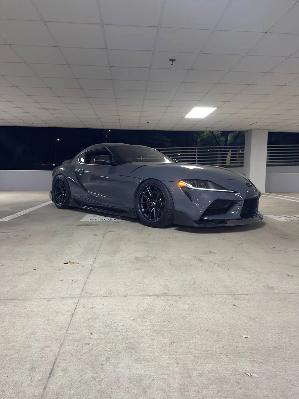

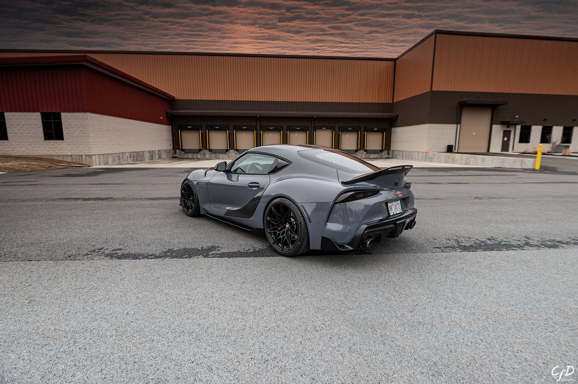

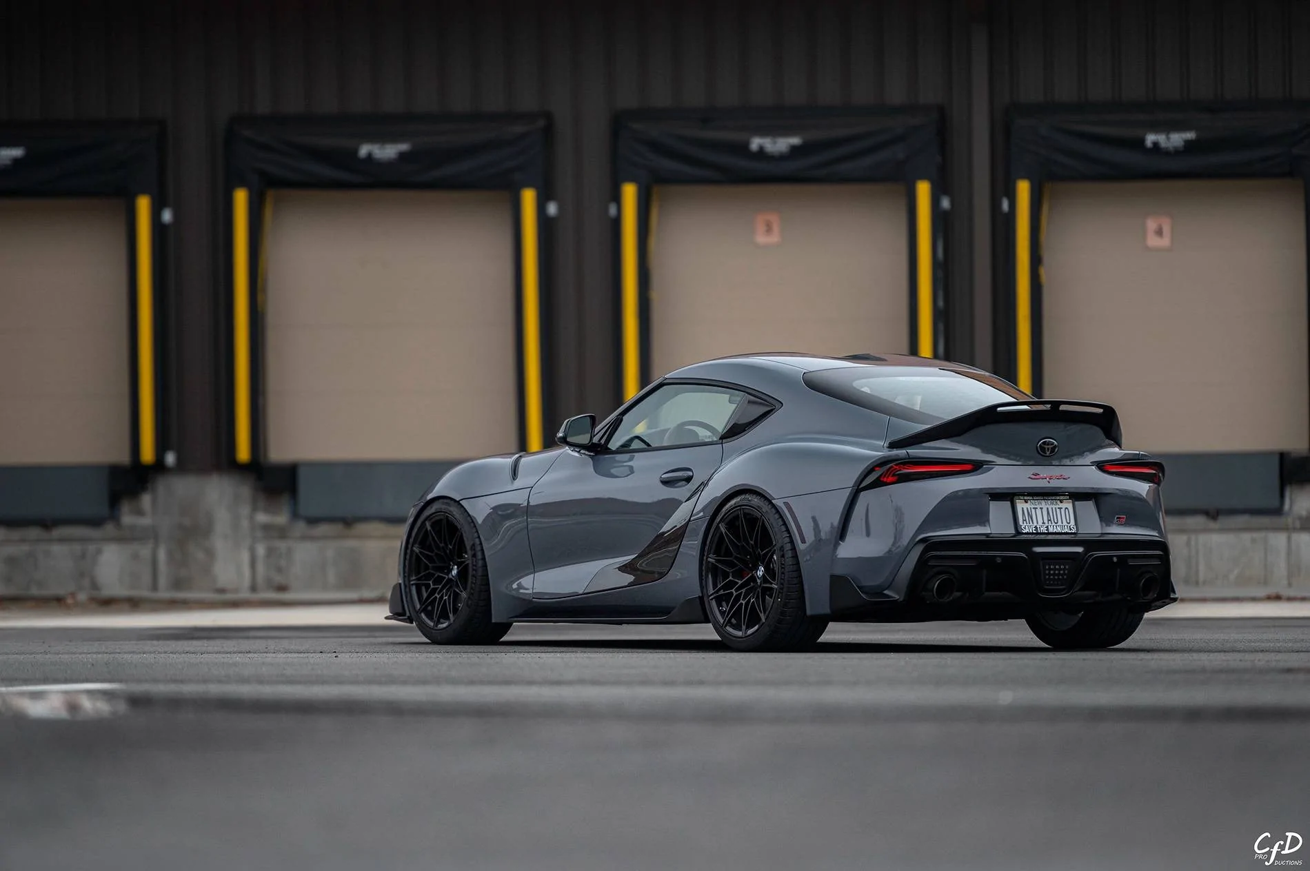

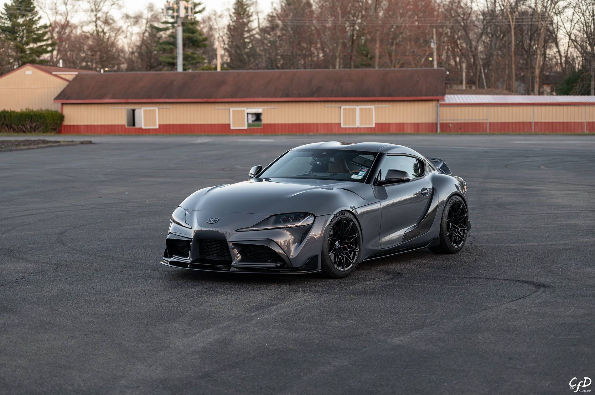

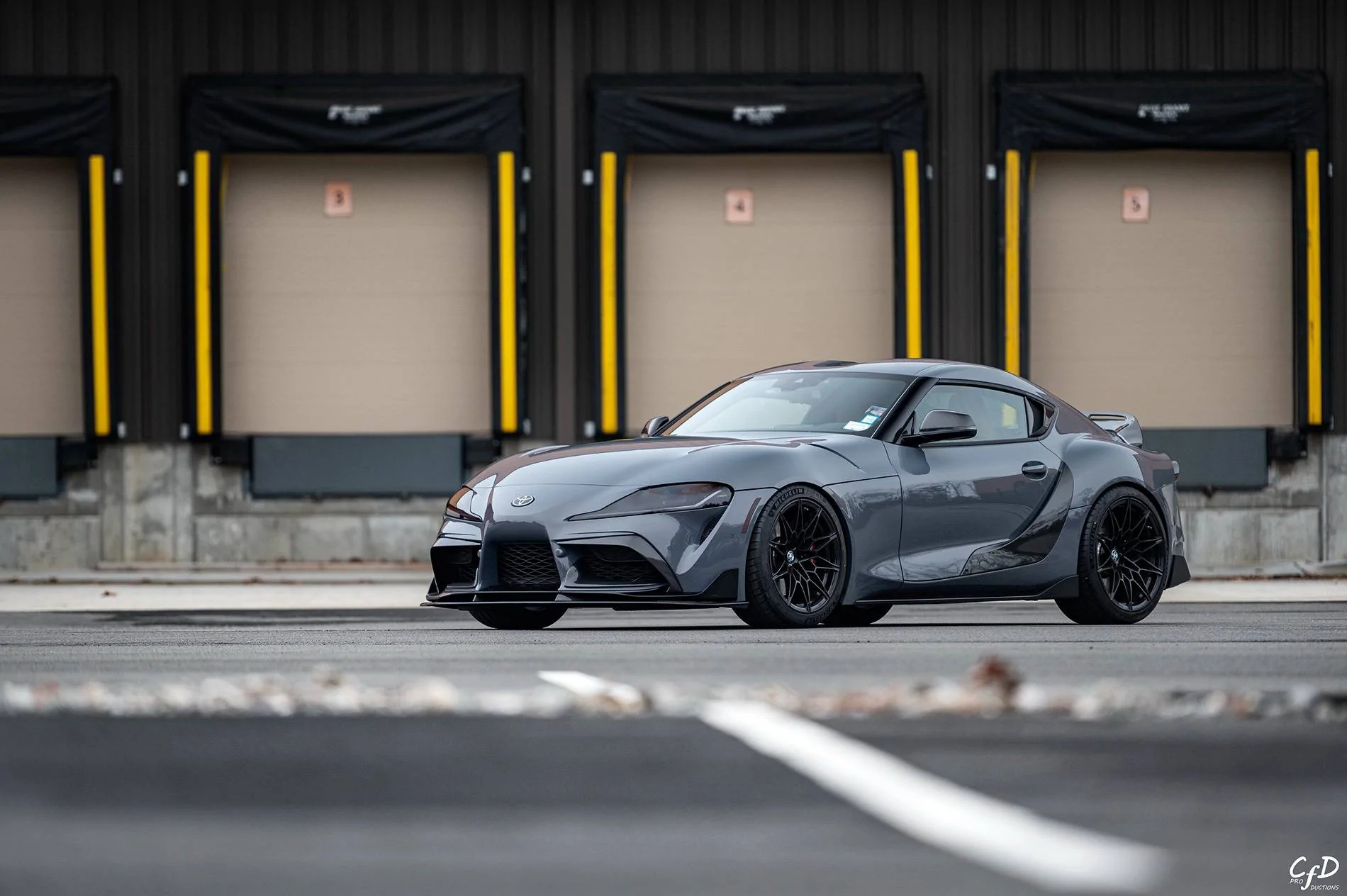

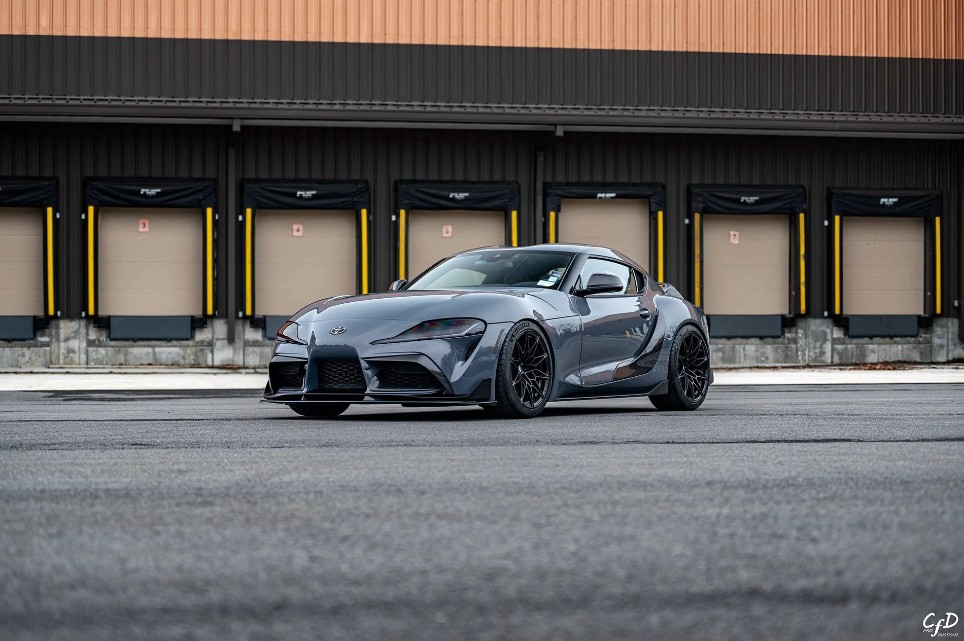

If anyone was ever on the fence about putting G80 wheels on their supra hopefully this helps.
Oem spec G80 wheels and tires straight off a brand new 2024 M3
No spacers
Eibach springs
Slight rub in the rear of the vehicle over very large bumps or dips have not heard anything from the front yet

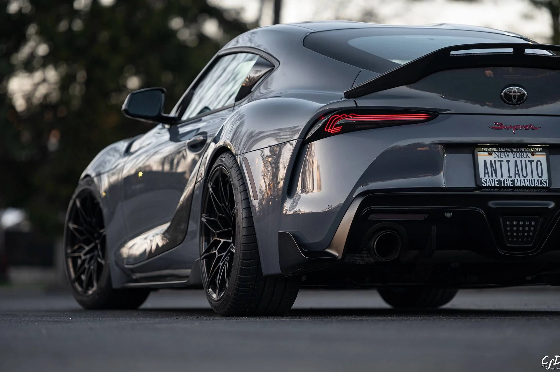

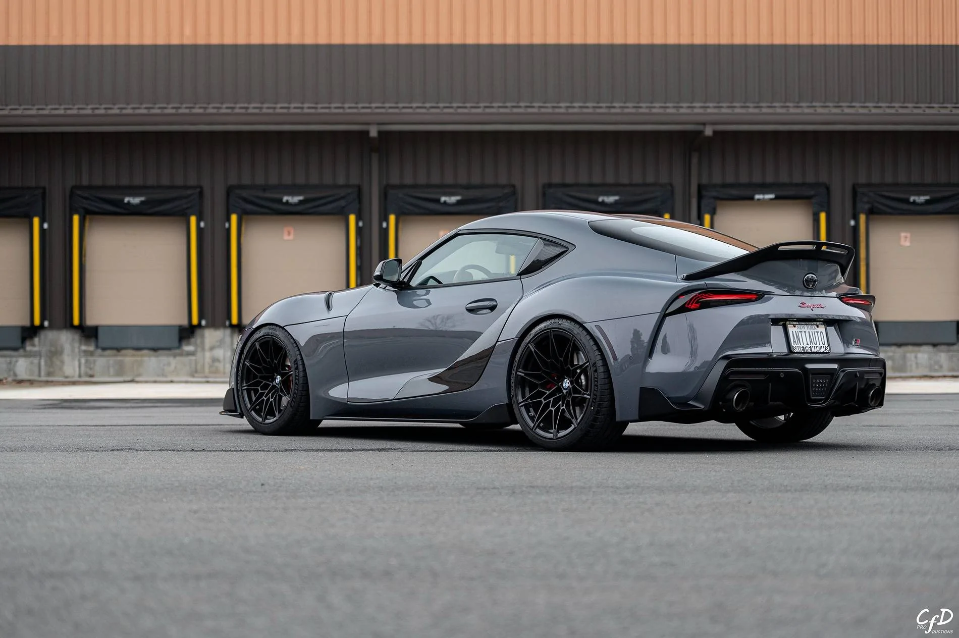

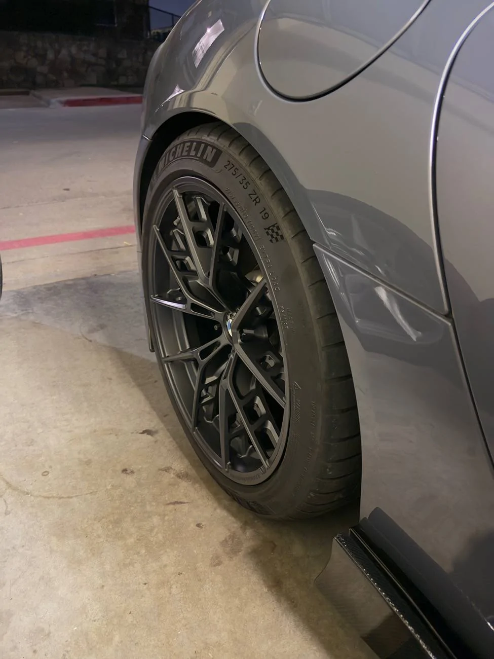

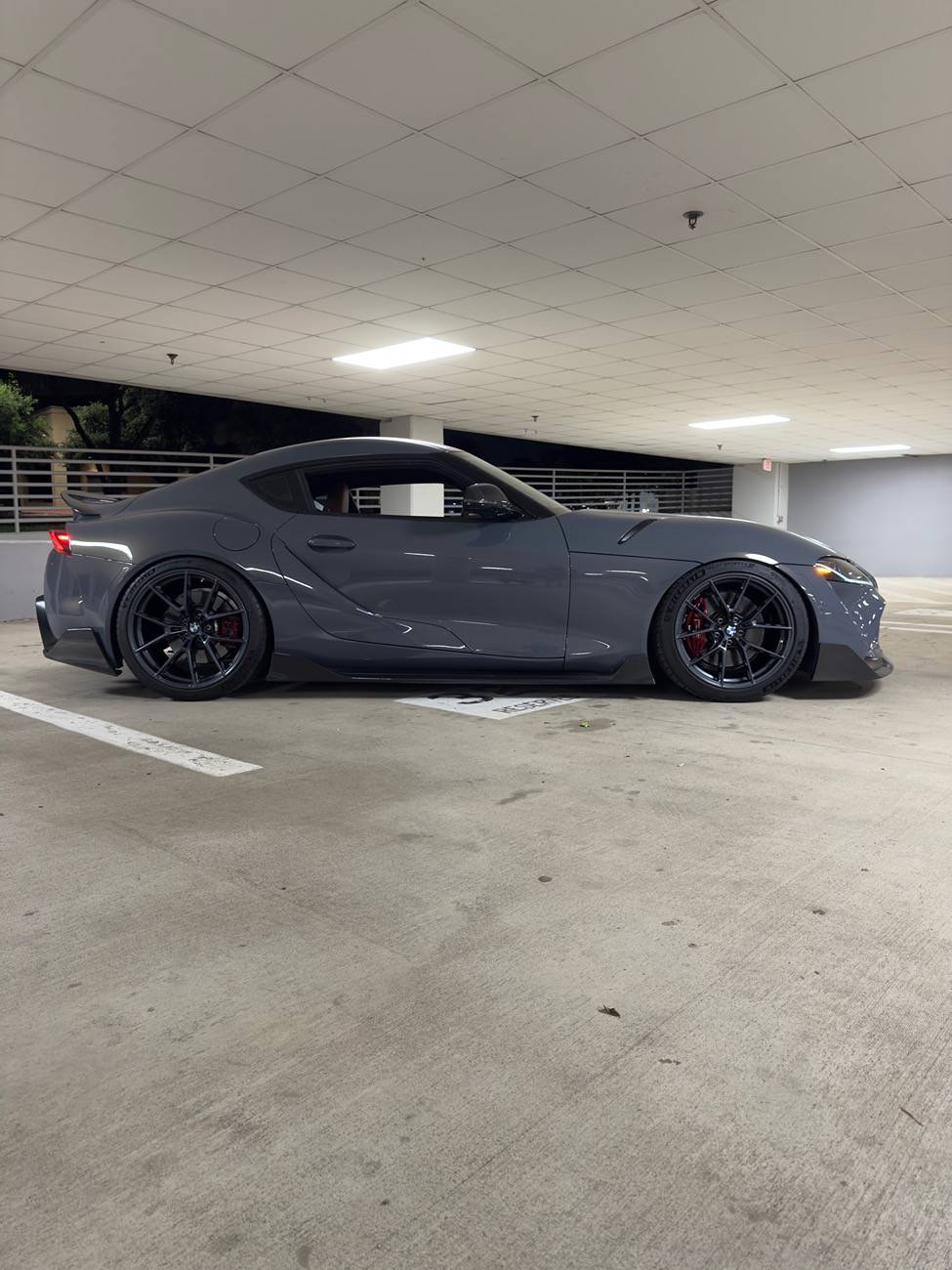

I’ll join in with G80 spec 963Ms
19x9.5 et20 275/35/19
20x10.5 et20 285/30/20
RSR Superdown springs
rear rubs hella, pokes about 8mm
We also threw a front onto the rear and it’ll fit pretty good with a 285/35/19 or a 10mm spacer, see very last pic
No spacers
Eibach springs

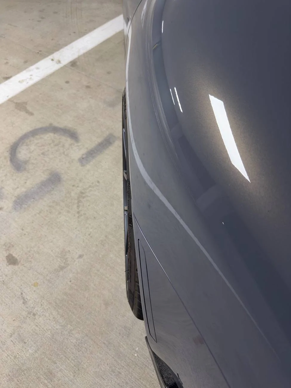

Hey, thanks for this post. Question though. You say that there is some rubbing on the rear but in the other post you say there is rubbing in the front. Is there rubbing on both front AND rear?
Cfdproductions
Cfdproductions
Dan
Jul 29, 2023
227
408
Albany ny
23 A91mt
All depends on how big of a bump you hit. Normal driving no but a big enough dip will cause them all to rub on the fender liners.
