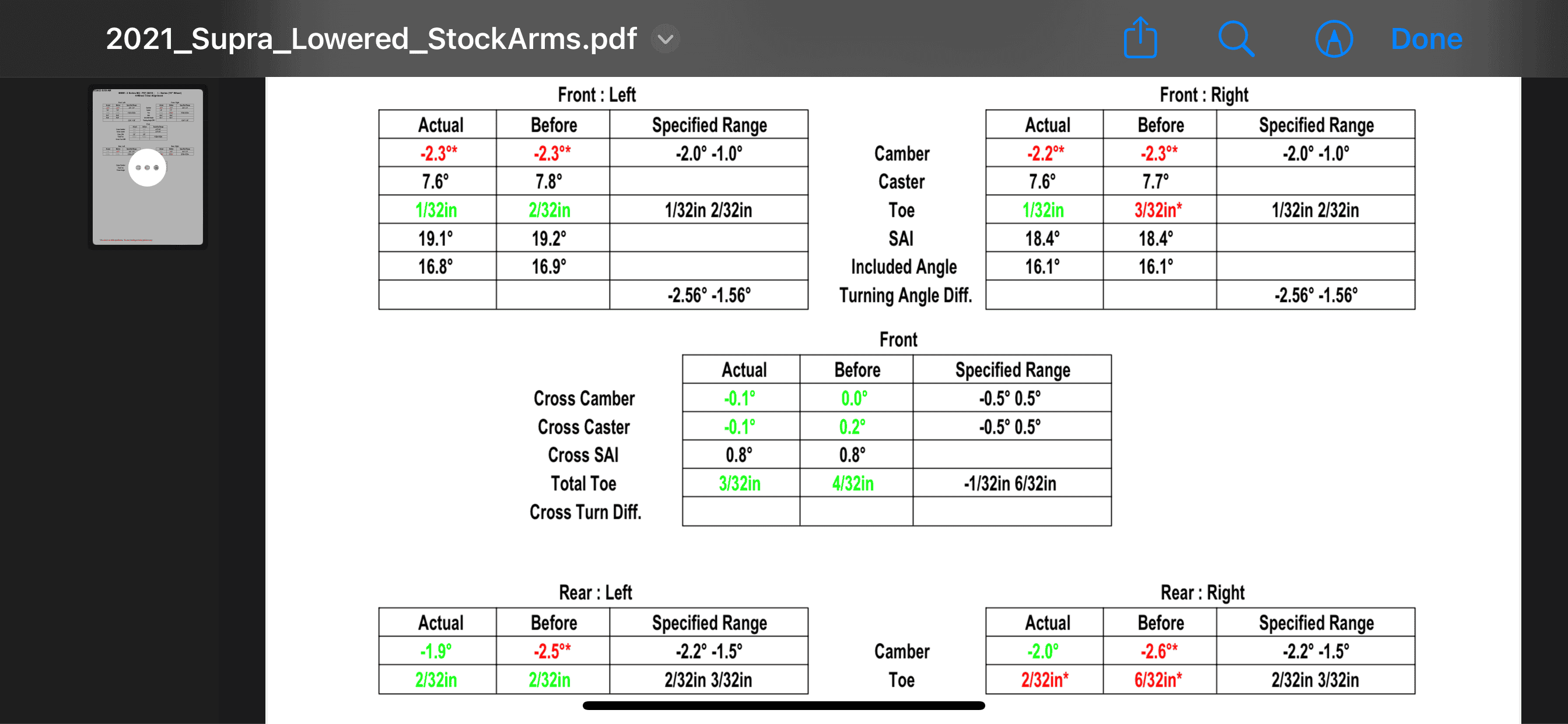

Just so y’all can see this is what a stock wheel Supra with stock tires the way they came from the factory alignment looked like with swift lowering springs. Backstory: took car in for alignment at mom and pop shop after steering rack was replaced and car drove fine no swaying but I didn’t like How it felt compared to before repairs and alignment. Took the car to a performance alignment shop and look how far off some of the specs were.
Moral of the story don’t trust anyone to touch the car go to an actual racing shop for your alignment and stop putting mismatched tires on your vehicle.

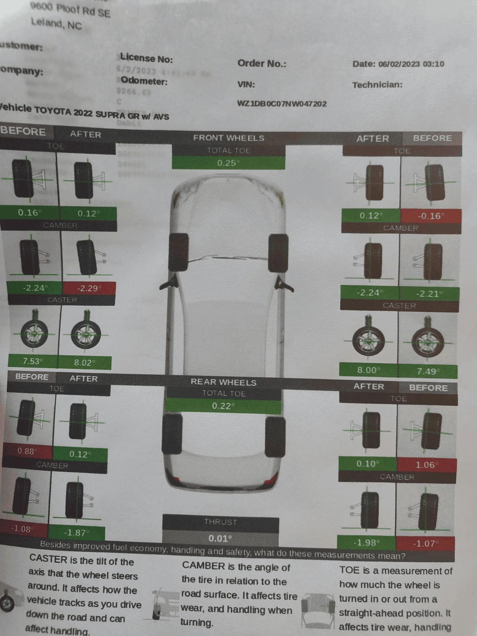

2022 Supra 3.0L here. Went from the factory 19s down to 265/40/18 in the front, 285/40/18 in the rear, had ZERO problems.
Installed MSS kit, got an alignment. Car was fine for few thousand miles.
Was driving in the rain one day and that's when the swaying started. The rear end felt like it was swimming left and right and left and right. Got home, saw the inside of both rear tires was toast, but the rest of the tread was as well. Just not nearly as bad as the inside.
Now, these were PSS all the way around. The fronts still look brand new. As I said, the rears burned up exceptionally quick. So I put Falken 510s on the rear

I've already had an alignment. I had one done after I installed the MSS kit. I think it was too late by the time I got the alignment though, because the inner rears were toast already, I just hadn't noticed it.
So, my situation now is I have PSS on the front, 265/40/18 which still has like... 90% tread life, and new Falken Azenis fk510's on the rear (285/35/18). The rear sway is back, and the VCS light ticks on super wide, easy turns. So, I'm going to get another alignment from a better shop this time. It wasn't until after I purchased the 2 rear tires that I discovered what a temperamental little bitch this car can be, and discovered they don't sell FK510's in 265/40/18. So, I guess I can go up to 275 or down to 255. It's a 10.7 inch wide wheel (I know, weird width, but that's what the Titan website says).
This is the alignment sheet after the first one.
Please note while reading: On the right side, "Before" and "After" are backwards which really messed with me at first. Anyway, I'll get another one and see if it solves the mystery. Be going to the Audi dealership Monday since they have an inground alignment rack which can handle lowered cars.
Please note while reading: On the right side, "Before" and "After" are backwards which really messed with me at first. Anyway, I'll get another paper one and see if it solves the mystery. Be going to the Audi dealership Monday since they have an inground alignment rack which can handle lowered cars.
