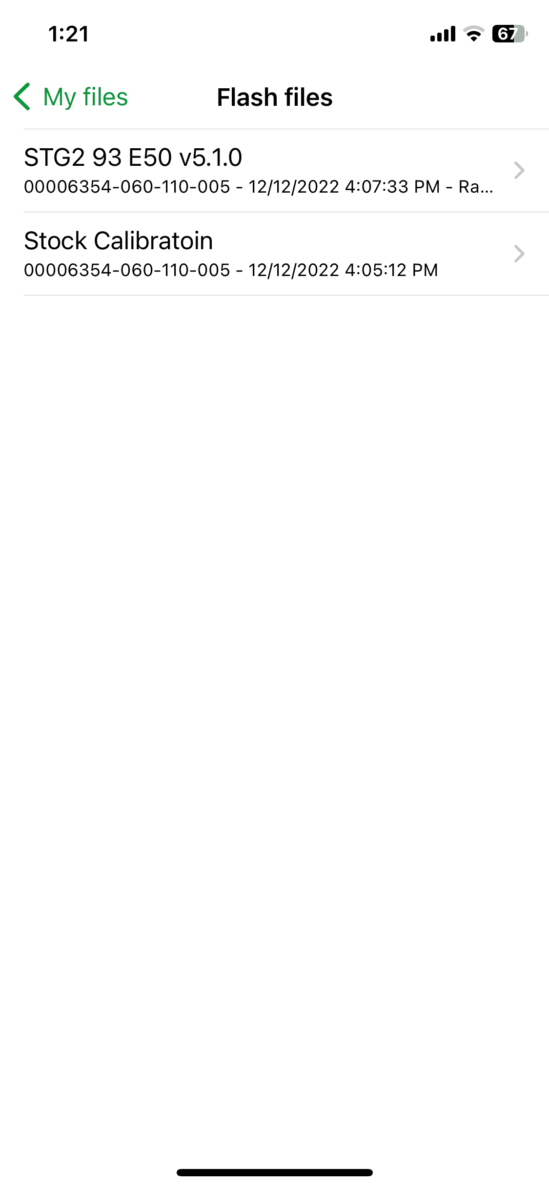

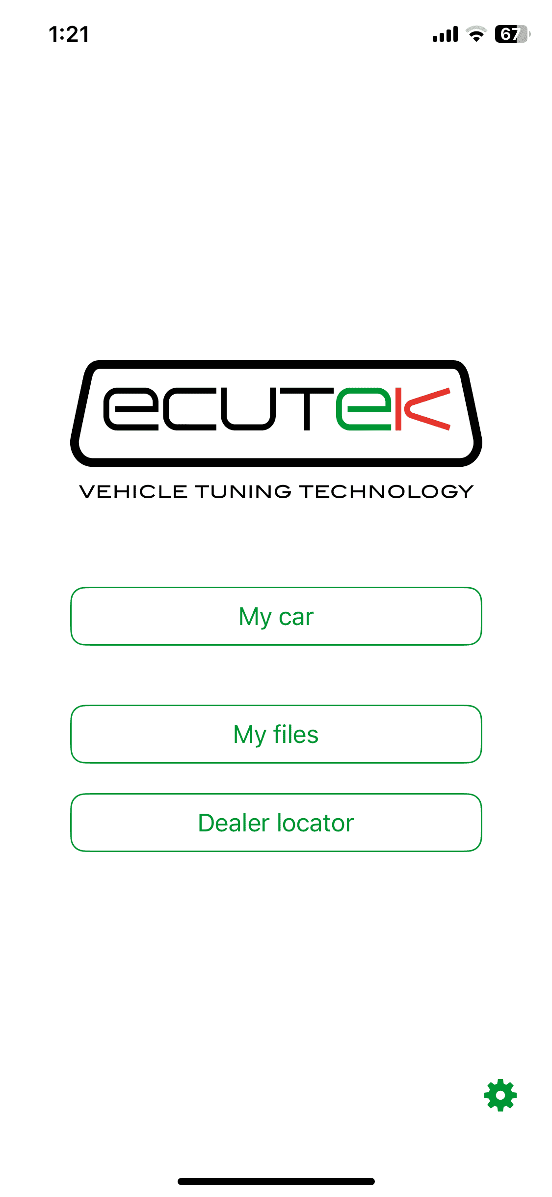

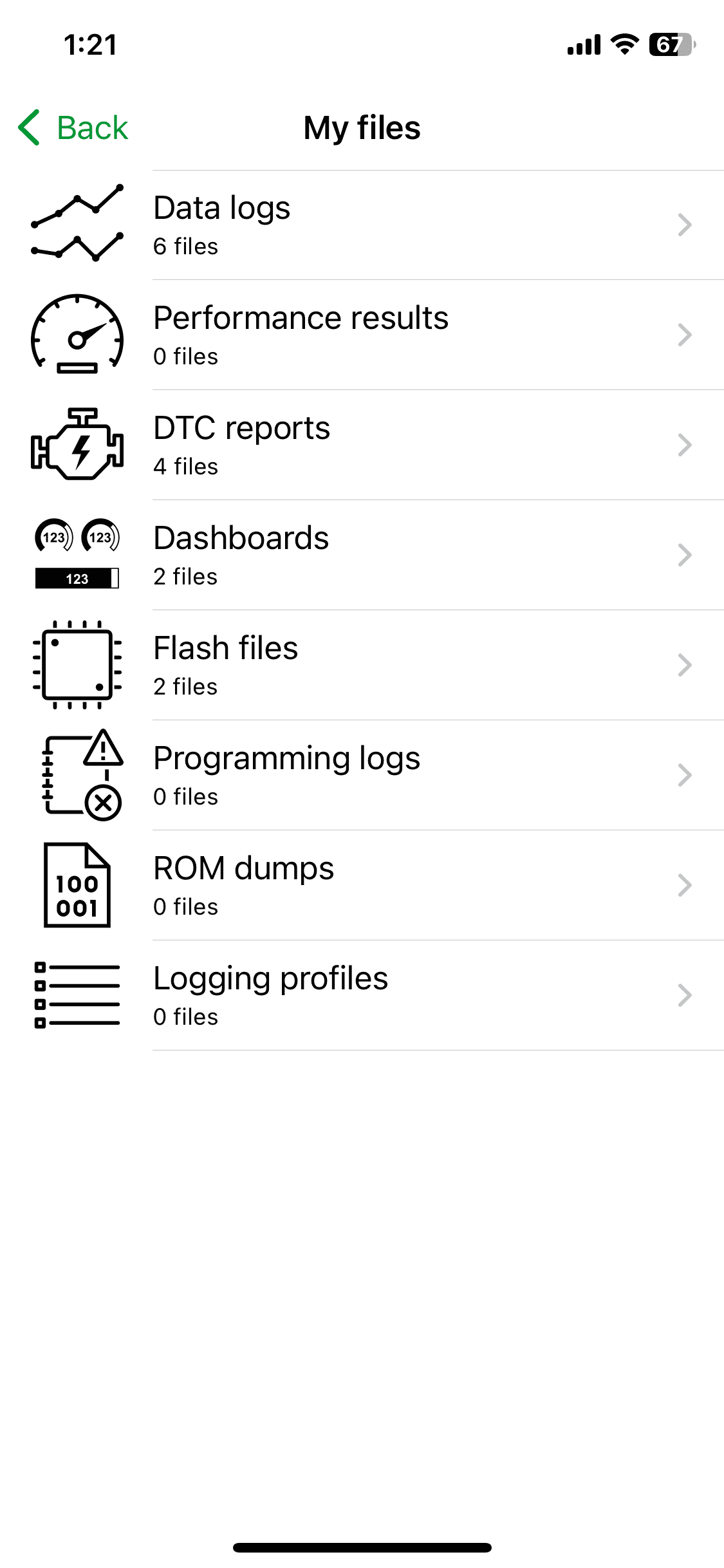

How do I flash car back to stock on ecutek? Do I need tuner to send me a stock file?
Your tuner should of given you a few maps. One of them being the stock map where you flash it back to the stock tune.
Go to your Ecutek connect app on your cell phone.
open up my files
then go under flash files
and it should have a stock map there. See attached below. Super easy.
