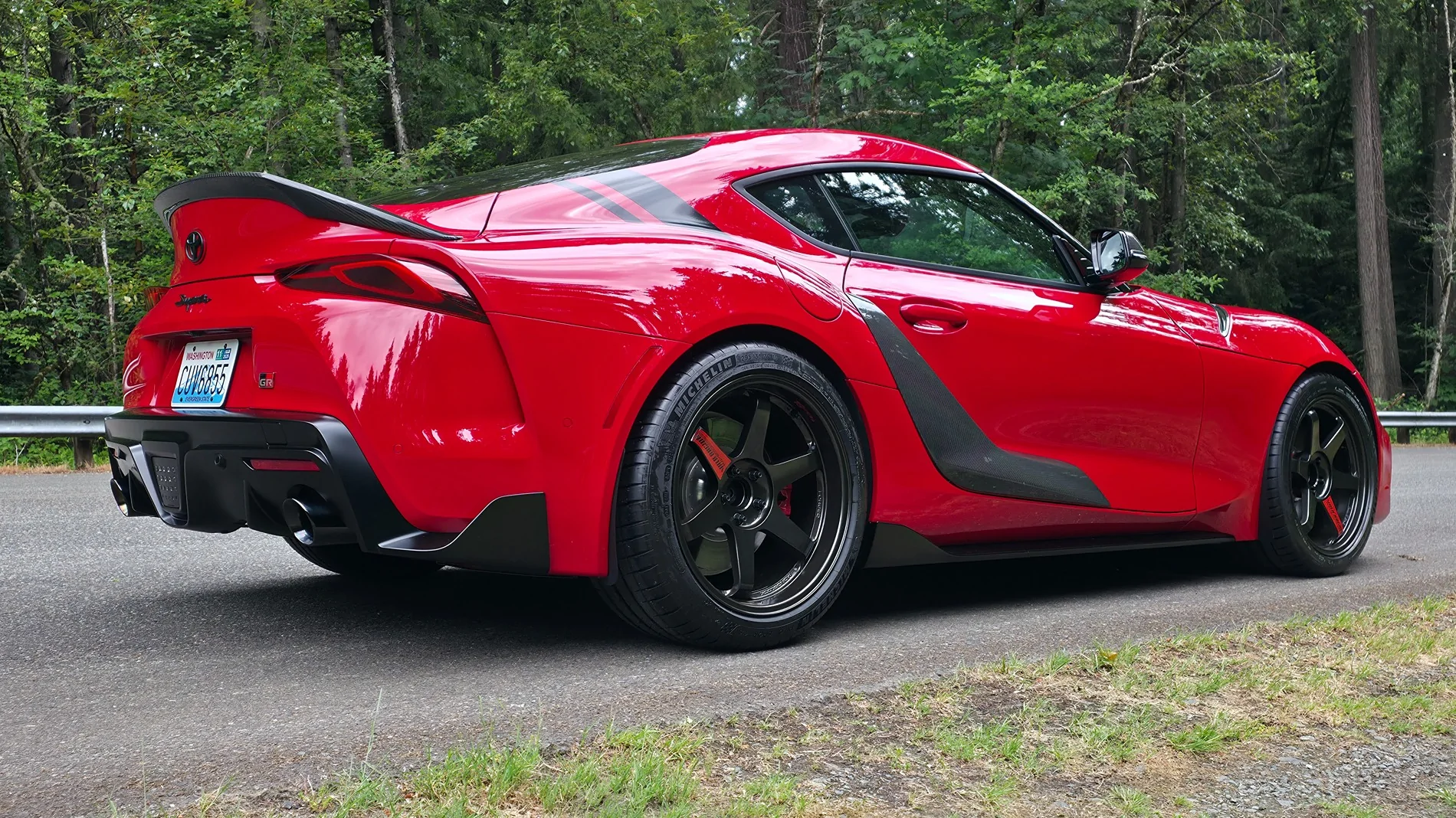

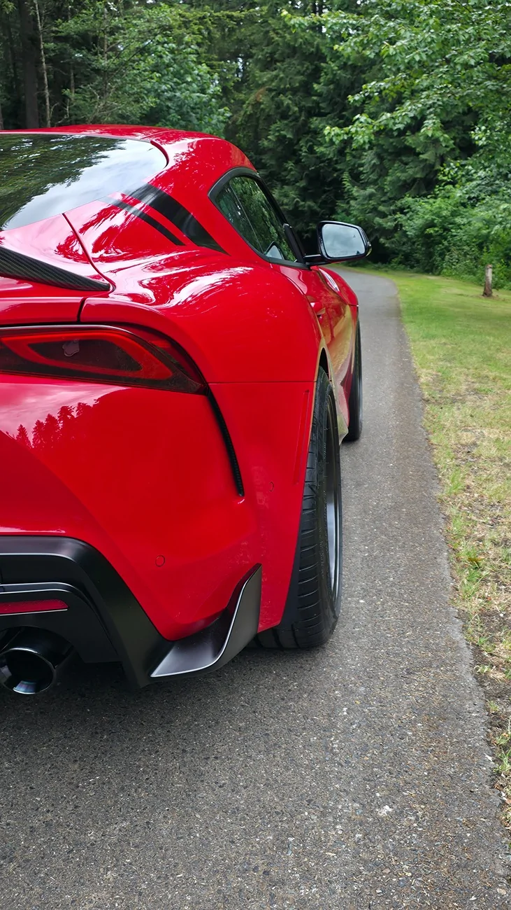

Got mine installed today. PS4S in 275/35 and 295/35. As was mentioned since the sidewall is a little taller on the rear there is a little more stretch in the back vs the front. Probably 265/35 would stretch it enough to match the 295/35 rear if that is important to you. I wanted to match the increase in width front and back so I went with the 275s.
I also put 12mm spacers on the rear to get a bit of poke (had them lying around), might drop it to a 7 as it is a bit aggressive, but who knows for now it looks great and no rub at stock height.

Well not exactly. While they are 'supra spec' when you run the numbers the fronts move an extra 5mm further out than the rears vs OEM wheels
9 +32 > 9.5 +22 = outside edge is 16mm further
10 +40 > 10.5 +35 = outside edge is 11mm further
So to technically have them match the OEM placement in the fenders the rear needs an extra 5mm spacer (front has moved out farther than the rears). The SLs come with a slightly lower offset in the front, most aftermarket supra spec wheels usually have a +25 front on a 9.5 so the fronts are a little further out. But anyways, I just had the 12's sitting here and I did fit them up without and since there's a touch of stretch on the rears they were a bit sunken vs the front so the spacers went on
