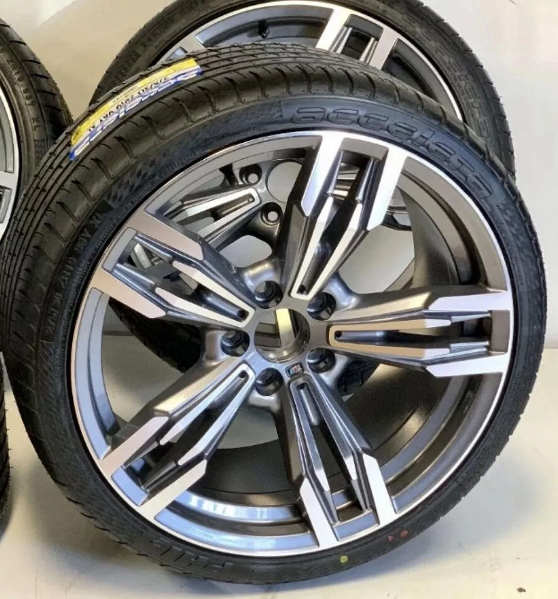

I really like these bmw wheels (M2) 5x120 pictured below and think they would look great on the Supra in a staggered 20ā€ with the machined face and grey inset.
Iā€™m just not a big fan of the black wheel and barrel the Supra offers.
