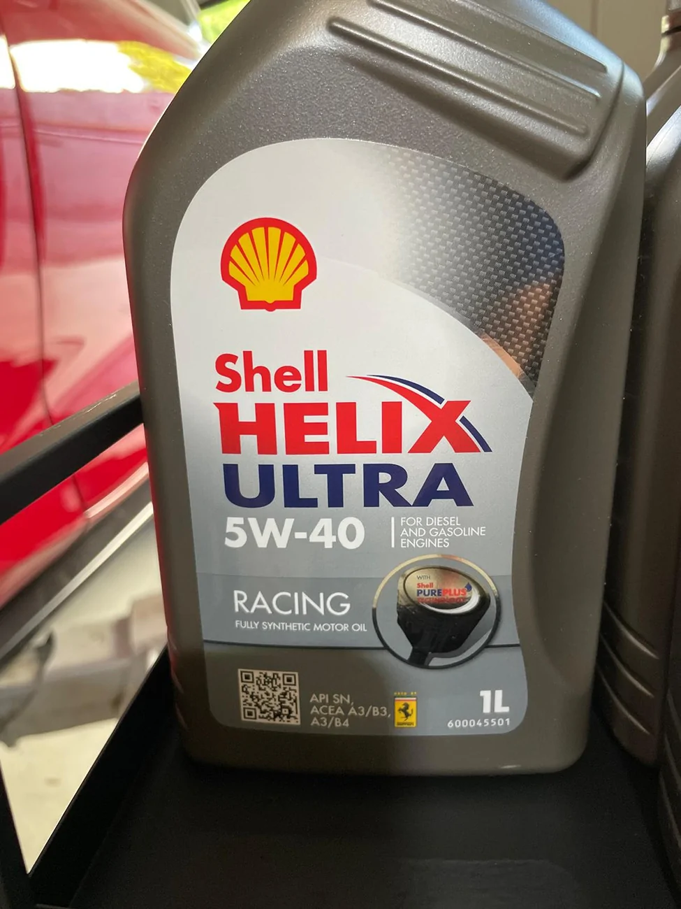

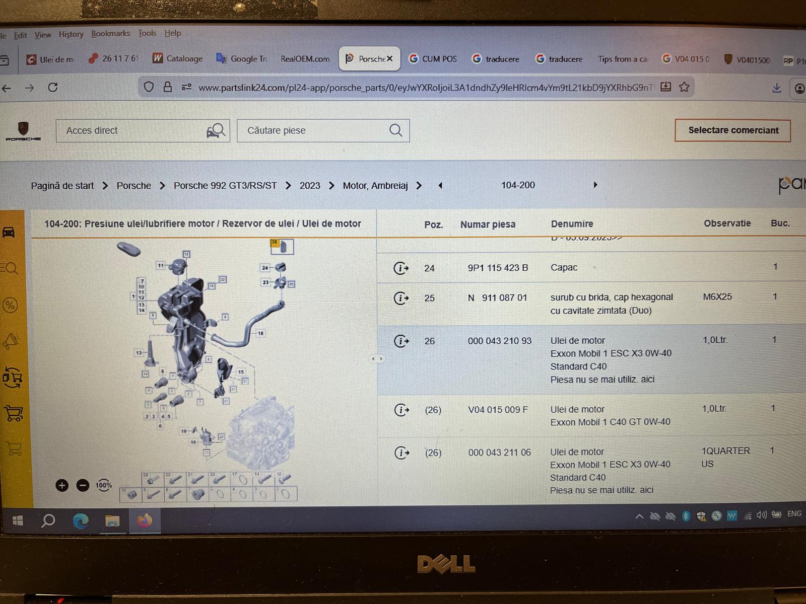

Anyway, I wanted to open the discussion about oils. When I had OPF, I used Mobil1 0W40 ESP X3 because it is compatible with OPF, it is used in all Porsches with OPF, both normal and high-performance 911 Turbo S, GT3, GT3 RS, so it is a super oil, I used it for about 30,000km in very harsh operating conditions and it is ok. Since 2025, ESP X3 no longer exists, it is replaced by X4, but Porsche now uses the new racing oil Mobil1 0W40 C40 GT. Now I have canceled OPF and I can use an even more racing oil that is not compatible with OPF, I use Shell Helix Ultra 5W40 RACING which is the official Ferrari oil, it has the Ferrari logo on it, which is a big deal, it is approved by Ferrari and is used by the most high-performance Ferraris, including the SF 90 xx which has 1030 HP with the hybrid system, so for the Supra it is more than necessary. Neither Mobil nor the Shell I told you about have prohibitive prices. I change the engine oil every 2-3000km, the gearbox every 50,000km (ZF lifeguard 8 oil), the differential every 12-15,000km, the spark plugs every 20,000km. Never use what they recommend 0W20.

The oil discussion has moved to Ferrari approved racing oil. It’s something new at least.
