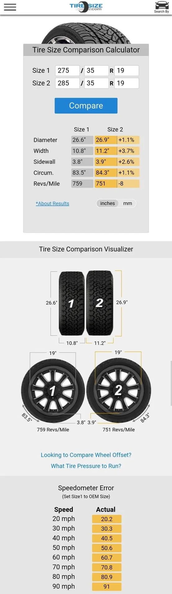

I think you should have gone 285/30/19s instead of 285/35/19s. The 285/30 would be close to OEM tire diameter. While the 285/35 would increase tire diameter would decrease revolutions per mile compared to the OEM sizes. Which in turn will change acceleration due to gearing of the vehicle. Tell me how I know I did something similar when I had a M3 and the car acceleration was slower. Also I have a FJ Cruiser stock came with 31 inch tires and am running 37 inch tires now that's a huge change in acceleration. To change this you would have to play with gears or change to a lower profile tire or increase power. Besides that the the speedometer will be off a few mph. Once you start playing with tires sizes away from factory spec tested tires sizes you will always alter the vehicles dynamics.
No do not do this. 285/35 is closer to stock than 285/30.

The speedometer already reads slightly fast by a couple MPH. By switching to a slightly larger diameter rear tire it would actually make the speedo more accurate.
