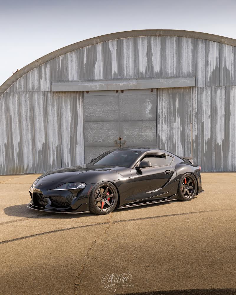

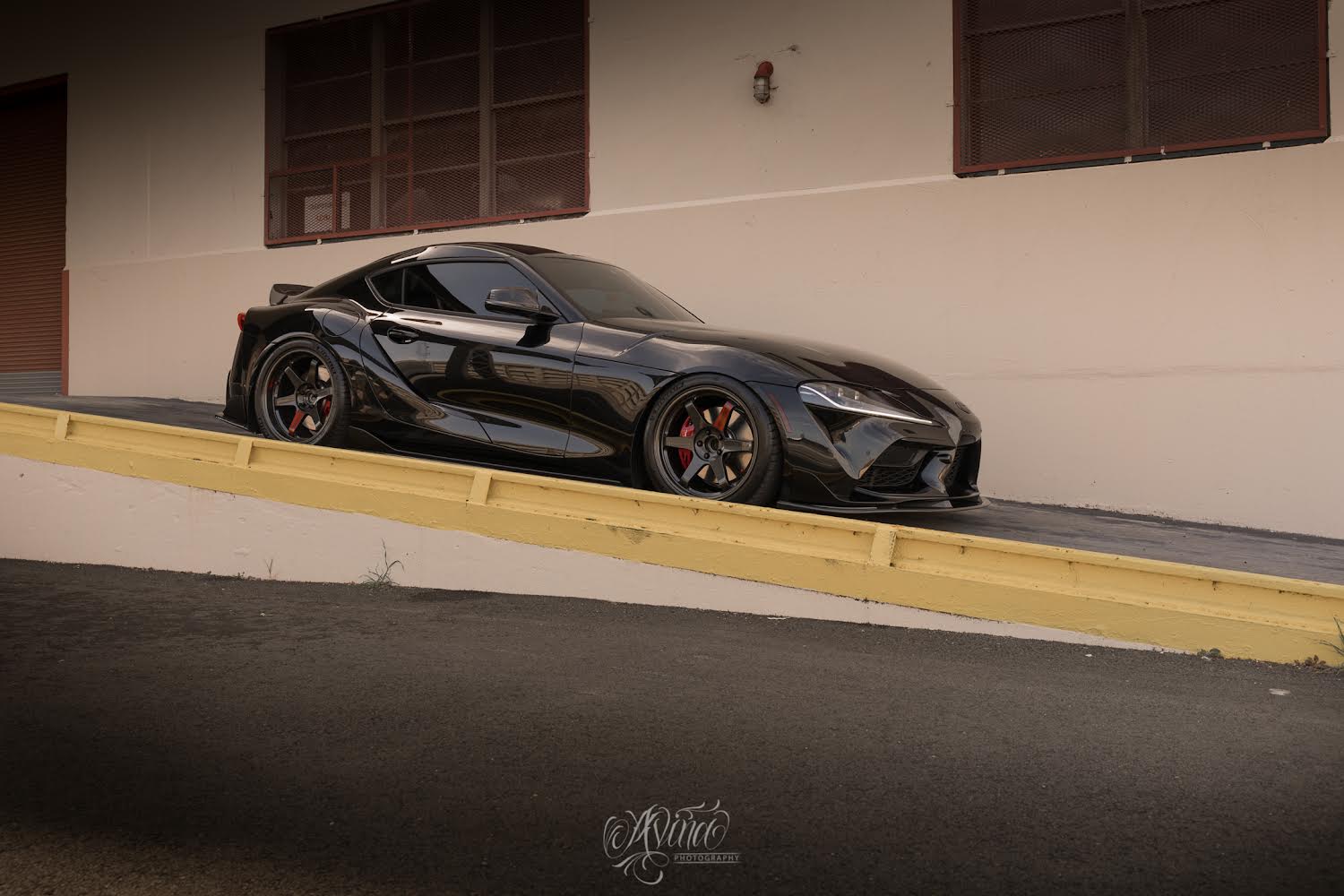

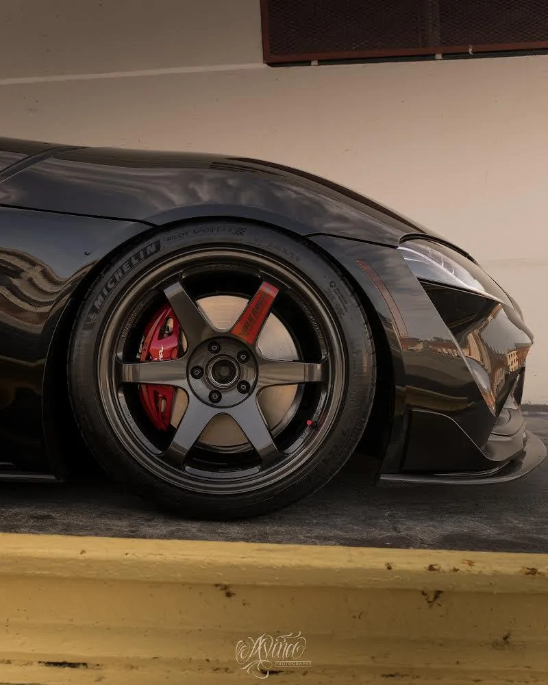

Ig: @_thicmkv im running 265/35/19 up front and 305/30/19 in the rear im slammed on Bc racing extreme low with the swift spring upgrade I have absolutely no rubbing in the rear but since I am slammed I slightly rub the inside plastic in the front but its not bad at all!
