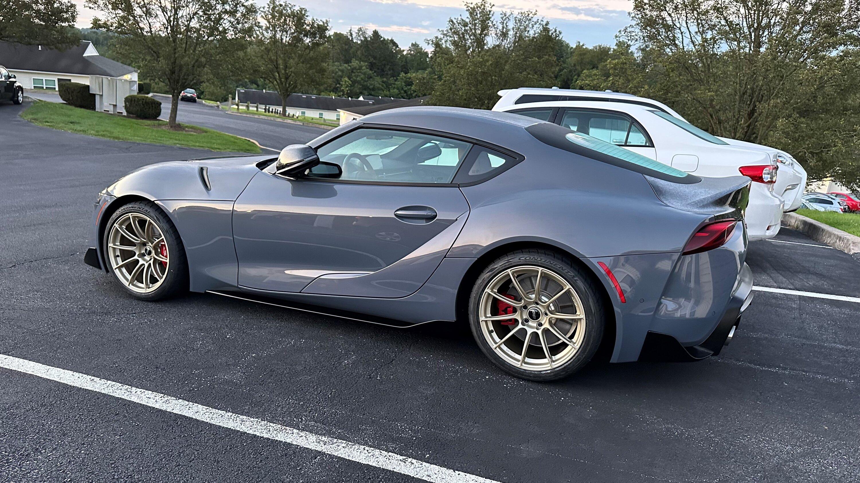

I went Apex for 3 main reasons. Wheel was wider, lighter despite being wider, and the warranty. Price was about the same thanks to a group buy so that really wasn't a factor at the moment and not sure how retail prices stack up at the moment. On top of that Apex has more wheel and color options which helps make the car a bit more unique. 0lbs difference from stock '23 set was great too. HKS HAS to make it fit up front.
SM-10RS 18x11 +40 Motorsport Gold 19lbs.
Continental ECF 295/30/18 (no 35 profile available)
