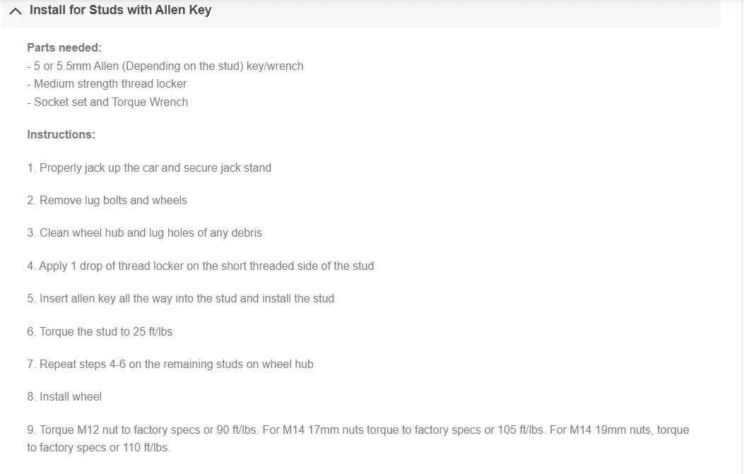

I bought the Mevius wheels studs and installed them. I have them torqued to 25 ft/lbs.
Does anyone know what the torque specs should be for the lug nuts that follow? Thanks in advance.

So 101 ft/lbs? Also, yes I did. Deep cleaned the threads and followed up with Loctite

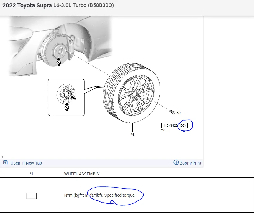

If you were referring to the studs getting torqued down I do believe it was like 25-29ft lbs for those but don't recall exactly what they were.
Here are the lug nut/bolt torque recommendation. I just do 105
