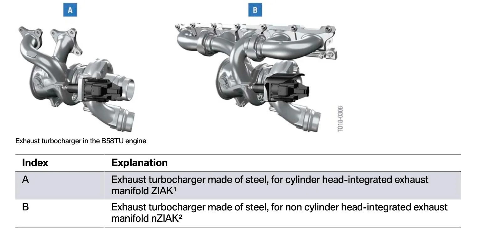

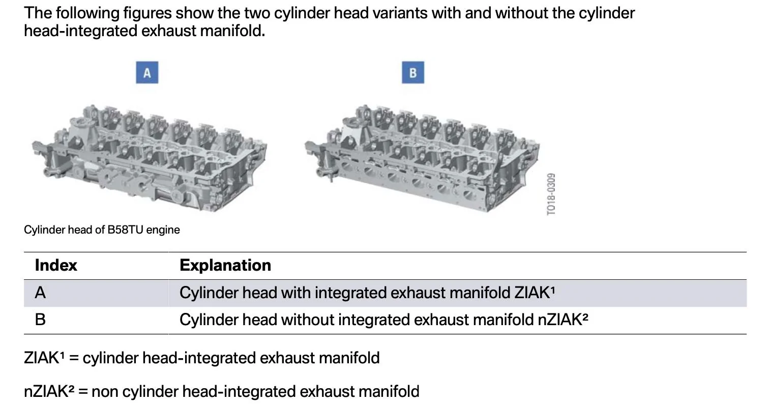

Aluminium is lighter than steel. Internal manifold is aluminium alloy of the engine block, vs the steel of the exhaust manifold.
As mentioned, I can't be sure about the flow, since to me it purely depends on the piping design of the internal manifold vs the steel manifold. Same size connections from cylinder to manifold and from manifold to turbo. B58M1 is an improvement over the B58M0 with more power, adding an exhaust flow restriction seems like an odd decision.
Ae you kidding me?
The "aluminum manifold" is simply part of the Supra's head casting! Any difference in the weight of those two head casting is minuscule!
Get a mechanical engineering degree like the one I've held since 1986 and you'll be certain that the 6 port head/manifold flow far more efficiently than the 2 port arrangement. And why would BMW bother specifying the 6 port arrangement for it's more powerful variants if it didn't? Would they intentionally spend more money for less performance?

Ae you kidding me?
The "aluminum manifold" is simply part of the Supra's head casting! And difference in the weight of those two head casting is minuscule!
No offense. But this is the internet and by saying you are a retired mechanical engineer bears no weight without any proof. Personally by having to resort to this to back your statements of opinion, I question the credentials further as you are not able to support your statement with clear logic.
As I mentioned before. I believe the 6 port configuration for more powerful applications is for the stronger steel exhaust manifold to handle higher pressure and thermal load. I.e. can be tuned harder.
The 2 port does not replace the 6 port... obviously it is still a 6 port with one for each cylinder. It just has the manifold integrated in the engine block. The flow is purely a comparison of the design of this internal manifold vs the external one. I don't profess to know which flow is better, but I am certainly not going to be convinced by "it just is" from random dude on the internet. Especially since there are other B58 models with the 6 port that generates lower performance.

Can you SEE the difference in the two configurations?
The head with the integrated exhaust ports forces the exhaust stream to make sharp bends prior to exiting the head into the 2 port exhaust manifold, thereby restricting flow. The six port head doesn't. As such, the 6 port's flow stream is much smoother, less restrictive and therefore more efficient.
And what do you mean by "stronger steel manifold?"
The 6 port exhaust manifold it STEEL!
Can you show me cases where the 6 port manifolds are breaking?
I think there are some reading/comprehension/confusion issues:
Once again, can't see the internal piping of the internal manifold in the picture, so it isn't as cut and dry as you mentioned. Once again, my original post was not about exhaust flow.
Once again yes, by stronger steel I mean the external exhaust manifold. The aluminium alloy engine block internal manifold is not as strong. Once again, I said this is why I believe the 6 port configuration is for more powerful applications.
No, there are no cases showing breaking manifolds because ^^^.
I can see both sides of the coin... I am not saying one is better or worse, I can see why they designed each engine the way they did and the advantages and disadvantages of the differences. Please read through my posts carefully, I am attempting to discuss not argue, "why my dad is better than your dad".

Sudden bends in an exhaust system [as is the case with 2020 Supra engine] are inefficient because they compromise gas momentum and introduce turbulence. As such, the K (total resistance) factor increases, which means less efficient flow:
https://www.pipeflowcalculations.com/pipe-valve-fitting-flow/compressible-gas-flow.xhtml
Gradual bends are always preferable, assuming packaging constraints (e.g., available engine compartment space) permit. Gradual bends combined with idealized length/diameter ratios form the basis of proper exhaust (and intake) system design.
The 2021 Supra uses the existing M340i engine (including aluminum block and steel exhaust manifold). Are you aware of a single case where that combination has proved problematic? If not, why do you continue to mention it?
Indeed, the 2020 Supra engine also uses an aluminum block and steel exhaust manifold.
