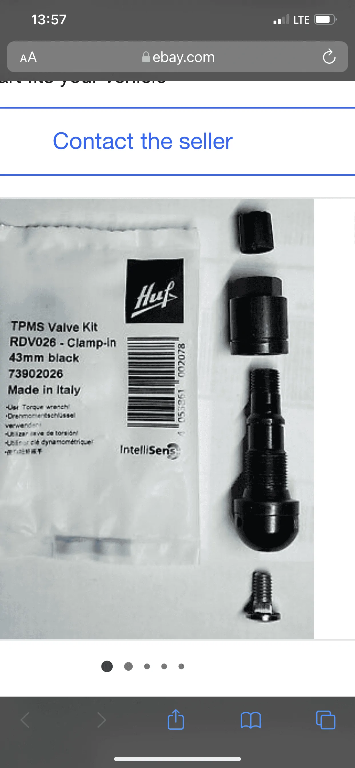

Yes, OEM will work. I'm using the OEM TPMS on my TE's. Only thing I did was switch the valve stem with black stems. I used the same brand valve as OEM when I did it. I did the black valve for aesthetic reasons.

This is what I did. Tires must be removed. I just had the tire shop do all the work. I put different tires on but that doesn’t make a difference.
