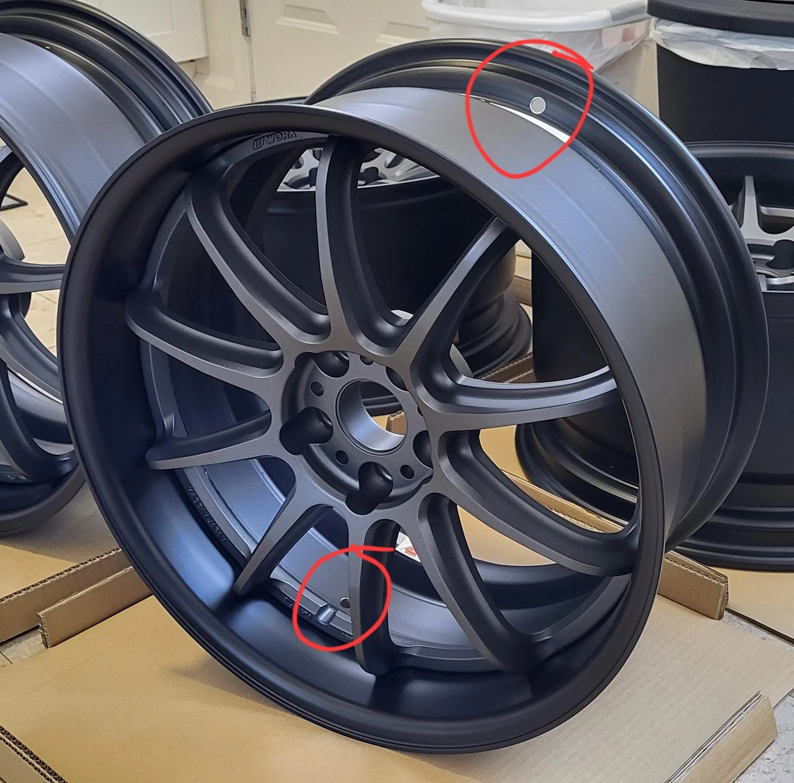

As mentioned above, a second hole can be drilled in the barrel to accommodate a TPMS sensor. That was done on my 2P wheels, see picture. Bottom hole is for 90* valve stem, top is for TPMS.
