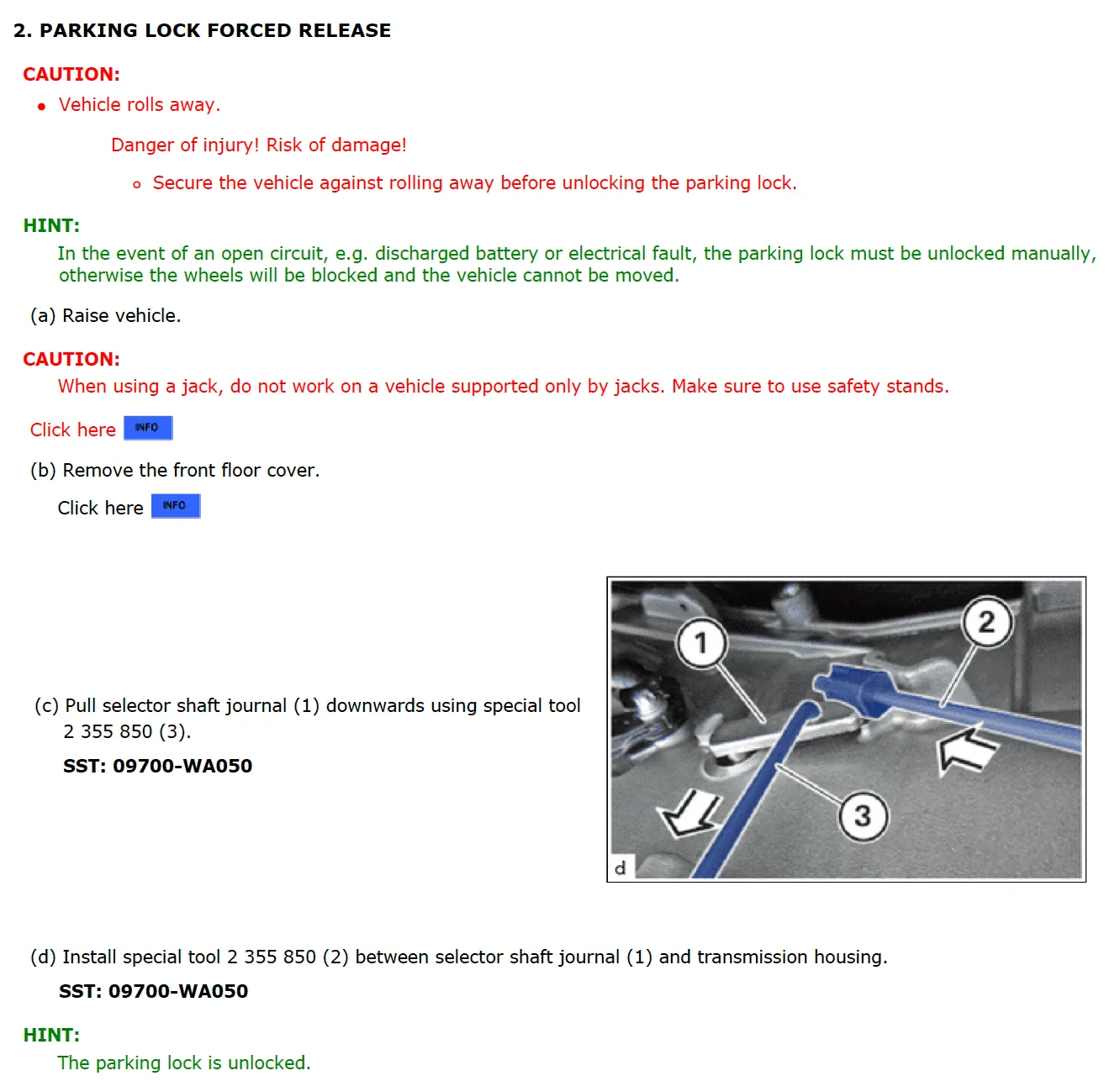

Hi Trackers,
how do you winch the Supra onto the trailer with the auto gearbox?
(Not being able to put it in N with the contact off?)
8,806
17,269
There is a trans brake release under the car.

That’s not doable on a trackcar which will be slightly lowered and still have the floor panelling not?
8,806
17,269
I don't even think it's doable at stock height without jacking the car up.
