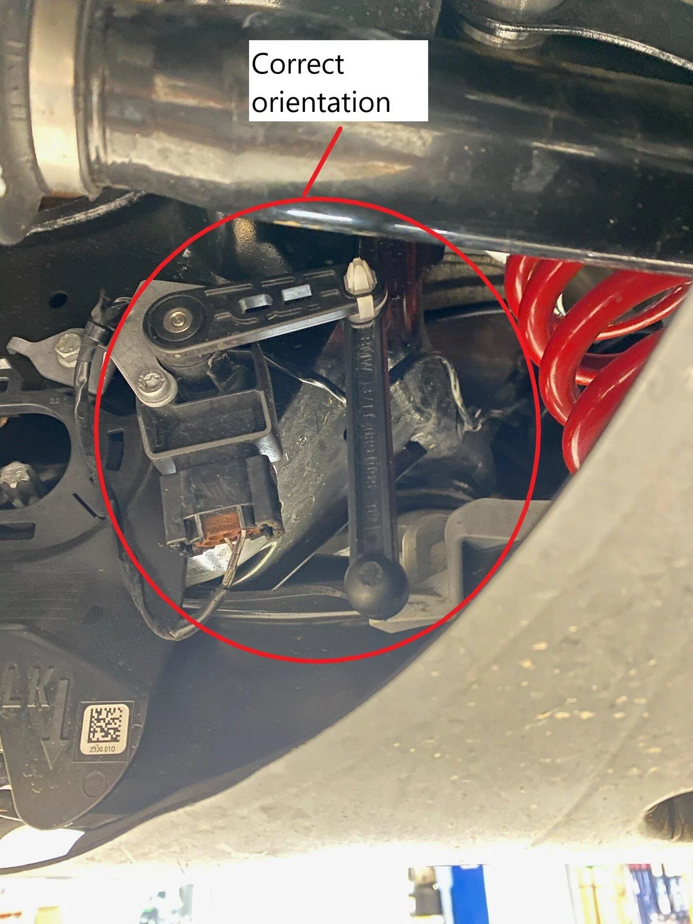

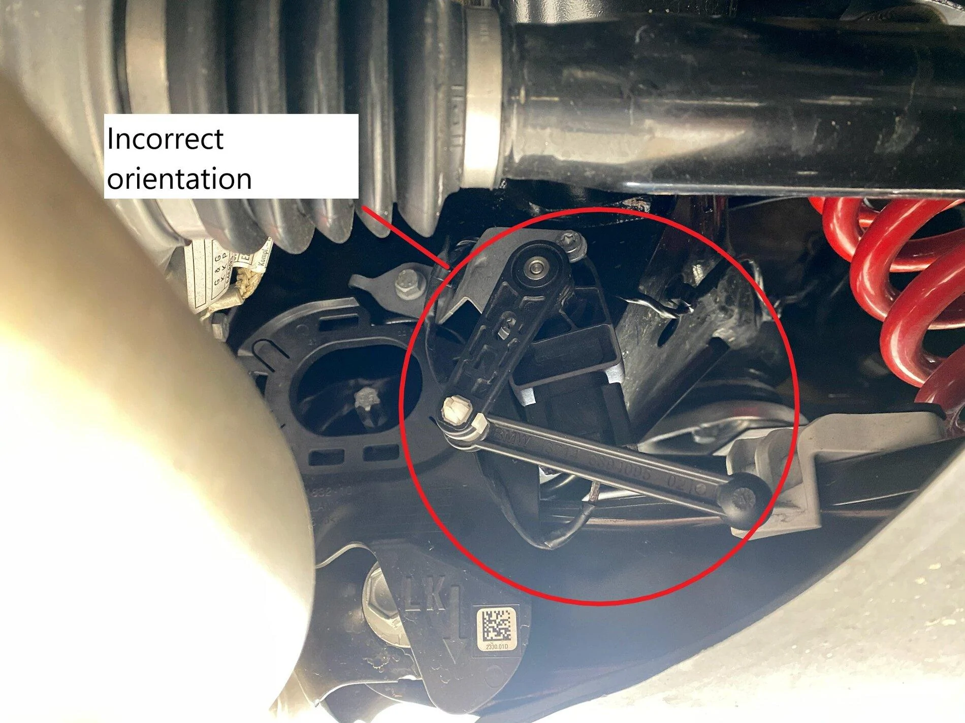

If you're lowered with SPL's Front LCA, you'll need to drill an extra hole in the 3d printed ride height bracket that came with it.
If your lights are pointed more downward than normal, that will also help with he issue, but you may also need to manually adjust them.
I would also check the rear ride height sensor and make sure it wasn't reinstalled in the wrong orientation. This will also cause your lights to point upward.

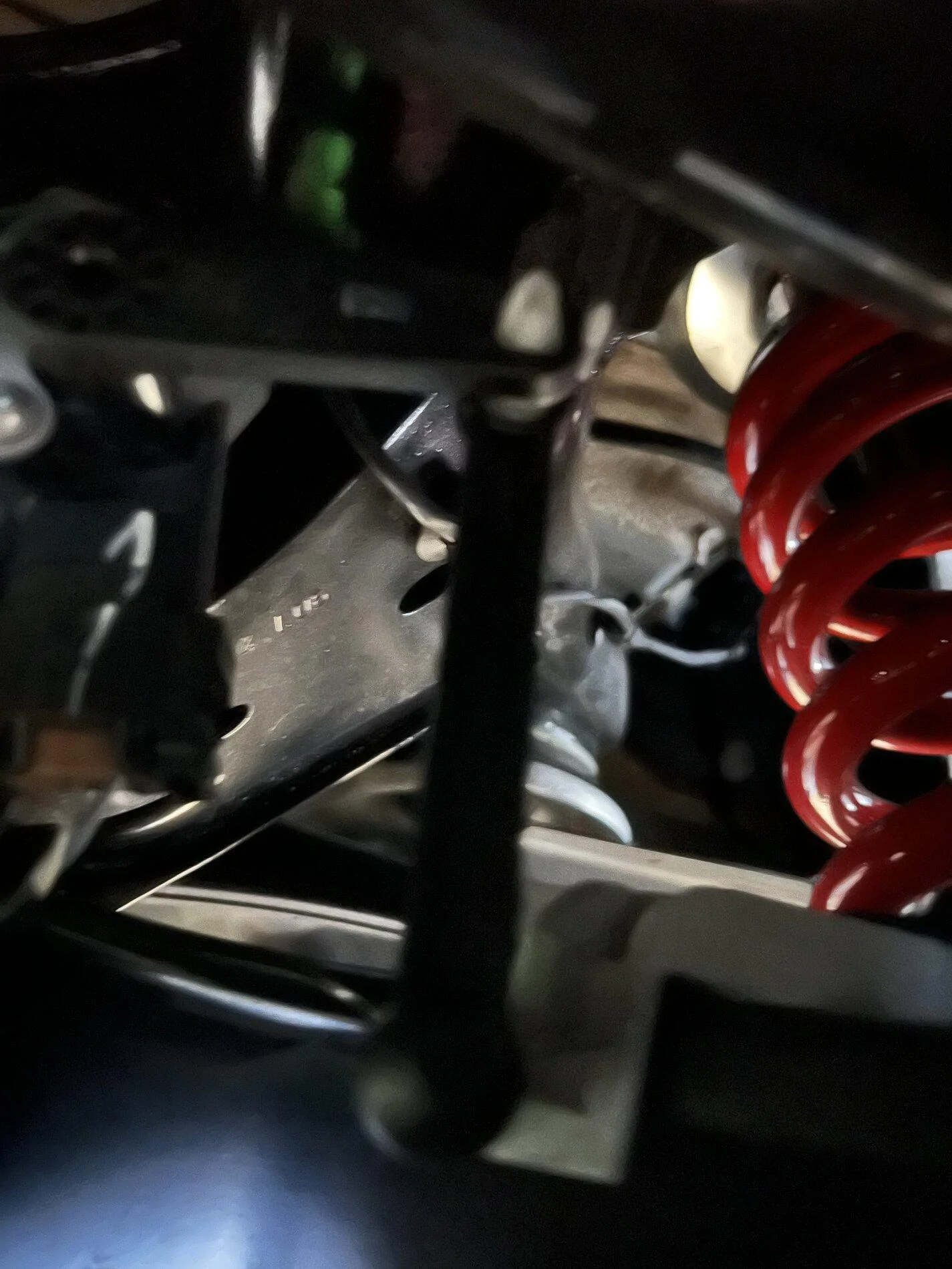

Took a shot of the rear, orientation and everything is plugged in correctly, 90 degree angle. Don’t think it’s my rear.

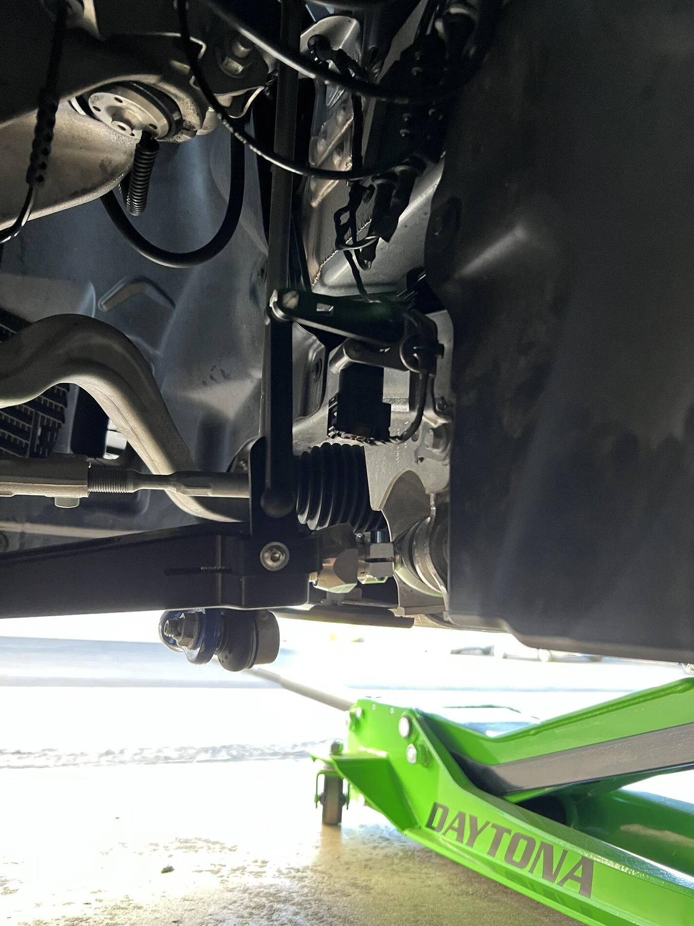

Took a shot of the front, it’s also plugged in, and installed correctly. Both are at 90 degrees
