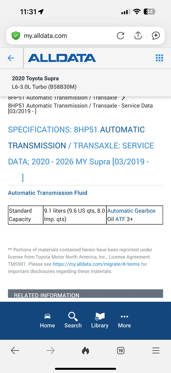

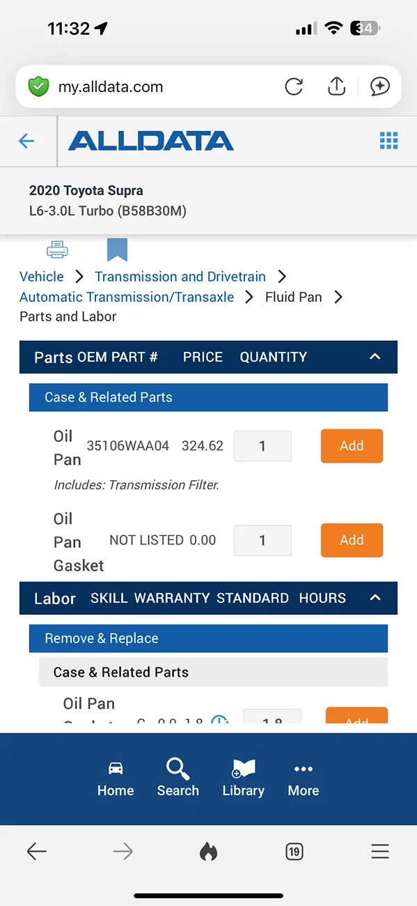

Sorry to bug! Anyone know the part number to the transmission pan and fluid ? I spent 2 hours looking on FCP Euro but there are about 3 different part numbers which give the same fitment and it trips me out I don’t want to order the wrong part
this is the kit I was looking at
https://www.fcpeuro.com/products/bmw-ga8hp45z-ga8hp70z-auto-trans-service-kit-24118612901kt
correct me if I’m wrong, I do not mind if anyone knows the oem part numbers on Toyota website:)
thank you all once again for your help, you guys are amazing.

Thanks I did see that but what’s confusing is this
https://www.fcpeuro.com/products/bmw-auto-trans-service-kit-24118743462kt1
This is a different kit and it indicates for M340 G20 for my Supra year 2020 and Z4. I’m a bit lost is there a difference ?

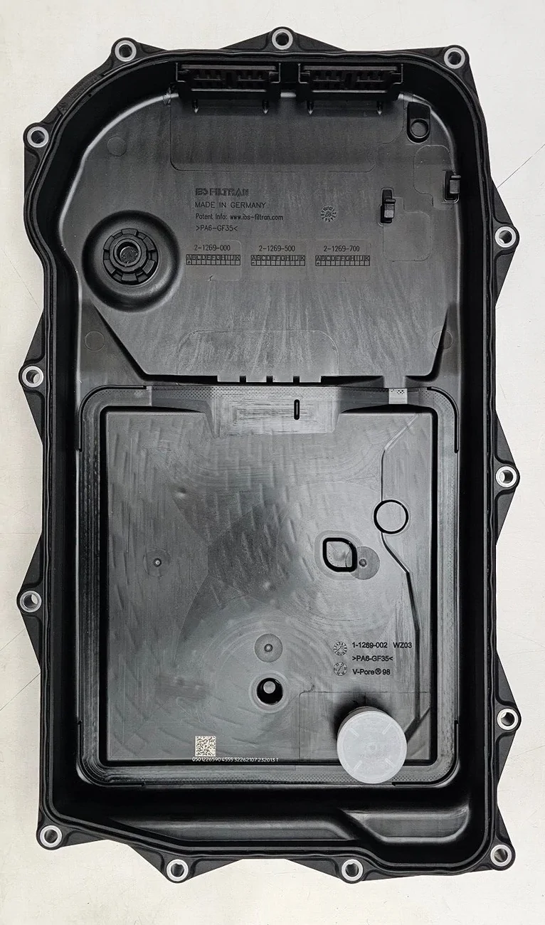

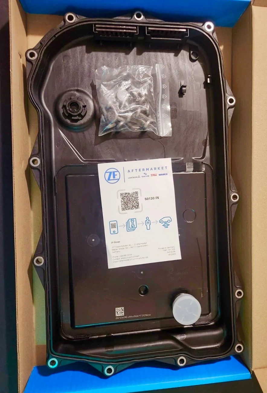

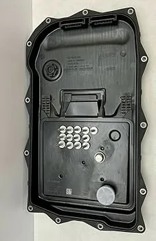

Here are a few more links to replacement transmission pans. It looks like the pan went through a design update. The Toyota part# 35106-WAA03 is just a rebranded ZF Germany pan.
Here is the OEM from my 2021, part# 24115A13115
Here is the updated one from ZF Germany, part# 24115A13115
ZF Pan Germany
And here is the ZF brand aftermarket version from Poland, Part# 1087298364
ZF Brand Poland.

This must be replaced every single time the transmission is serviced (I believe recommended at 50k miles or earlier)?
8,780
17,224
Or you can get a metal M pan and just replace the filter each fluid change.
