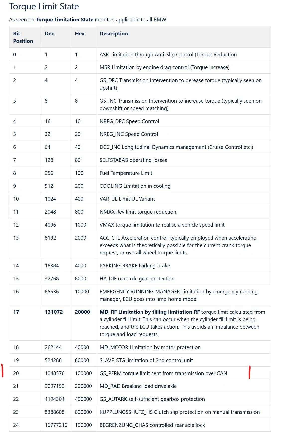

I think you are facing the same problem as me.
The fault code you mentioned comes from the TCU and is a sign of "slipping". But there is another way to analyze the problem. You use MHD, so you can also log. There are 2 important things in this log. The first is the "Torque Limiter Status" - which will show you 1048576 what the limit means.

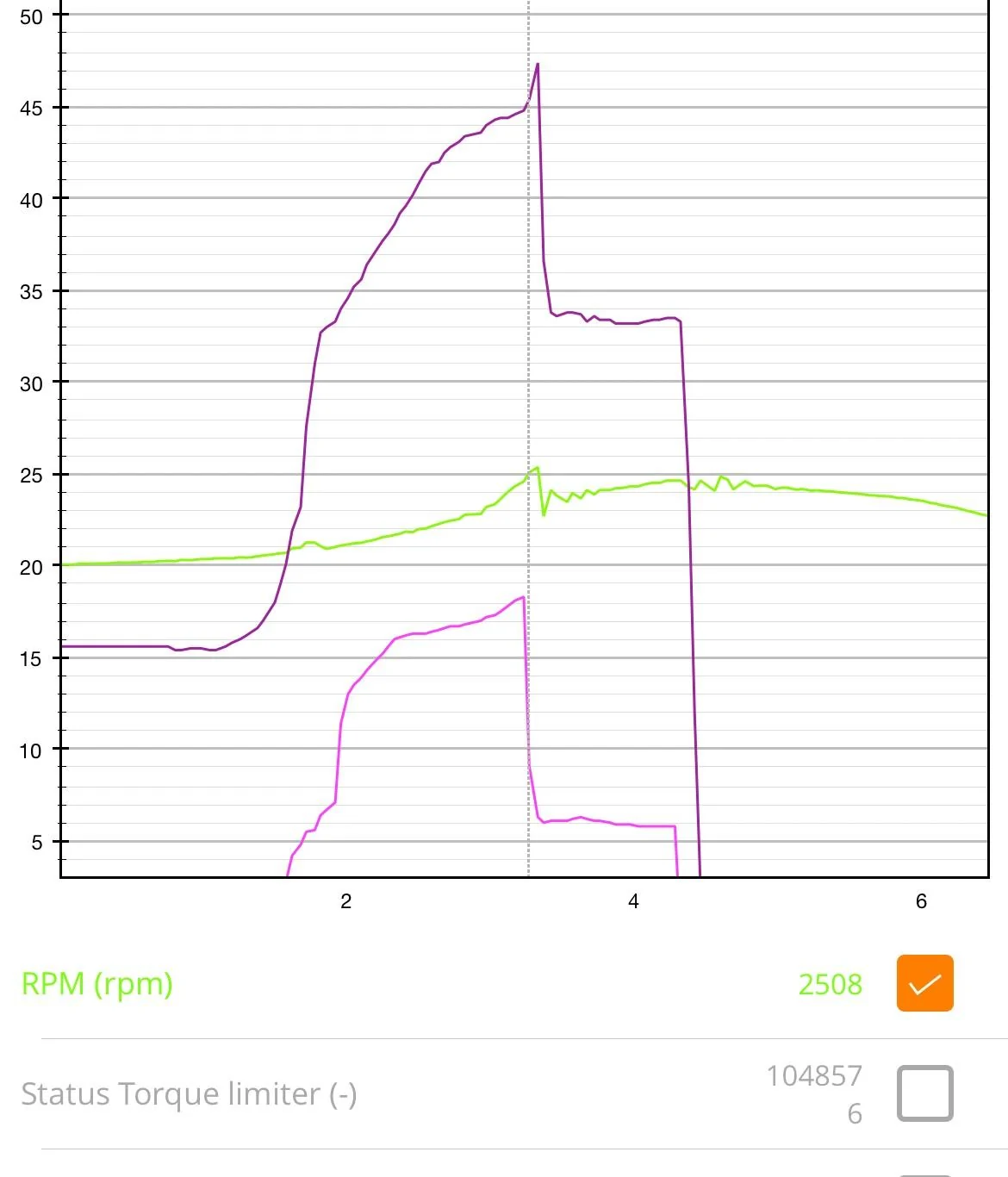

As you can see in my screenshot, before it happens the RPM starts to increase faster (sign of slip) and then the limit kicks in.
At this point I have torque in the 650-700Nm range but DME has only reported 450Nm. When the value was increased to 600Nm the problem went away.
