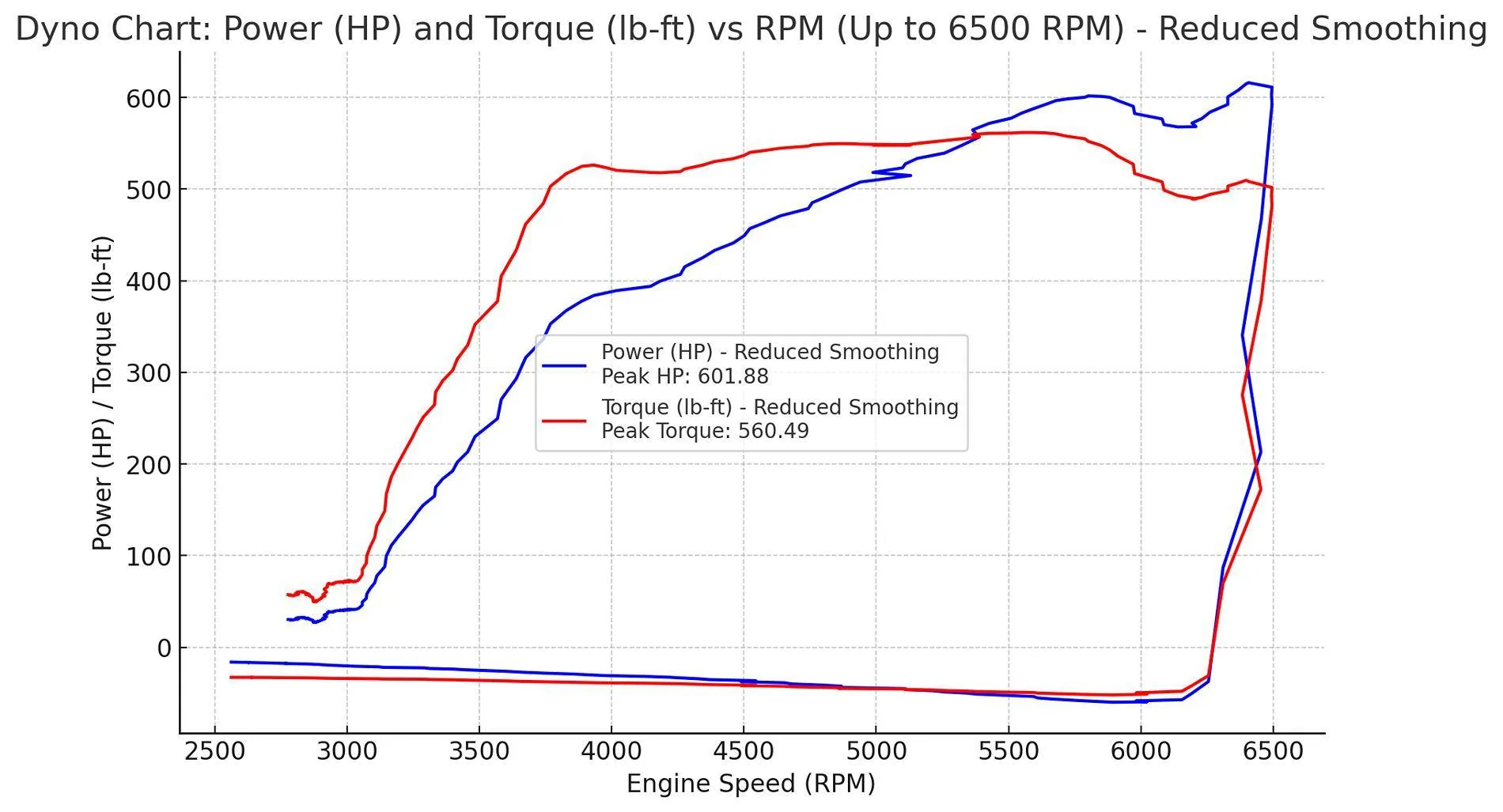

For shits and giggles I uploaded logs into ChatGPT and asked it to provide a graph for tq and hp, results were 622hp and 559tq.

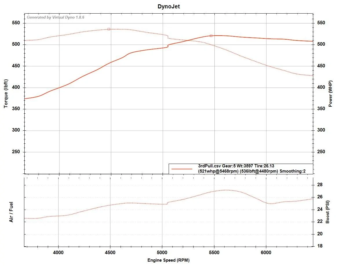

If ChatGPT is referencing torque in the datalog to create the chart, it will be most likely be off as the torque Nm in the log is usually skewed by the model in the DME as you tune. It also doesn't take into account weight, tire diameter and drag.
For reference I put a log through ChatGPT and also through vdyno software which creates power charts from speed data instead and use tire diameter, weight and drag inputs. From my experience using vdyno and a real dyno, vdyno can be very accurate as long as you use a flat road and set it up correctly.
You can see here that the ChatGPT chart is wildly optimistic because it is using the Torque Nm in the log to create the plot. ;)
ChatGPT:
VirtualDyno:
ChatGPT:
VirtualDyno:
That’s the one issue I had in the back of my mind with it using the torque reported in MHD. It is smart enough, after I told it, to convert the NM to Lb-Ft. I fun messing with the ai and trying to get it to understand my questions and reforming my questions so it can understand what I want. I will ask it to take into account vehicle weight and tire diameter.
