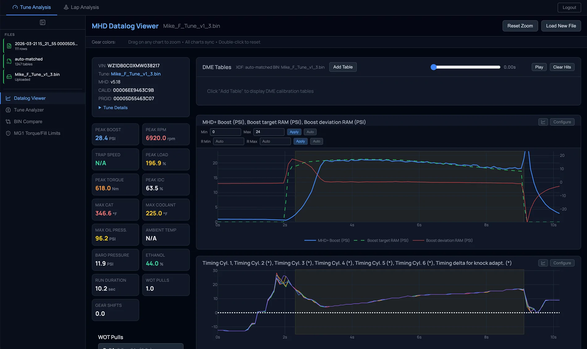

I've been working on building a Datalog and tune analyzation tool for myself based on what I find lacking from other tools.
Still in early stages but it's already proving to be super helpful.
Some features:
1. Visualize datalog with peak numbers, visual representation of WOT sections (great for track logs), visual representation of gear, etc
2. Trace feature on datalog. Load datalog, load XDF file, load BIN file and then you can scrub over a datalog and it will trace it in the selected DME table.
3. Tune analyzer which shows you any Torque or Fill Limits in the log and shows which DME tables effect that, and gives suggestions of changing those tables.
4. Fuel Scalar, WGDC Base, P-Gain, I-Gain, D-Gain tune analyzer that shows current table values, then offers suggestions based on the datalog loaded. For example, with Fuel Scalar, it analyzes STFT + LTFT and shows what to change on the Fuel Scalar table to get fuel trims closer to zero.
The peak numbers are handy to quickly see max values from the datalog. Example, in this track datalog, I went WOT 52 times in a 21 minute track session. :cool:
Quickly see WOT sections of the datalog with visual representation:
Visual color for each gear:
DME table cell tracing. Scrub over a datalog and it will trace it values in any DME table:
Fill and Torque limits found in a datalog, which limits, what they are, and what tables to modify, with suggestions:
DME table analyzation from datalog and suggestions:

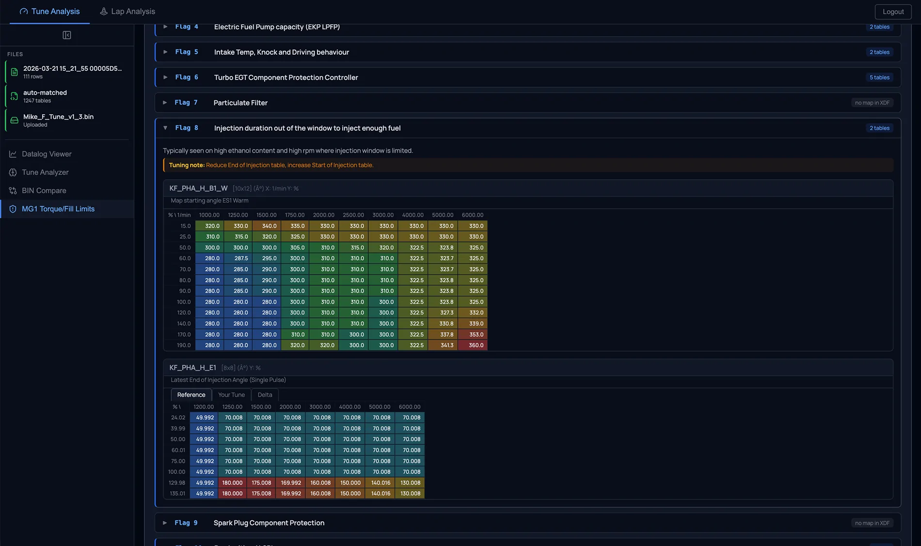

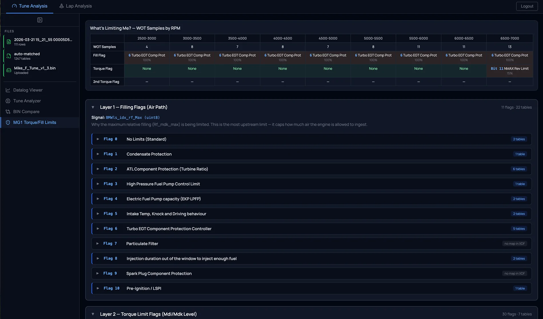

Been updating a bunch of stuff in the app. I cleaned up the MG1 Torque/Fill Limits section with more accurate descriptions AND the tables that should be modified that trigger the Fill/Torque Flags.
I also added a section, if you have a log loaded, it will show you what limit is happening at what RPM. Filling Flag descriptions/tables are updated. I'm now working on the Torque Flag descriptions/tables. Also:
  • Overall layout changes
  • You can now customize the min/max of the axis plots in the Datalog Viewer
  • Tune Analyzer "Tune Health" section has also been updated to show which Fill/Torque limits are triggered, if any

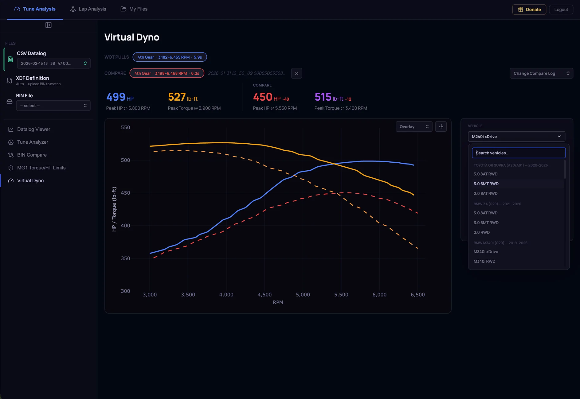

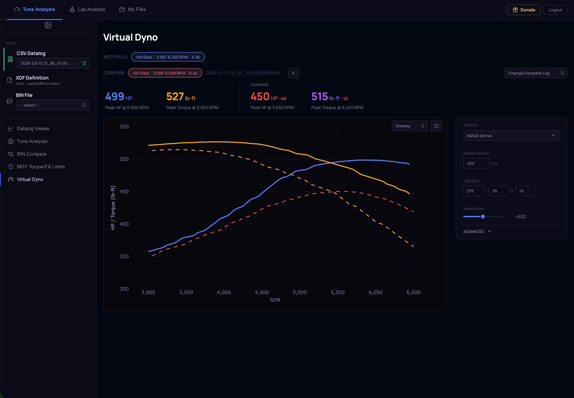

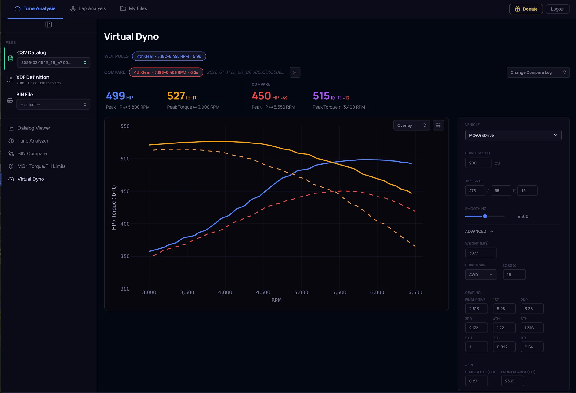

This is the last update I will make here around the app I am working on because it's time I start dedicated thread for it.
However, quick update. I'm working on a virtual dyno that you can run your logs through. It uses the same strategy that vdyno and others use. Great for before/after.
I also made it a bit more user friendly with a bunch of vehicle presets so you just select the appropriate vehicle, add your own weight, current tire size and there you go. No messing with gear ratios, etc. However, if you do want to tweak more advanced inputs, that is available as well.
