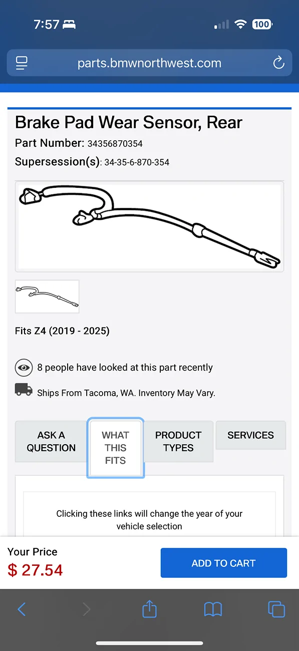

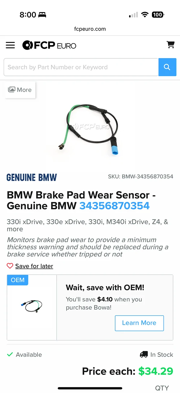

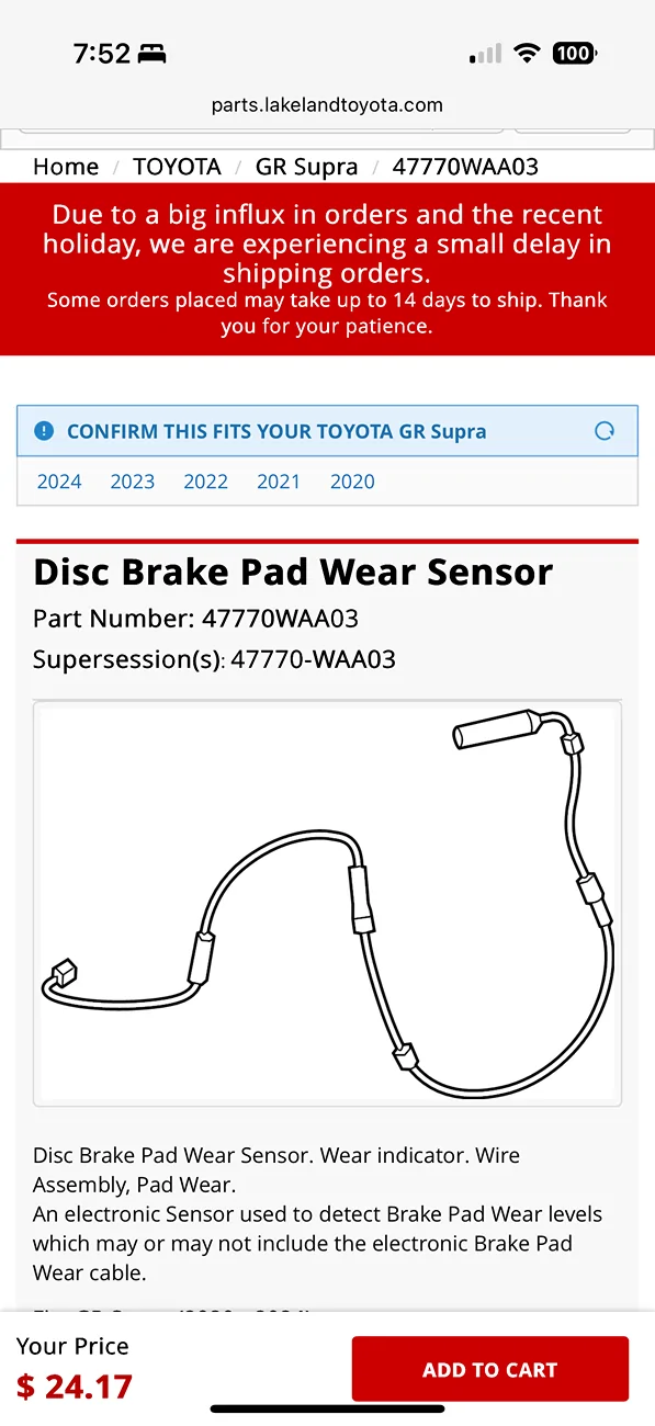

Does anyone know the bmw part number for the rear brake sensor? Or if FCP euro carries it? Got the front from there. Need a rear. Or are they the same part front and rear?
These should be the Toyota and BMW part numbers. Looks like FCP Euro has them in stock in both BMW and third party versions
