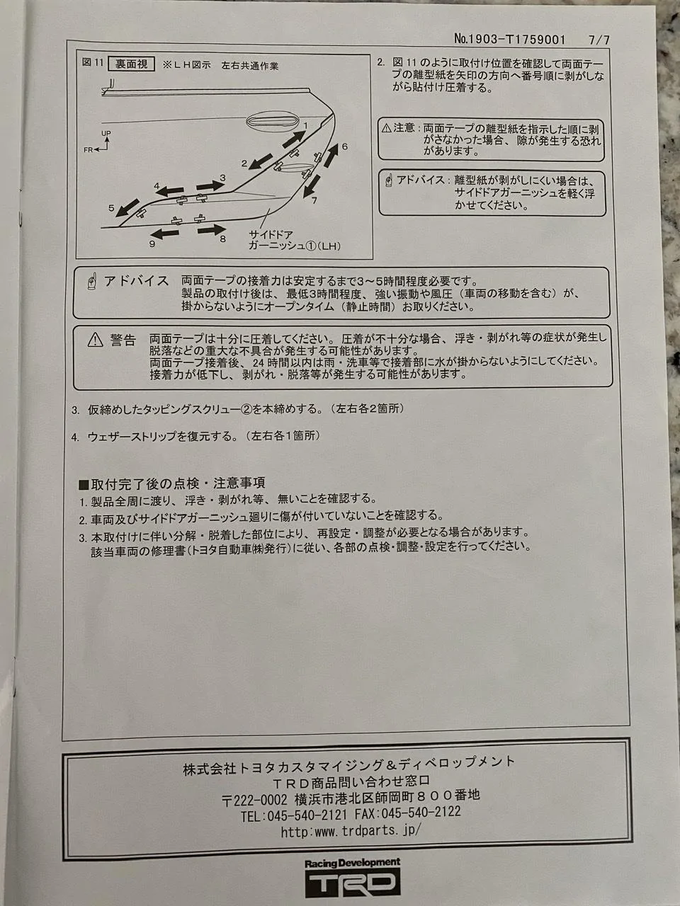

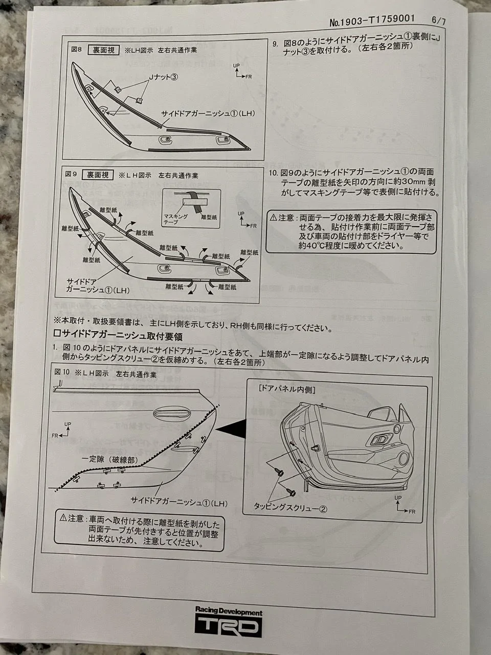

It looks as though the side garnish are simply pulled off correct? They are connected by tabs? Can you post the installation manual? Thanks!

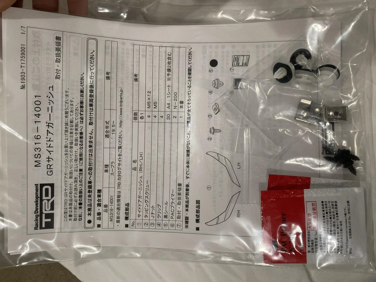

My local dealership held onto the instructions after install. Being an OEM part, although not available in the US, they were able to take care of the install for me. Under warranty too :) I do have this photo showing what came with it.

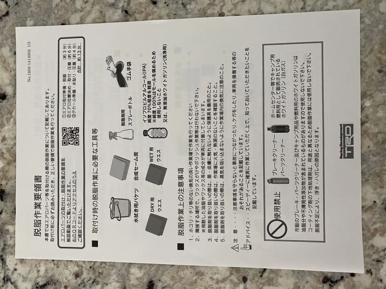

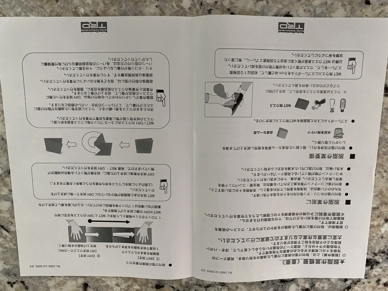

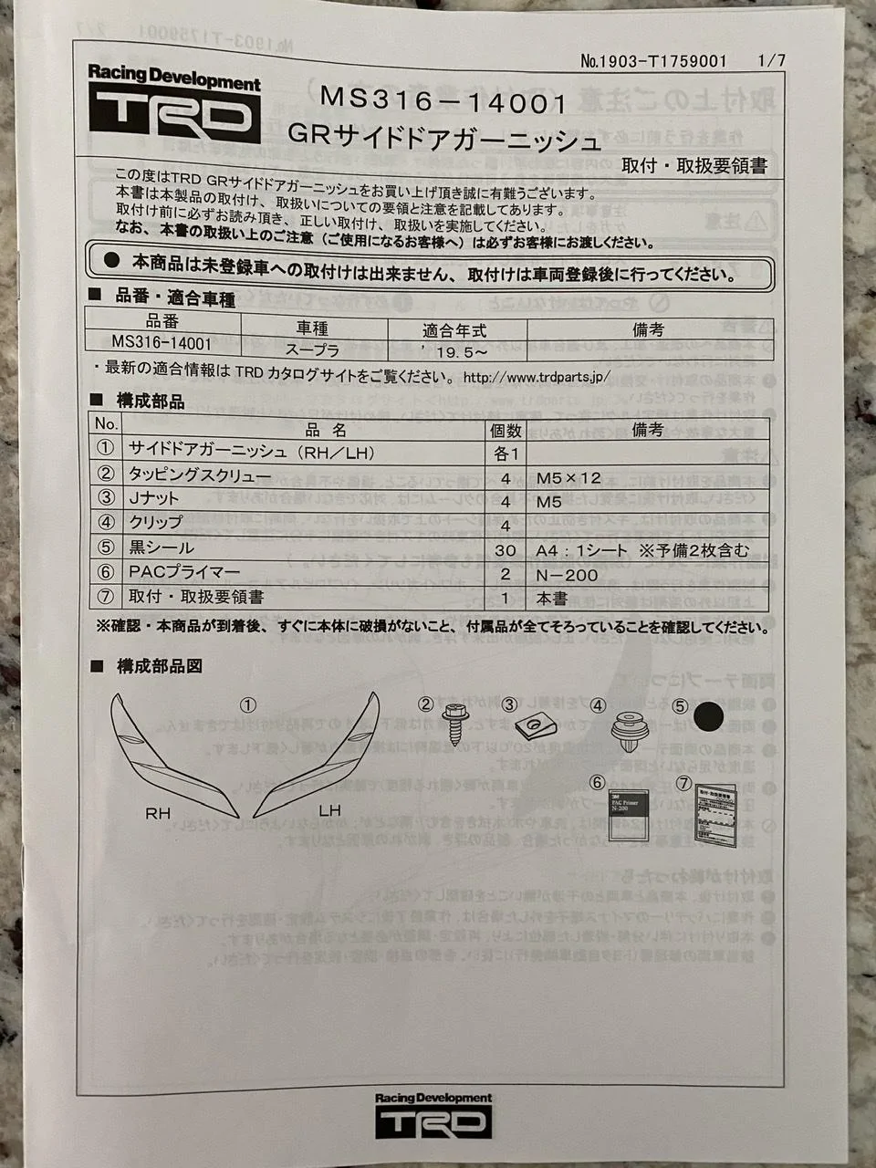

I was referring to the step-by-step illustrations in the manual.

Yeah I know lol that’s just all I’ve got right now. I’ll see if they’ve still got them at the dealership or if they’re wrapped up with the OEM garnishes they have back to me in bubble wrap

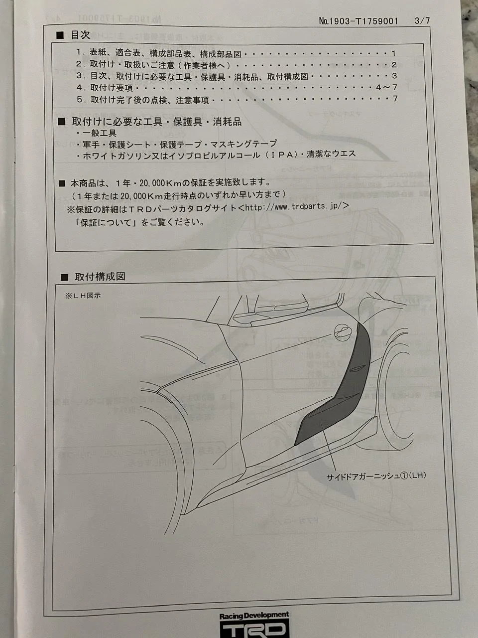

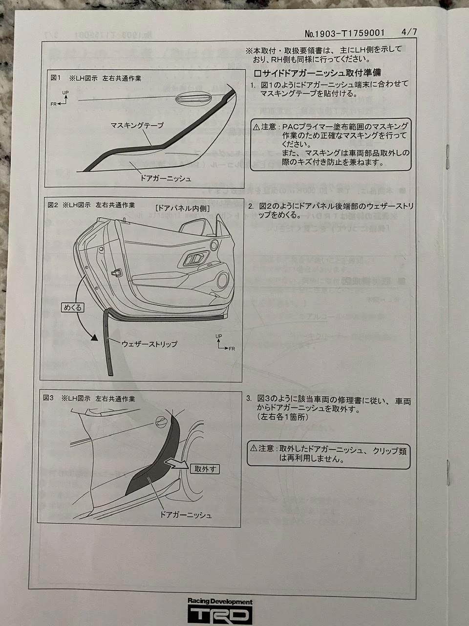

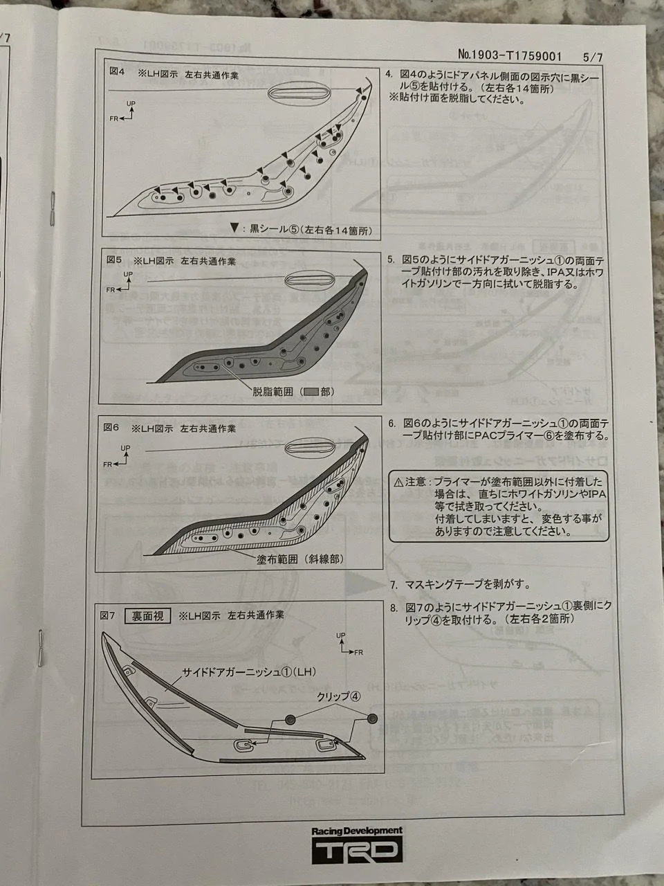

I found them! Everything was with my OEM painted garnishes. Here’s everything was came with the TRD Carbon Fiber Door Garnishes
*sorry if they’re upside down or sideways. They’re upright on my phone when I upload*

Just posting here for anyone interested - I had the TRD parts installed several months ago and translated the Japanese manuals (for the spoiler and side panels) into English so that anyone who doesn’t speak Japanese can use them for future reference (looks like OP never saw that thread). Here’s the link where the English translations are also included:

Also, for everyone’s reference, if you just go on TRD Japan’s website you can download high-quality PDF versions of the Japanese installation manuals for all of the TRD parts (these Japanese manuals also posted in that TRD parts thread linked above along with a link to the TRD website where they’re from). I only translated the manuals for the side door garnishes and rear trunk spoiler as the other ones were more straightforward.

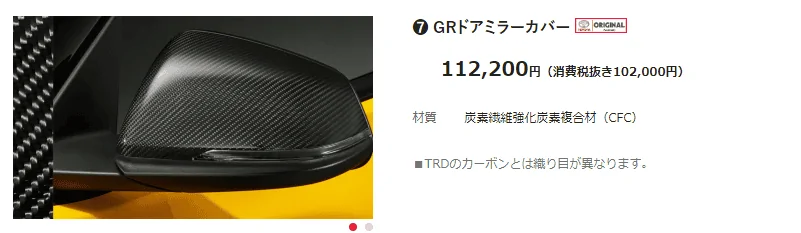

The official CF mirror caps are actually by Toyota and not TRD. This is why they’re not listed in the parts table on TRD’s website and also why they’ve been available through Toyota dealerships since the launch of the vehicle. In any event, they just snap off/on so there isn’t a similar manual for them.

What's your idea of snapping off and snapping back on? I think it requires a little more than that but if you can pry them off without snapping the tabs or breaking your glass please post a video would love to see it. Thanks! The mirror caps are TRD as well FYI. Through the dealer it's even listed under TRD parts.

The US dealers' info is actually incorrect - the carbon fiber mirror caps are Toyota parts and not TRD parts. Even Toyota Japan's website states this about the CF mirror caps - in Japanese, it says that the weave of their CF mirror caps differs from the CF of the TRD parts. (Here is the link and I'm pasting a photo of the specific item for reference.) Notice how it says "Toyota Original" above the CF mirror caps, whereas all of the other CF parts have the "TRD" logo.

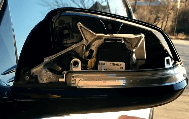

Lastly, with respect to removing/installing the mirror caps, here is a previous thread about that.

Lastly, with respect to removing/installing the mirror caps, here is a previous thread about that.;-)
That installation process on the M235i might have worked with just the pry method however, you do that on the A90 Supra I'm almost certain you will break the T tabs and break the mirror as well. The clip points are different between the two models. Look closely at the photos provided from your video link and the one I shared.

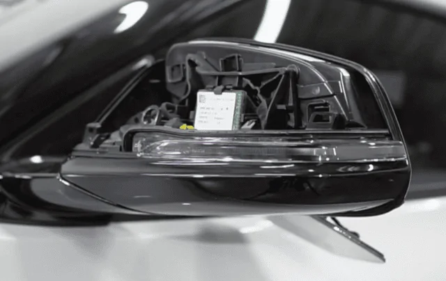

Here's the M235i mirror without cap
Here is the A90 Supra mirror without cap
T clips on the A90 mirror caps. Prying on these from the front without pinching the tabs into the mounting points first will break these tabs guaranteed. The pressure from prying with these tabs locked in place will cause the mirror to crack as well on the A90 Supra.
Just follow this and you will be fine.
