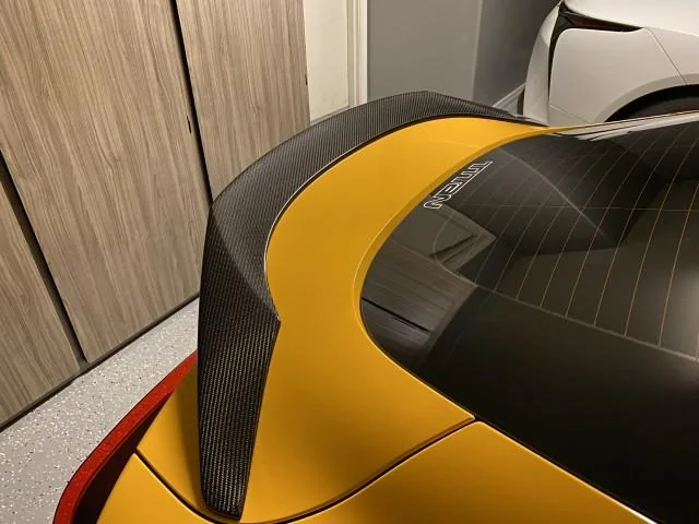

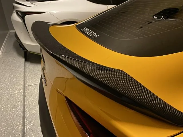

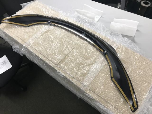

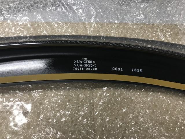

    I have been waiting on the TRD parts for the A90 ever since I saw the leaked photos from Japan of the TRD carbon aero kit for the MKV Supra. I was able to buy the TRD carbon mirror caps through a U.S. Toyota dealer however, the front lip, side skirts, rear spats and the duckbill spoiler are not available in the U.S. at this time through any Toyota dealer and/or any tuner company. Through a contact of mine I was able to privately order from Toyota in Japan direct. My first piece is the TRD carbon duckbill spoiler. It arrived last week and it was just installed on Friday.
    A friend of mine who also owns a 2020 MKV Supra ordered the Rexpeed carbon spoiler which is the same design. They obviously used the TRD spoiler to create a mold to make theirs. Heres the difference;
    Rexpeed = $450, (wet CFRP) no bolt's or drilling required. 3M adhesive tape to mount. Epoxy has a little orange peel and the carbon weave has minor imperfections but still very good.

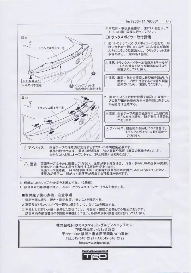

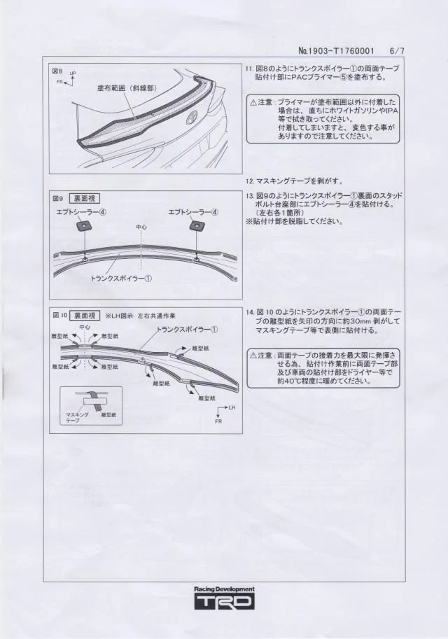

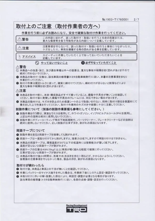

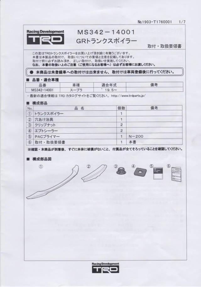

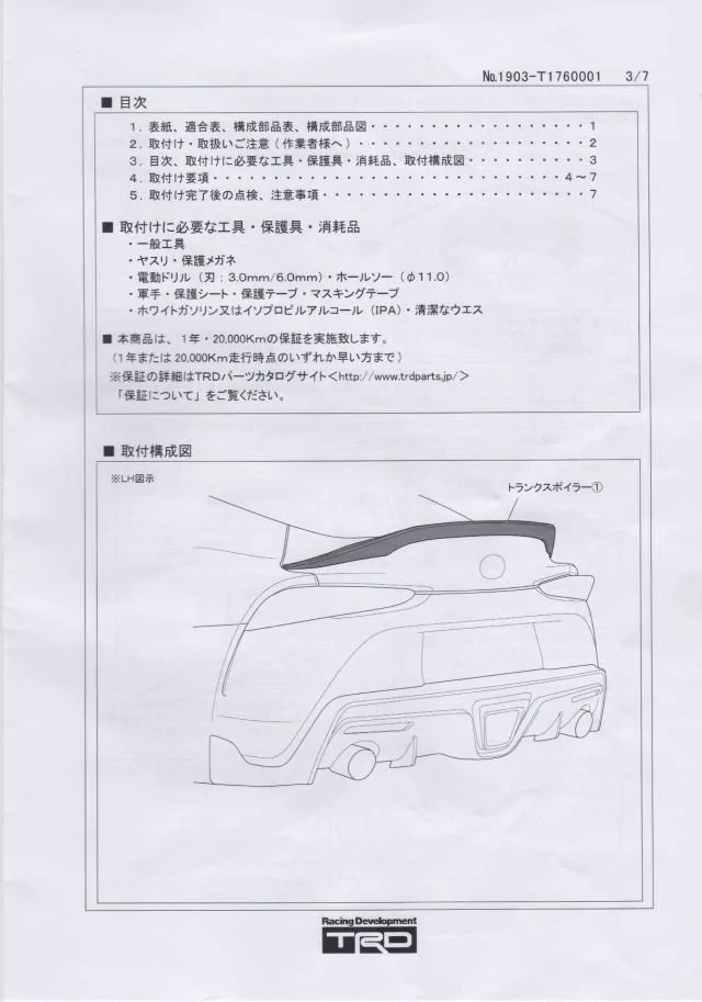

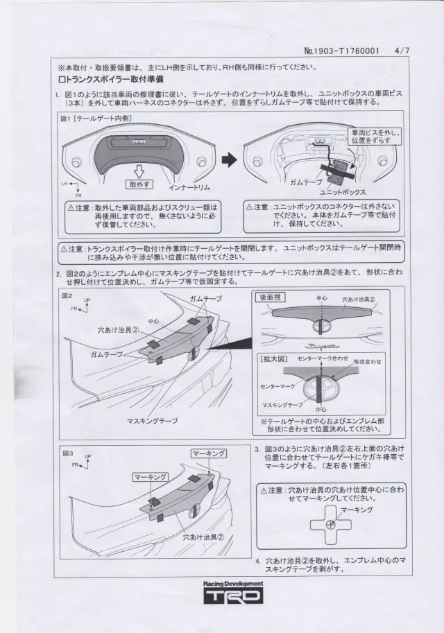

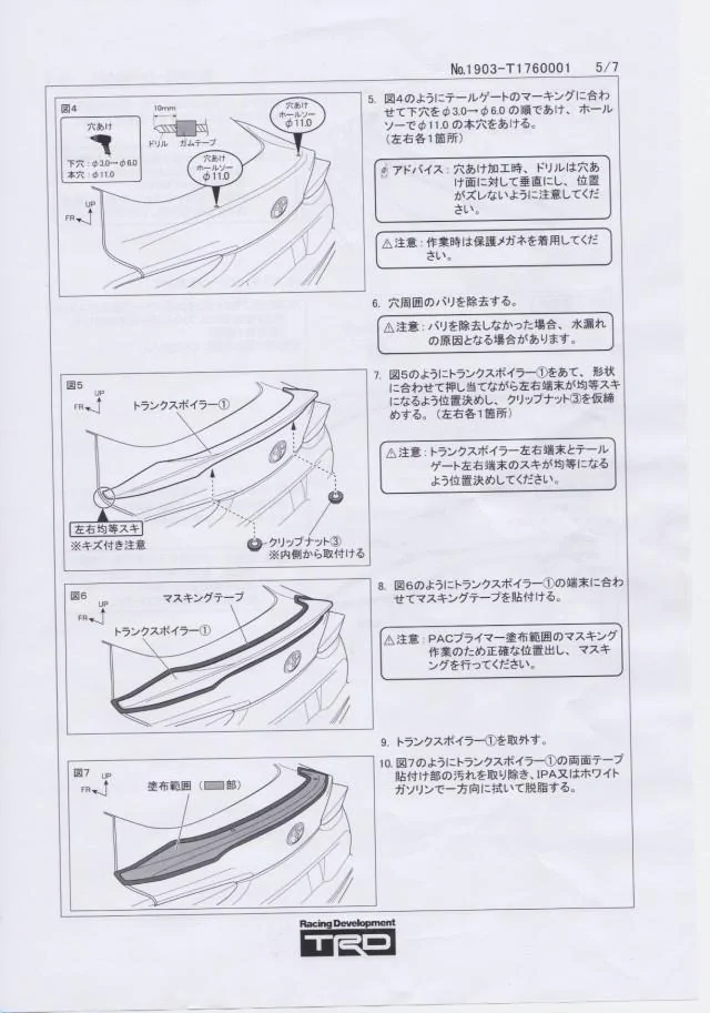

    TRD = $2,300, (dry CFRP) requires drilling, mounts with two bolts and wing nuts & 3M adhesive tape (grommets included for holes as well as weather and anti-corrosion sealant). PET plastic trunk template included for exact drilling spots. Epoxy is thicker and as smooth as glass, no orange peel, carbon weave is exceptional and perfect.

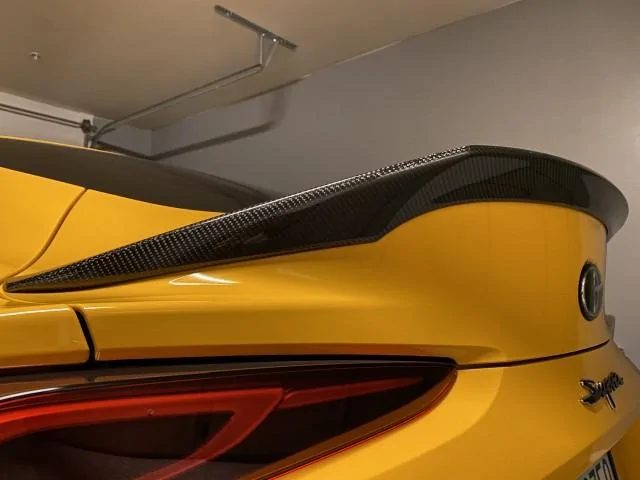

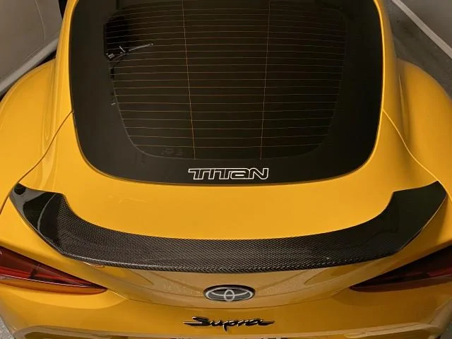

    Below are some photos of my TRD carbon duckbill installed on my Nitro Yellow MKV. I have also included the TRD manual in this post for those of you who are curious about installation prep. Despite it being printed in Japanese the diagrams are pretty insightful as is.

    Nice, looks great and thanks for uploading the instructions! I personally would prefer not to drill into the trunk though.

    Thanks. I understand but I think the diameter and distance of the holes can be used for other TRD aero coming like a GT wing as well.

    Thanks for sharing, I'm quite surprised the TRD one requires drilling...it might be a deal breaker to many ppl.

    True. I feel more comfortable knowing after I start making 600+whp that my spoiler won't end up in the highway a few miles back shattered after a nice pull.

    Great write up and photos. The quality of Rexpeed is great for the price but of course TRD will be superior in quality.

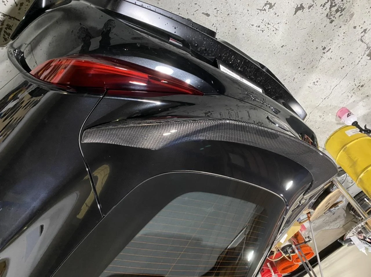

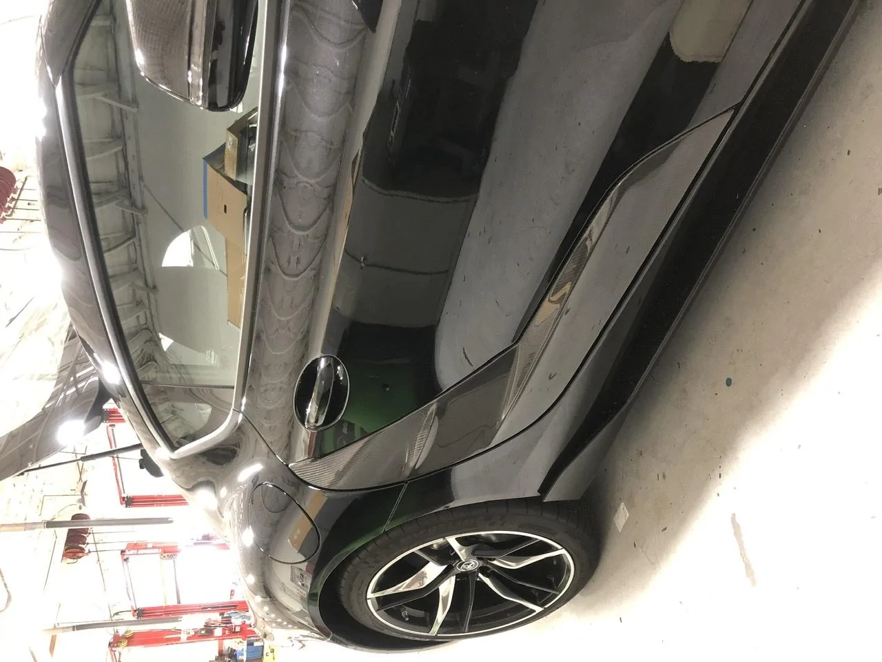

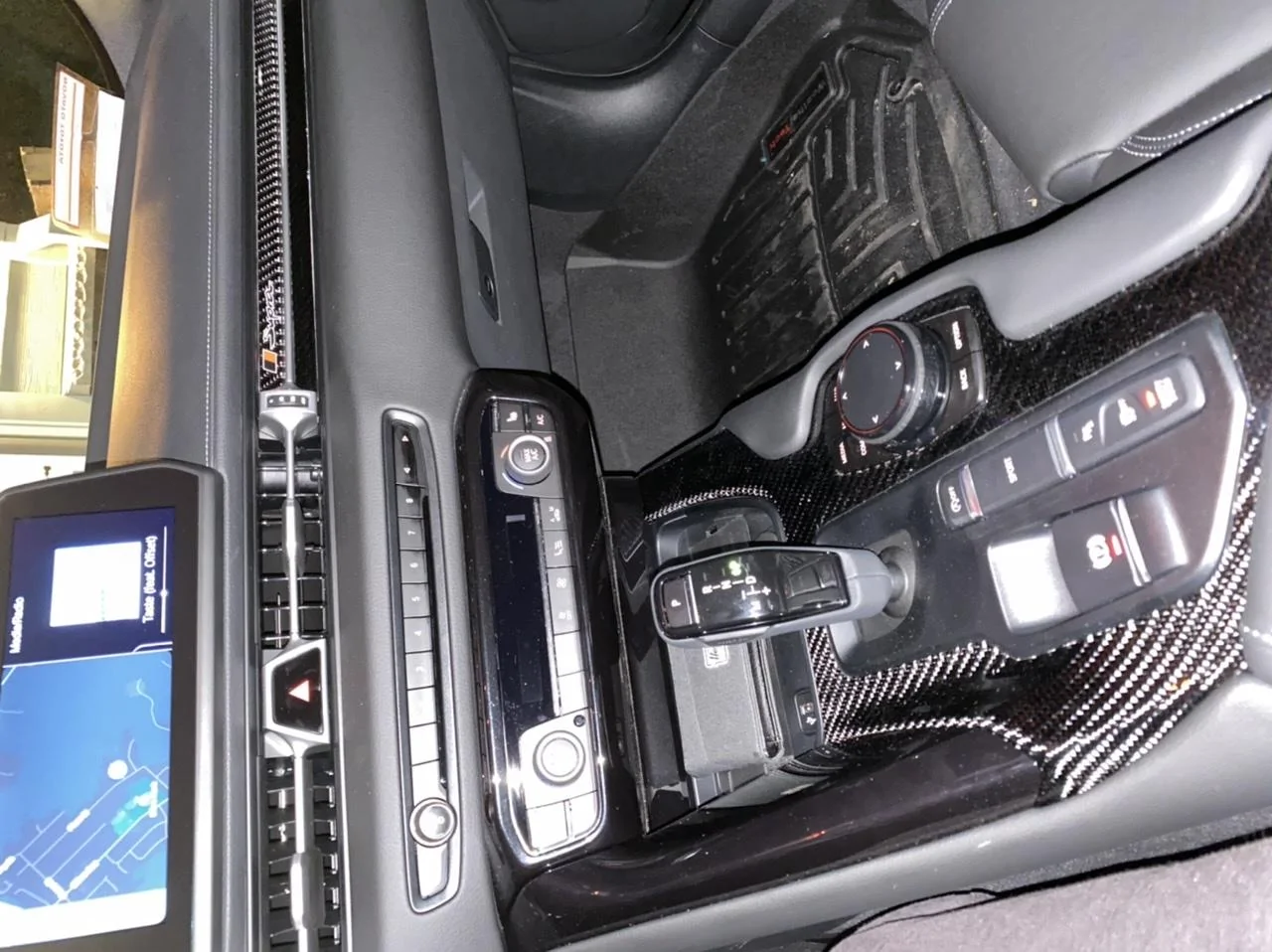

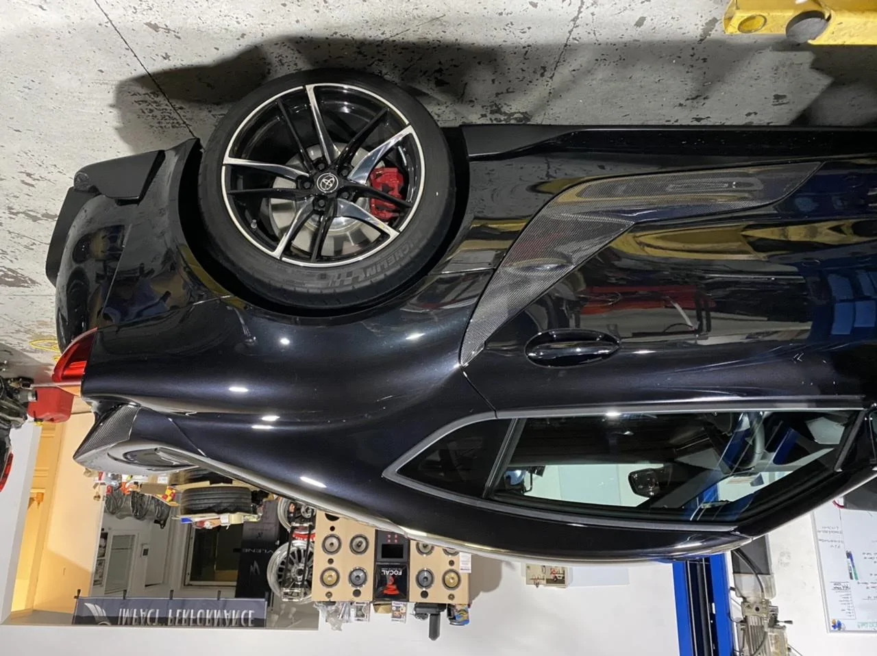

    Great post! I have the Rexpeed wing and the TRD Door Garnishes. Both in hand do have a quality difference but for the price it’s understandable. TRD will always have the one up on quality. for some who cannot get the parts easily or have the funds to do so have good alternatives in rexpeed and seibon.
    not sure why photos appear upside down when I upload, if they are my bad lol

    I like the TRD side garnish panels. They are around $3,850 for the pair.

    something I had my eye on for a while. Once I saw at SEMA that Seibon’s didn’t have the lines and little fin that the TRD one has I ordered the TRD.
    I actually got it for around $3400 shipped and insured to my door. 100% authentic TRD parts with all hardware and instructions.
