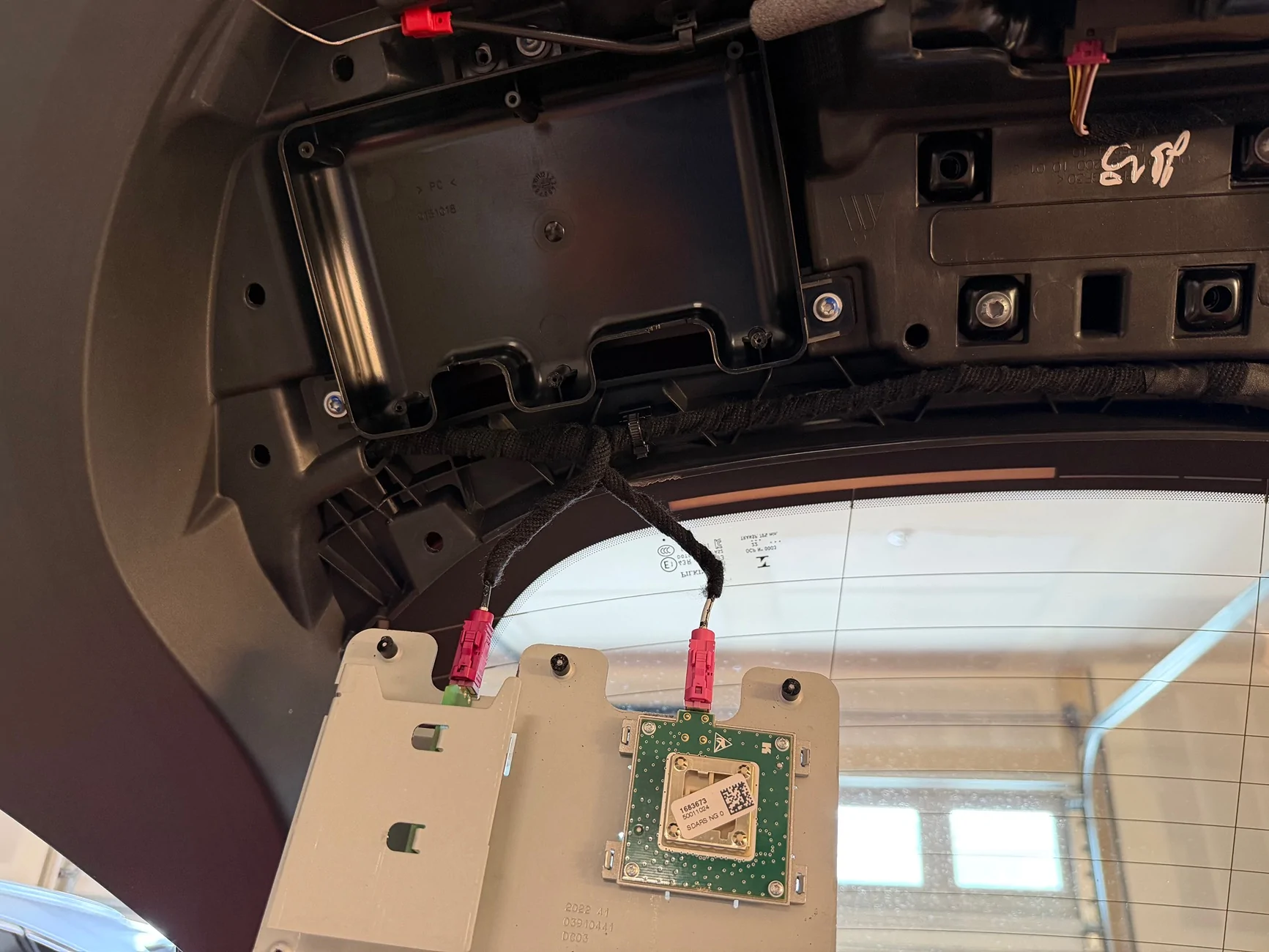

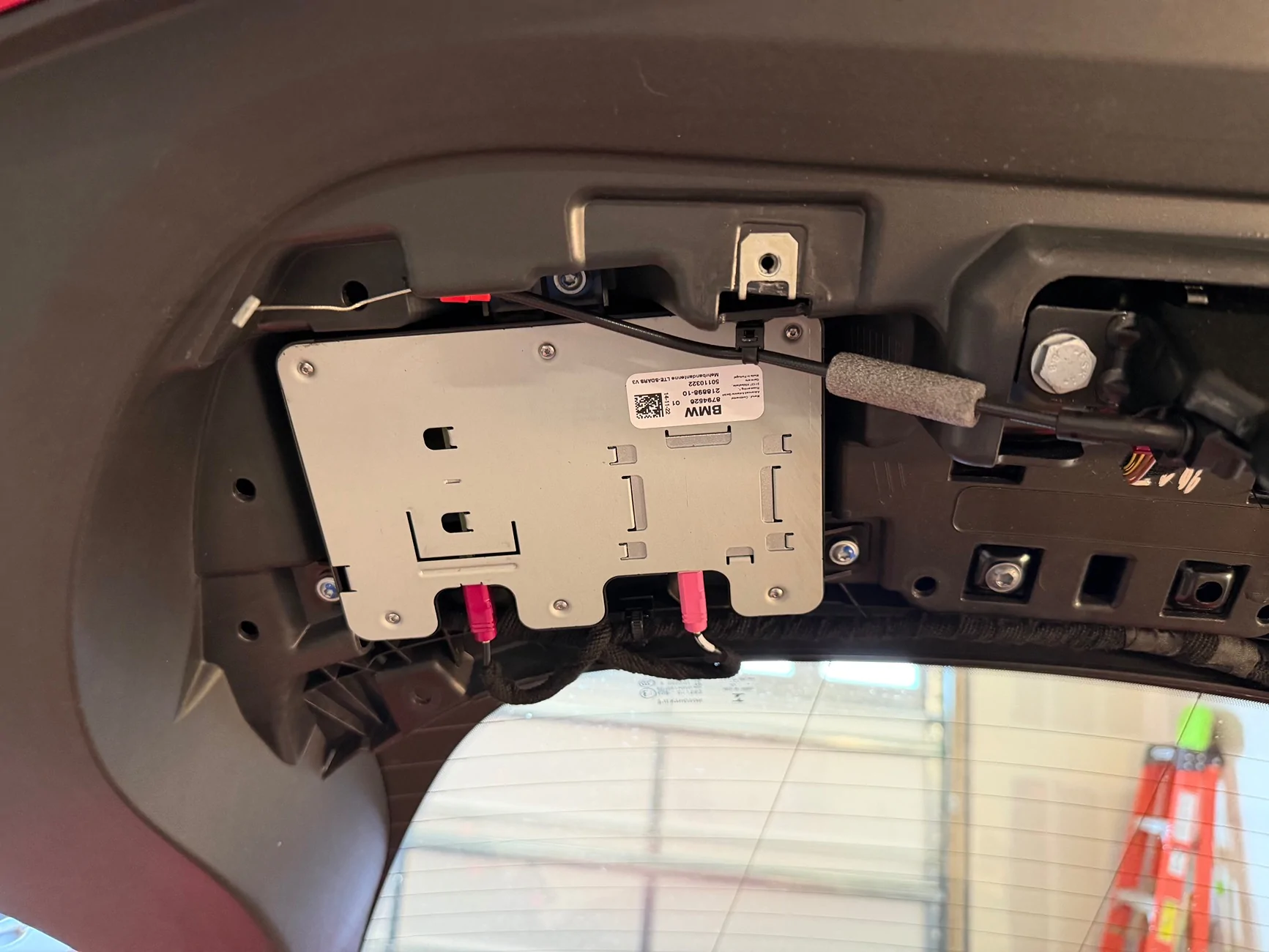

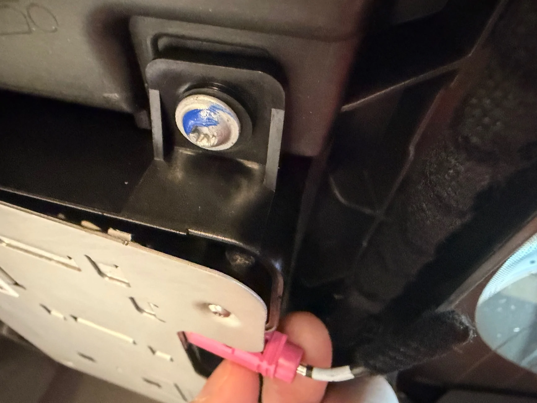

I’ve noted a worsen rattle going over bumps. Dropped the cover off the trunk and noted this module is loose due to 3 small broken screw stand offs. I’ve never messed with the trunk before so I know I haven’t caused this. If anyone else is having this issue might be a good idea to check one of these 2 boxes to see if they’re loose/broken.

Took out the broken standoffs and used some longer m2 screws from my laptop screw set to screw in to the remaining part of the standoff. Fixed for now.
