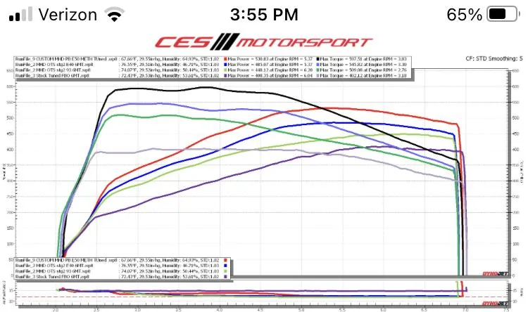

A bit of an update on my friend's tuned A91-MT (500WHP 610Ft-Lb). He got the chance to go to the drag strip this weekend and the clutch started to slip on the top end. The car is not on the grippiest tires either so with radials it might start slipping even sooner. For now it looks like 550Ft-lb might be a better target for the stock clutch until someone else is able to give more data.
Any suggestions on clutch upgrades or still too soon?

Still too soon, I’ve been trying to get updates and information on clutch kit upgrades through pure drivetrain solutions and other agencies. I’m 530whp and 597lbs torx
How’d your buddy do at the track? Do you know his numbers. 1/4, 60ft and trap speed?
