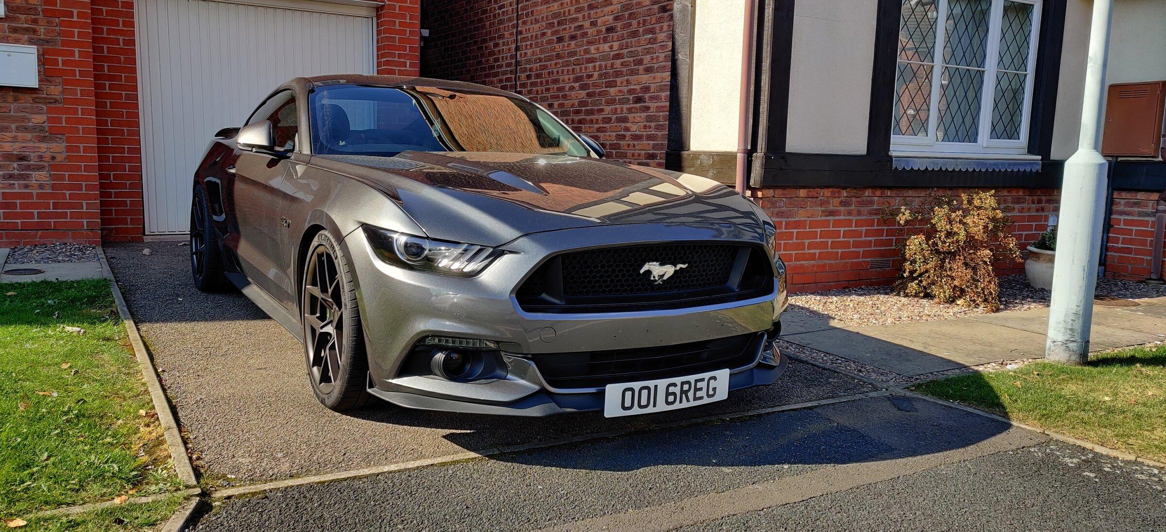

Hi all, I'm a new member just placed an order for my Supra.
I've currently got a Ford Mustang which they did put the ugly bracket on, however I installed a sto n sho plate with euro width rather than US size. I'm intending to swap over the sto n sho straight onto the supra, it attaches under the bumper so the drill holes will be invisible when removed, it also gives me a quick release if I want to completely remove the plate for a car show or washing etc...
Just an idea to those who are still looking, I'd advise buying this mustang version as it's more universal than vehicle specific but it has 4 holes on the plate for mounting or you can use a combination of 3M and screws.
The dealership have been great they have no issue with not installing the bracket and have said they've done it before.
