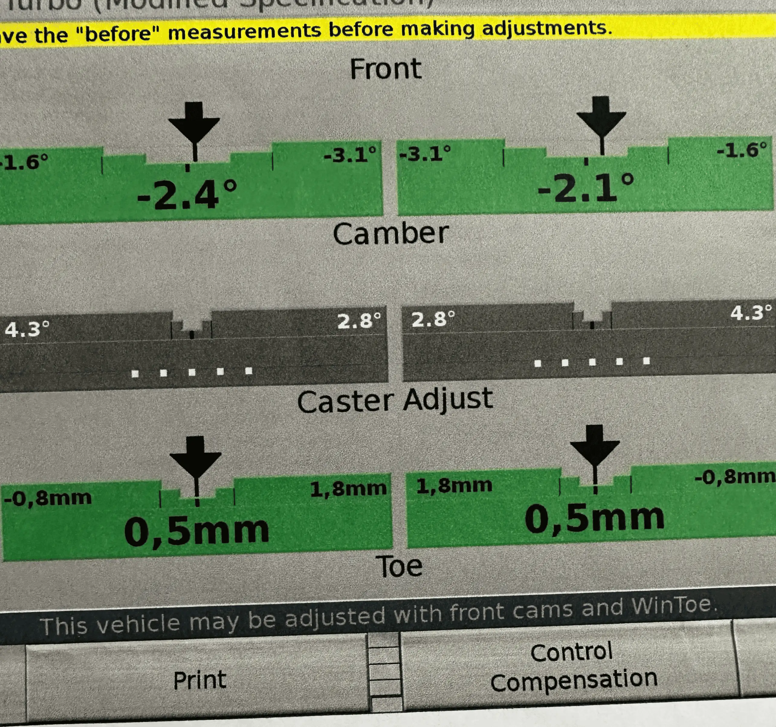

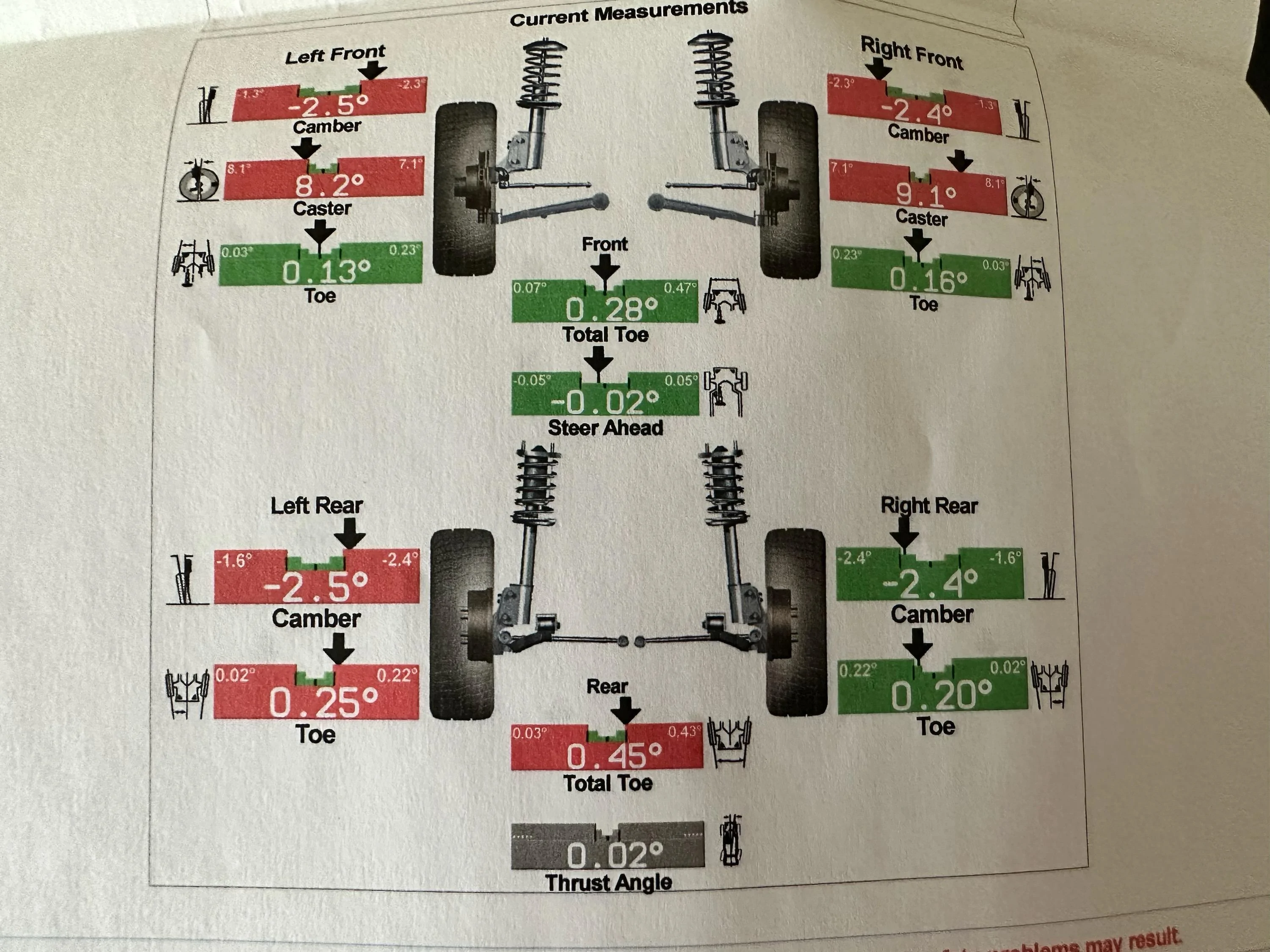

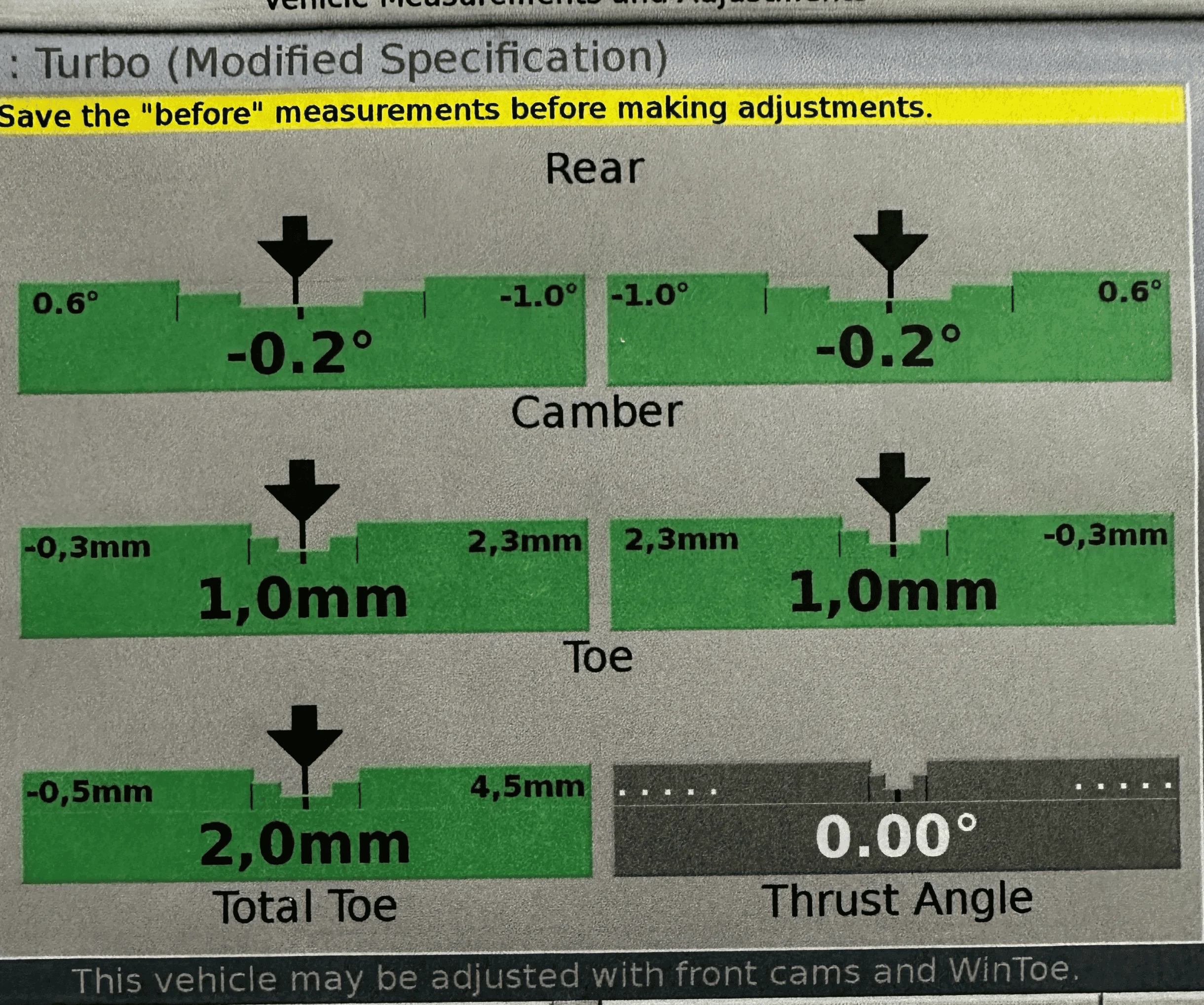

Def all about the alignment. I have done things on track with my current setup that would have had me spinning like a top when the car was stock. Like lifting off mid turn/power.
Also notice that you never hear about the whole "OMG SUPRA BUMP STEER ISSUES!!!!!" anymore.
more camber?
more camber?
I would get a spec alignment and only add more negative camber all the way around (like me) if you’re going to track (harder/more turning = greater contact patch with the road). If you’re interested in drag racing, definitely ask @zrk.
