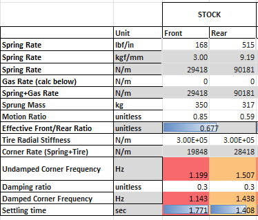

To calculate the GR Supra's factory suspension frequency, you'll need the motion ratio, corner weight, and spring rate.
Calculator:
http://farnorthracing.com/autocross_secrets16.html
Factory spring rates:
Front: 168 lbs/in; 3.0 kg/mm
Rear: 515 lbs/inch; 9.2 kg/mm
Motion ratio:
1 / lever ratio = motion ratio
Front: 1 / 1.18 = 0.85
Rear: 1 / 1.69 = 0.59
source: https://www.hks-power.co.jp/en/product_db/hipermax/db/31743
Corner sprung weight:
Corner weight - unsprung weight
Front: 395 kg - 45 kg = 350 kg
Rear: 367 kg - 50 kg = 317 kg
Note: the unsprung weight is an estimate. 45kg and 50kg are rule of thumb with the higher number on the drive axle.
This gives you a factory suspension of about:
Front: 1.2 Hz
Rear: 1.51 Hz
Note: The factory suspension utilizes the bump stops for additional spring rate. The rates above don't include that and is actually softer than the real rates.

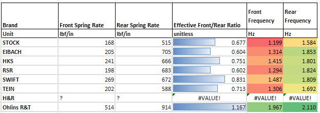

noogie
Jun 7, 2023
219
155
23 Supra
Copied spring rates from another post.
You can see most lowering springs have similar front to rear spring ratios. It's most likely due to the stock damper valving, which restricts your spring rate options. When you have a custom shock, you can valve your springs to whatever rates you want.
BRANDFRONT (LBS/IN)REAR (LBS/IN)FRONT (KG/MM)REAR (KG/MM)F/R Ratio
STOCK1685153.09.20.33
EIBACH2057053.712.60.29
HKS2416664.311.90.36
RSR1986833.512.20.29
SWIFT2696724.8120.4
TEIN2025883.610.50.34
H&R?????
Ohlins R&T5149149.116.30.56

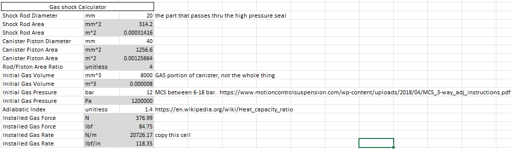

i3igpete
May 16, 2022
47
1,319
1,610
Chicago
2023 3.0L 8AT
Refactored with calculator for gas pressurized shocks, prefilled by eyeballing some MCS/JRZ dimensions on google. added damped frequency and settling time eq's as well.
to use: only need to fill in white cells in a given column. grey and color cells are calculated.
to do: get estimates for motion ratio on non-divorced rear setups
won't do: raw shock inputs
